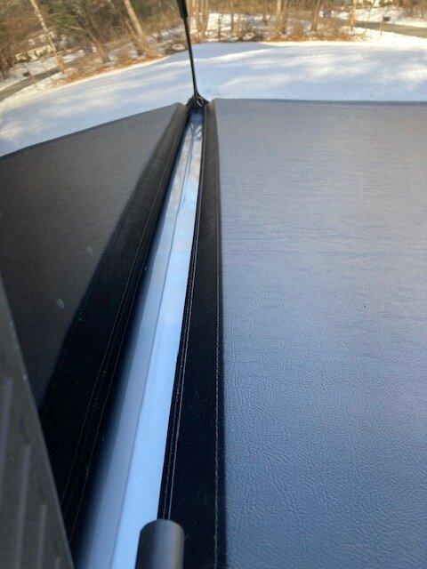

Ford Maverick Tonneau Cover Install - DIY Instructions IMG_0542

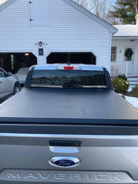

Ford Maverick Tonneau Cover Install - DIY Instructions IMG_0544

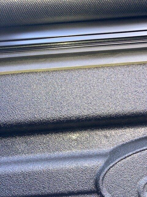

Ford Maverick Tonneau Cover Install - DIY Instructions IMG_0543

The roll gasket is intended to be placed on the bulkhead creating a seal between the bulkhead and the underside of the cover assembly. If you had placed it there and positioned the cover assembly gasket on it you would have a large gap at the tailgate. I pulled the assembled cover back (loose rail clamps) until the rear tailgate seal (rubber flap that hangs down/not much of a seal) made contact with the tailgate. The front cover assembly gasket will barely make contact with the bulkhead. I used the tacky roll gasket on the inside vertical surface of the bed pressed up against the cover header gasket. Tried to depict it in the pic provided. I found this to be the best compromise in fitting a cover that is 1" too short. There may be other roll cover brands that fit properly but everything I researched made reference to a 4'4" bed which actually measures 4"5". Hope this helps.

Actually the additional seal released from the vertical surface of the bed due to the texture of the spray in liner. I went back and tucked it in as best I could between the existing cover seal and the bulkhead. Just pressed it in with my fingers. I get a little water trickling down the bulkhead in a couple of spots but nothing significant. The best method to seal the bed would be to loosen the clamps if you already installed the cover, place the optional rolled seal on the top of the bulkhead with half overlapping the edge and then compressing it when you clamp down the cover. I may do that when the weather warms up here in NH but for now I get very little water running into the bed. If it stays that way I probably won't bother. Hope this helps. I see you have the hybrid. Have 2,000 miles on mine and averaging 44.8 mpg. The 50 mi round trip to my daughter's home consistently gets mid 50s mpg. Over the first 800+ plus miles I verified against the pump and the displayed figure was spot on. None of the issues others have reported on this site so far.
