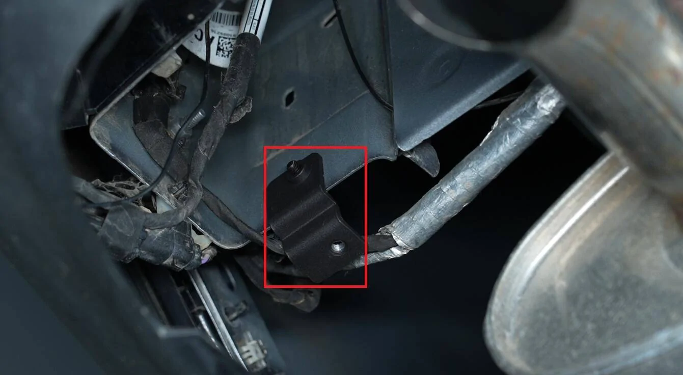

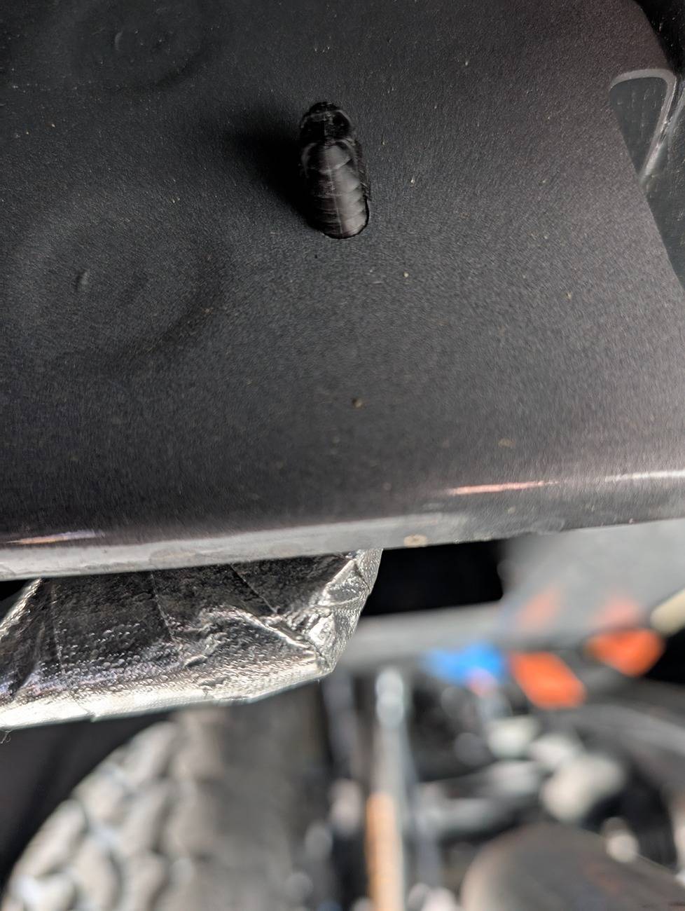

I hope you can see the difference. The upper photo is from another post and there is only about an inch from bolt to bend. On the lower photo you can see on my truck it is more like 2 inches.

Make sure you're on the right panel - your pic looks like the panel that's up and to the right of the panel where the bracket goes (in the first pic). Looking at those round depressions next to the push fitting that holds the wiring harness it looks like you're trying to put it in the wrong place.
Will double check. Thank you.
Yep - I was looking at the wrong panel too when I installed it and about to thread bolt, because was almost under the one I needed, had to scooch back up for view point to match the instructions.
Which actually matched just fine in what to do - leaving things loose was main improvement, until the end.
Even the bracket left loose until I was sure where it went, just enough bolt friction to require me to move it with some force, then dropped the panel and kept bracket in place as torqued down.
Pretty sure this is the post I followed. And a couple after about 85 ft lb on the frame bolt.
