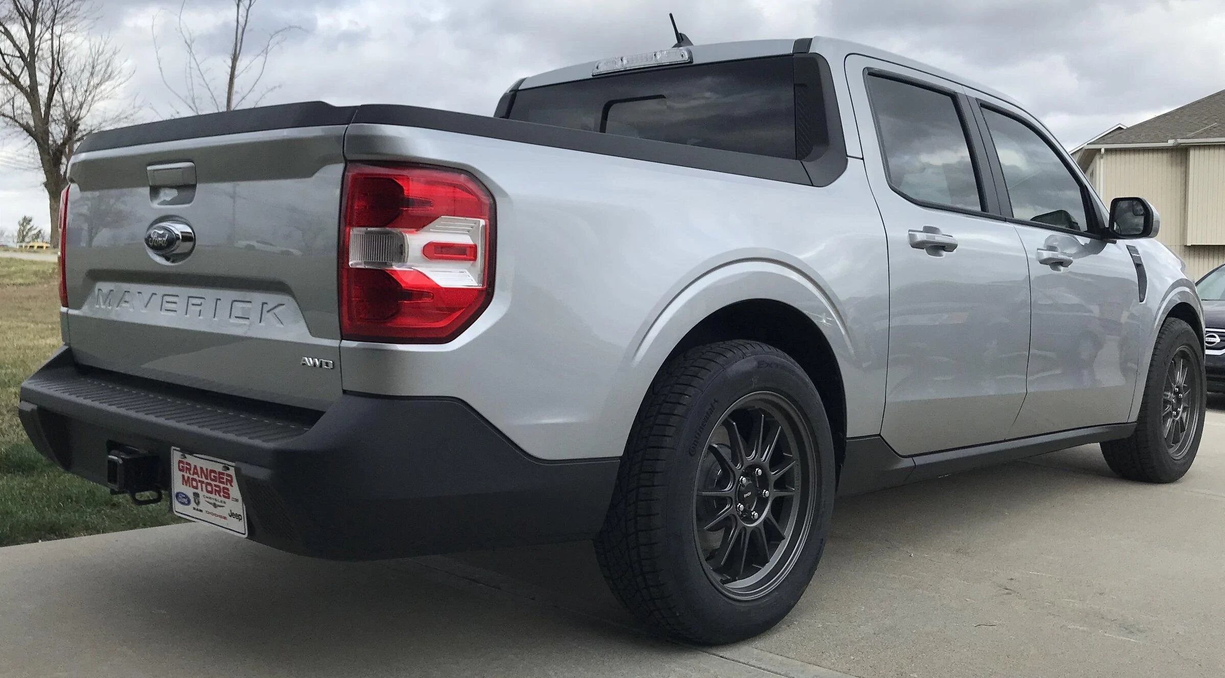

No plans for AWD lowering? That's a shame. I must be the only one who wants to lower my AWD :(
I'm interested in lowering my awd once it comes in. 2 in front 3 in back.
We will see if demand changes, from the polls and mix they are producing it makes sense right now. Good news is it would just require rear springs
Why does yours look lowered?
