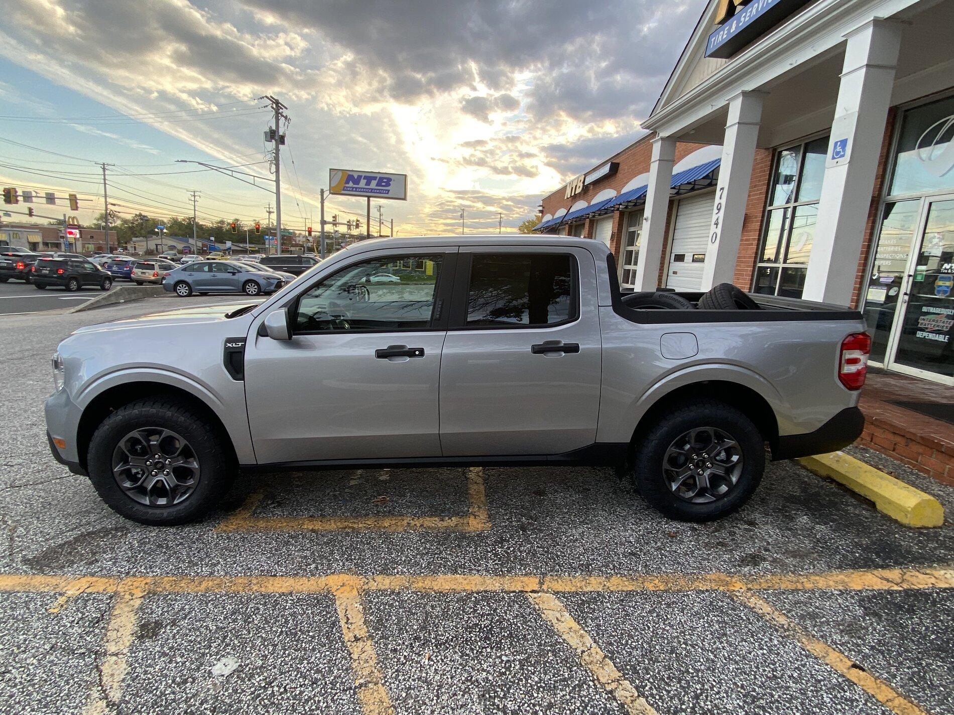

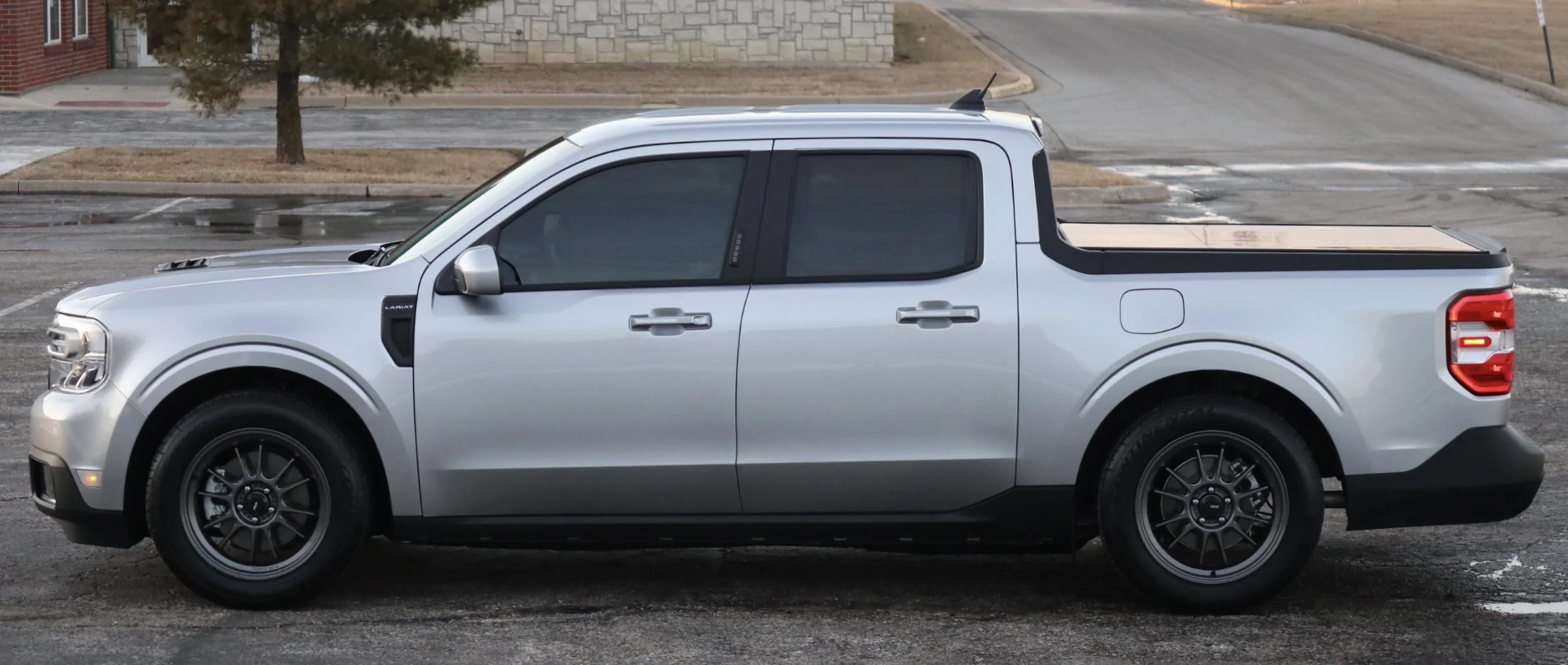

Heres 2 pix of AWD mavericks i pulled from the net. One is stock height one has a 2" drop. I prefer the one with the 2" drop.
Ford Maverick Lowering springs for Maverick IMG_5696
Ford Maverick Lowering springs for Maverick 4A804BCA-1B7E-4BCE-92BE-AD06E4D238AF.jpe
FakeCowboy
Jan 6, 2022
958
2,046
Mid Atlantic
2016 Subaru WRX
In your opinion it would. Not mine. I intend to drop my AWD as soon as a kit is available. I want the AWD convienence in winter, but do not need a lifted vehicle, and would prefer to ditch that unsightly opening. Plenty of other AWD vehicles that are not lifted. Nissan Skyline , and Subaru WRX come to mind.
I think this looks great, fits in with the mini-truck theme. To me the unibody "truck" looks silly lifted up, especially with the rear wheel being so far forward in the wheel well due to the trailing arm limitations.
