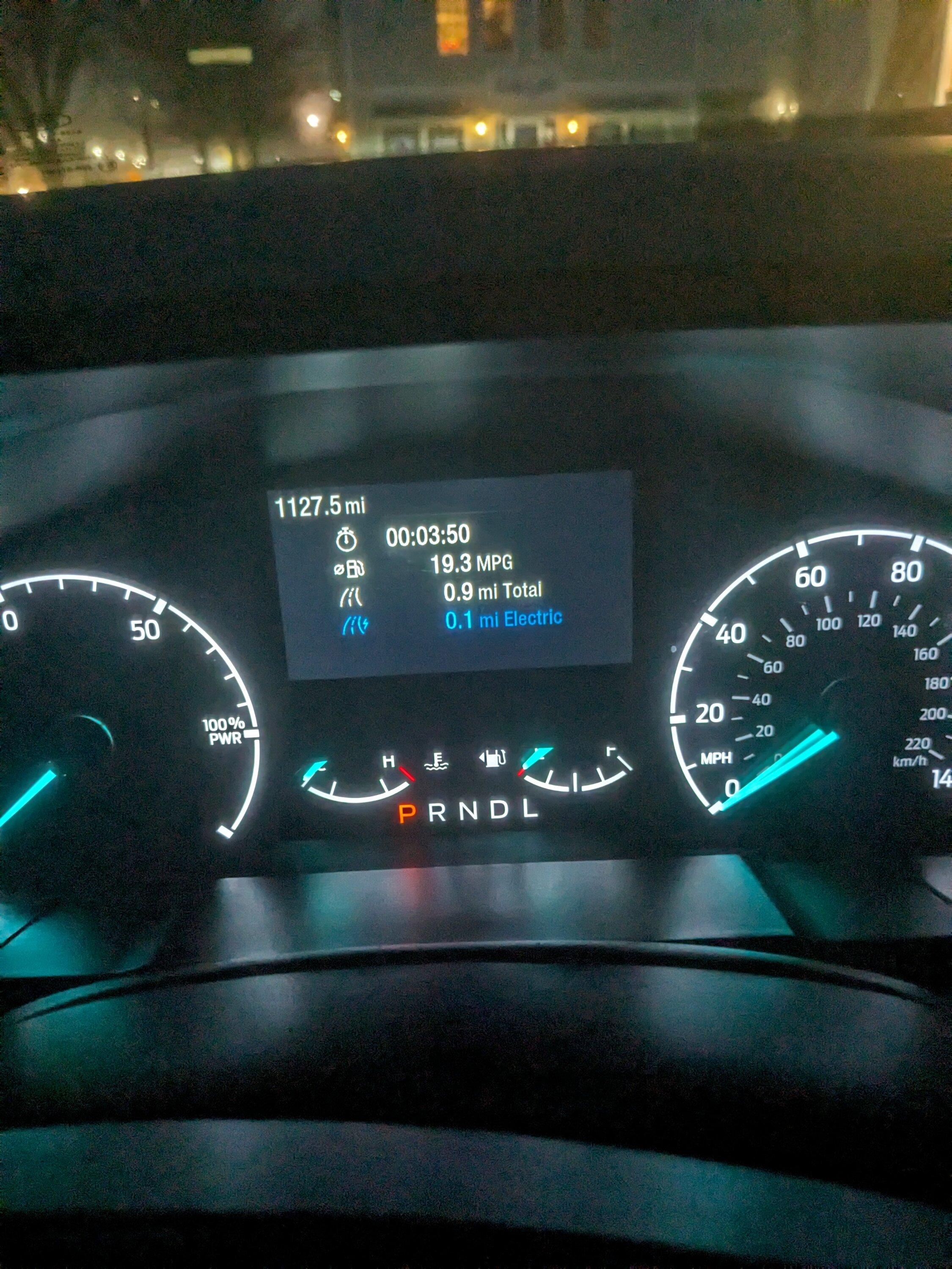

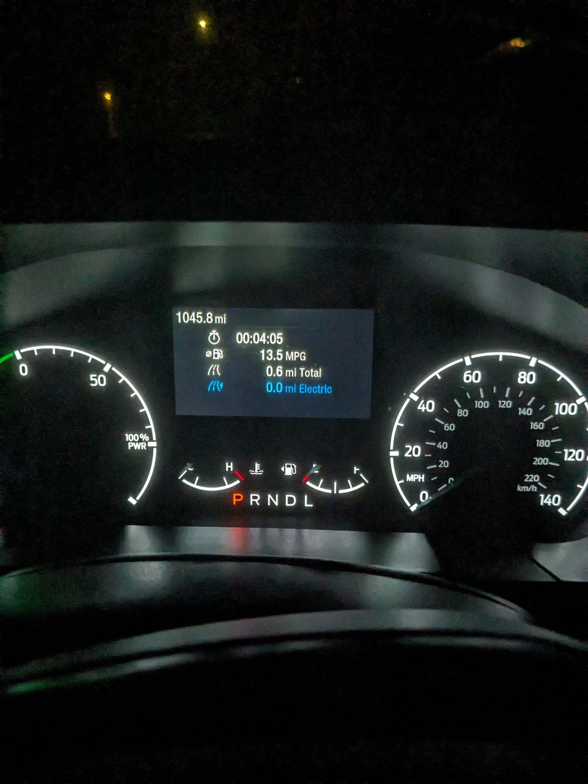

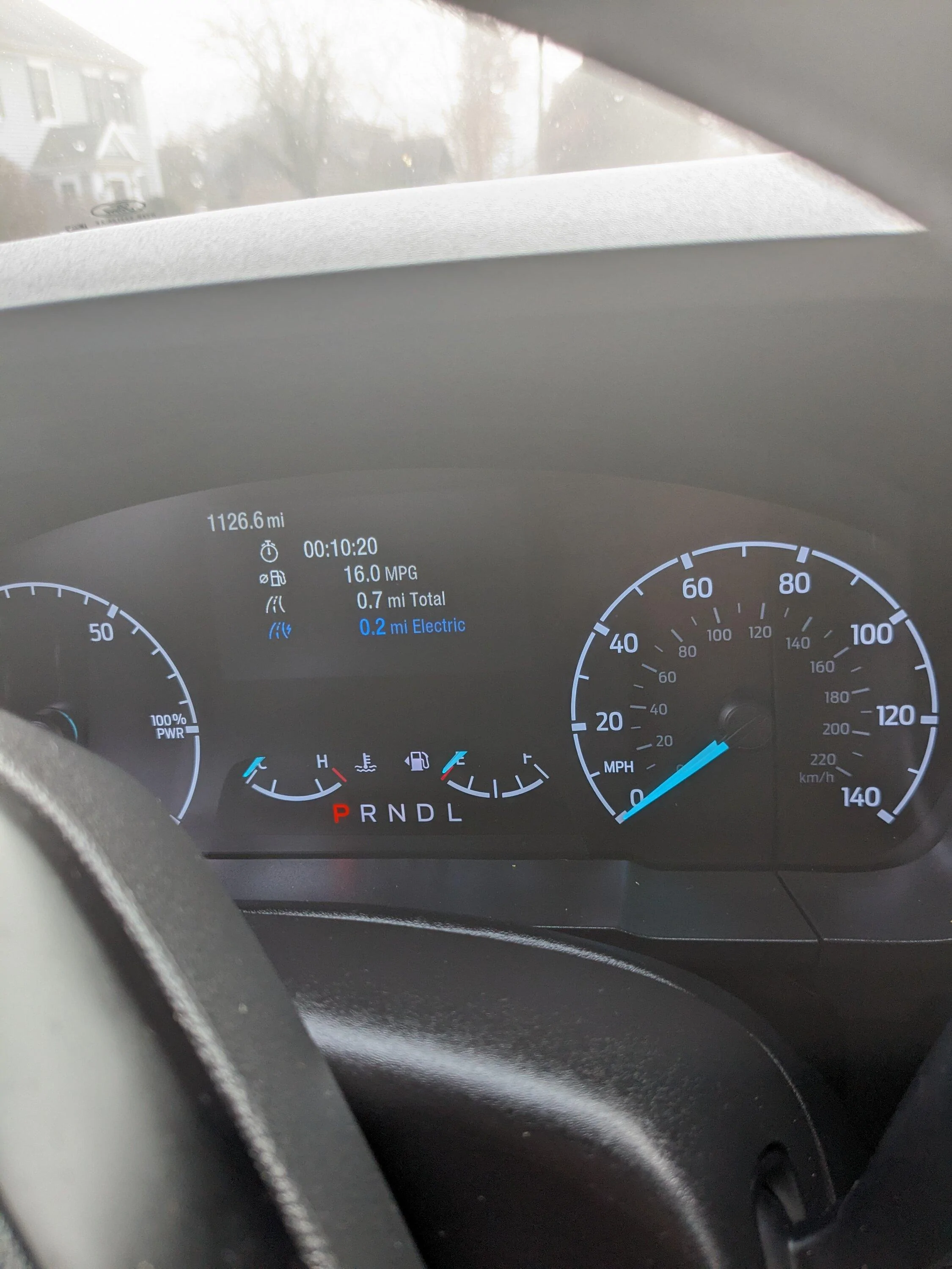

When I drove the Maverick home from the dealership I was getting almost 50 mpg. Now, 1,100 miles on the odometer and I'm getting 13-19 mpg around town. I am not a lead foot and I don't speed. I keep it in eco mode most of the time unless I forget. I drove mostly on the highway and I'm averaging 32mpg there. My overall mpg is 30mpg now and I'm thinking there's a problem with my truck.

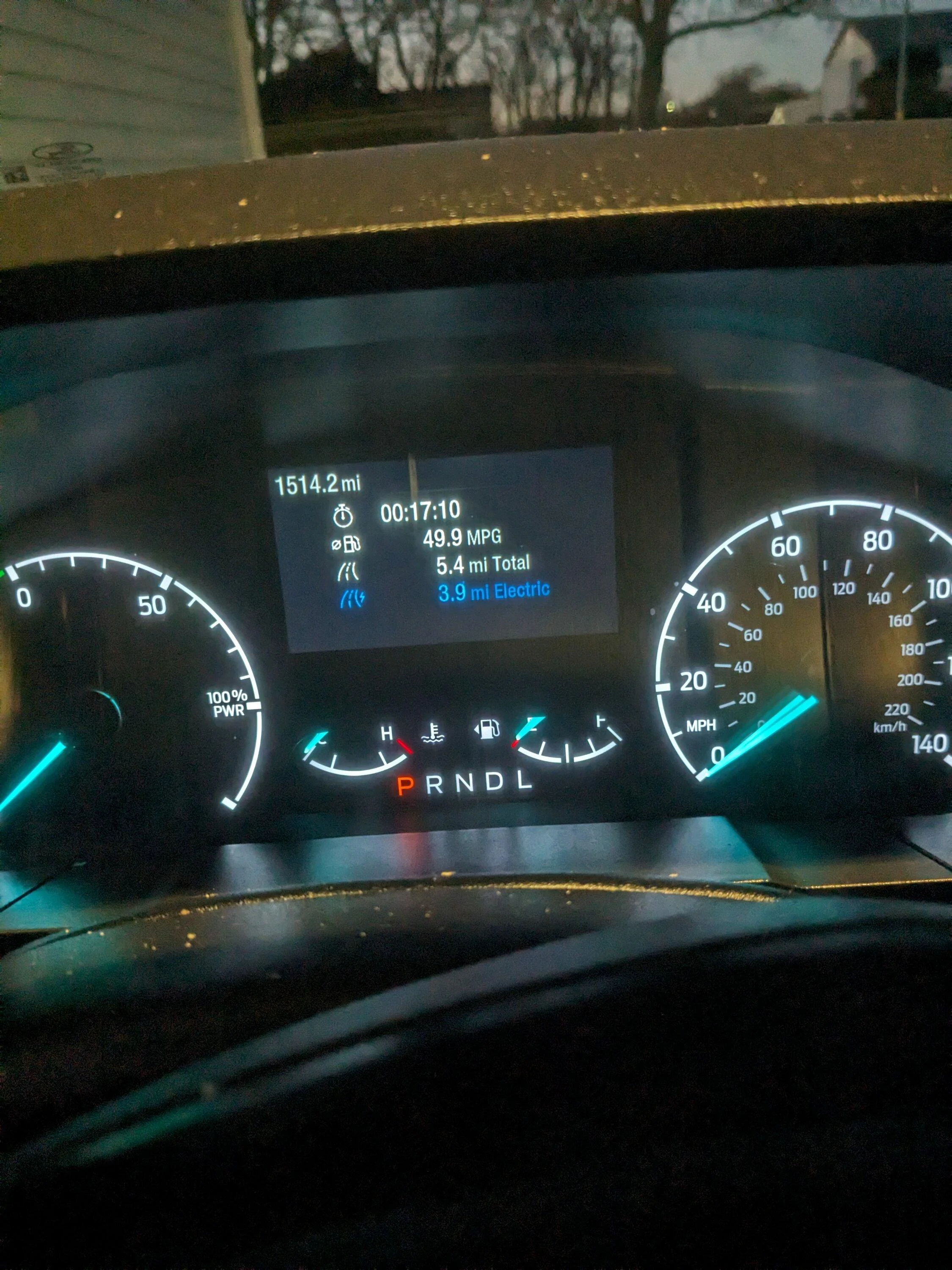

Last picture is my new mpg with the setting turned off. Incredible how much of a difference it makes! Can't wait to see what I get on the highway now.

You are right. They are all short trips just to and from my job. The only other driving I do is highway driving where I average about 32mpg.
I was not aware that the average mpg the truck says each trip was inaccurate, or only accurate on longer trips. I'm not sure I understand why. I was under the impression that shorter trips around town would equal higher mpgs. Are you suggesting that my actual mpg is higher than the truck says?

It is short trips that are the issue.
There is nothing wrong with your truck or your settings.
If you burn two thimble fulls of gasoline on a short trip and it is off by one thimble that is 50% mathematical error.
If you burn 10 gallons on a long trip the computer may still be off by one thimble of gasoline. One thimble error out of 10 gallons is 0.0005% error.
It really can be that simple.
But add to that if you start with a high battery charge and end with a low battery charge your numbers will be artificially inflated.
Start with an empty battery and end with a full battery, and your numbers will be artificially deflated.
Trips in stop & go traffic and with lots of traffic lights, equal higher Hybrid mileage.
But, short trips where the truck never warms up completely, will typically yield worse mileage.
Consider the mileage calculation on the truck as an optimistic estimate. For accurate mileage, calculate it yourself at fillup.

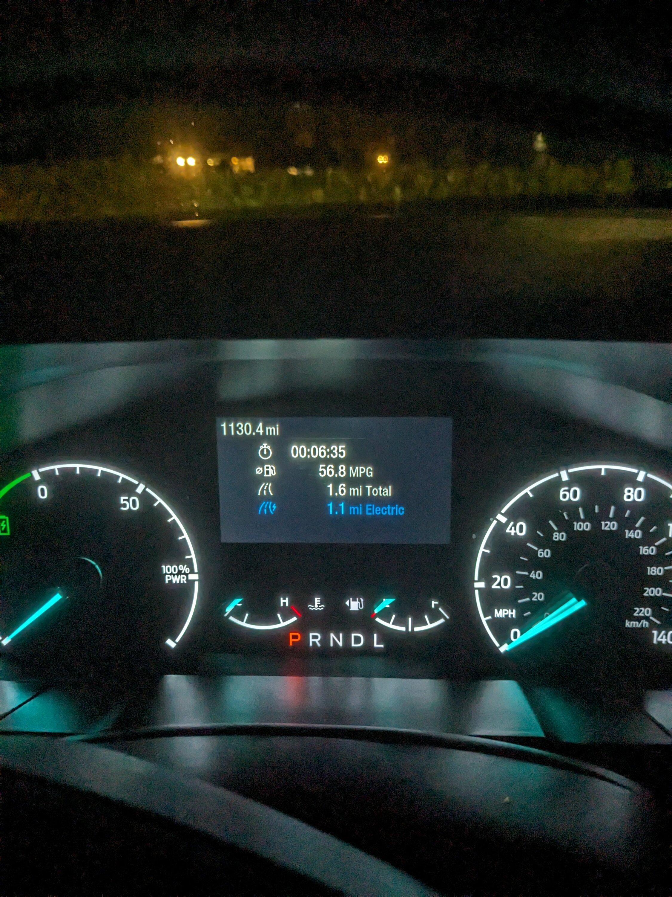

You were driving less than 1 mile and taking those results as your mpg.
If you get in the truck and the hybrid battery happens to be low it may take a mile or 2 for the battery to charge to even be able to go into EV mode
Yeah, I've even seen the opposite happen. Drive less than a mile and get 999.9 MPG because you can't divide by 0.

I have been noticing that as long as the trip is over 2 miles the MPGs on the dash go way up. I am consistently getting 45-50mpg on 10-15+ minute trips around town.
I checked my tire pressure and the dealership (or someone) had them all over 43+PSI. They are supposed to be 35 PSI, so I let the air out of them and I'm getting 2mpg more now, most noticable on the highway. Where I was averaging 32 mpg on 40+ mile highway trips I'm now seeing 35-36 mpg. I also filled up at Mobil instead of the usual cheapo gas station I use. Maybe that helped too.
In any case, I cancelled my service appointment because I am very happy with the MPG I am now getting.
