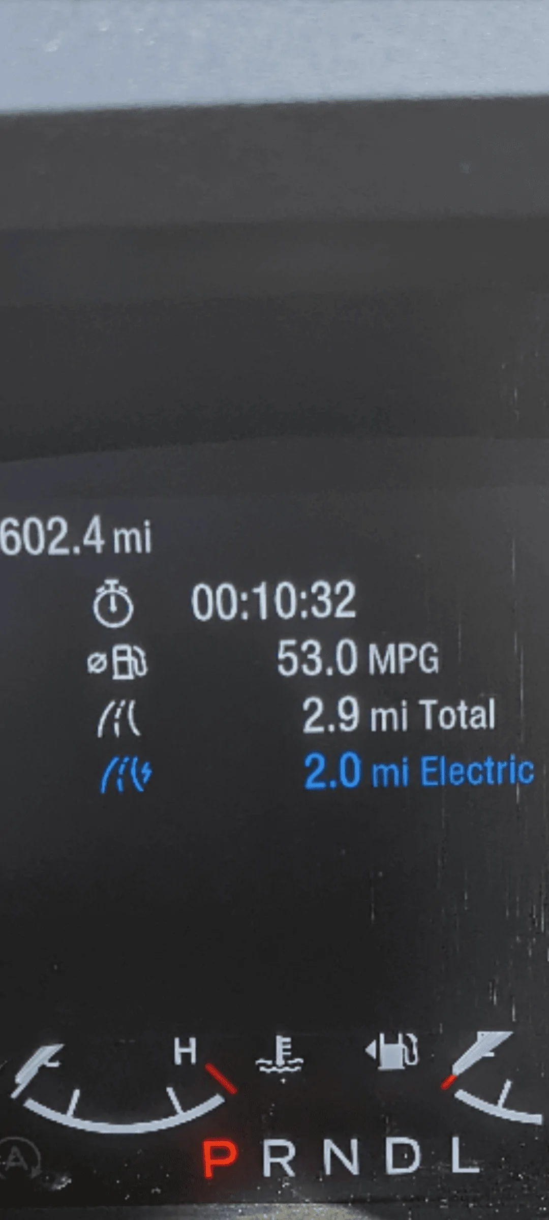

Sorry for the confusing post - the setting was just a coincidence and had nothing to do with my MPGs. I was getting inaccurate readings when I drove short trips. I was only taking the truck around the corner and back for work, so I thought it was broken or something reading 13-18 MPG after each short trip. In reality I am consistently getting around 50 mpg around town now that my job is further away! Also changing my tire pressure to 35 as recommended may have helped too. And I absolutely love my hybrid XL.

Just read a post here about driving in slippery mode to get higher MPGs and run off the electric motor more, so I figured I'd try it on my way to work.. I was surprised how much longer it stayed in electric motor! I got the highest MPGs I've ever gotten, with a bed full of tool boxes and saw horses and the cab carrying all my tools! This is amazing.

Maybe I'm missing something, but a drive of less than a mile under most conditions will kick on the gas engine, and the engine will run until it reaches operating temperature. You're not going to see Hybrid like mileage on a super short trip like that, unless you manage to stay in all electric mode.
Add to that the engine fires up immediately if it's much under ~40 degrees, and stays running until warmed up. You need around 3 miles, more in cold weather, to see 40+ mpg.

Just read a post here about driving in slippery mode to get higher MPGs and run off the electric motor more...
Usually, slippery mode + letting the EV Coach teach you how to stay in Electric mode will yield the best mileage you can get on a trip, short or long.
Very short trips with a COLD engine will yield poor MPG. Very short trips if the engine is still warm (or in warm weather) will yield significantly better mileage.
