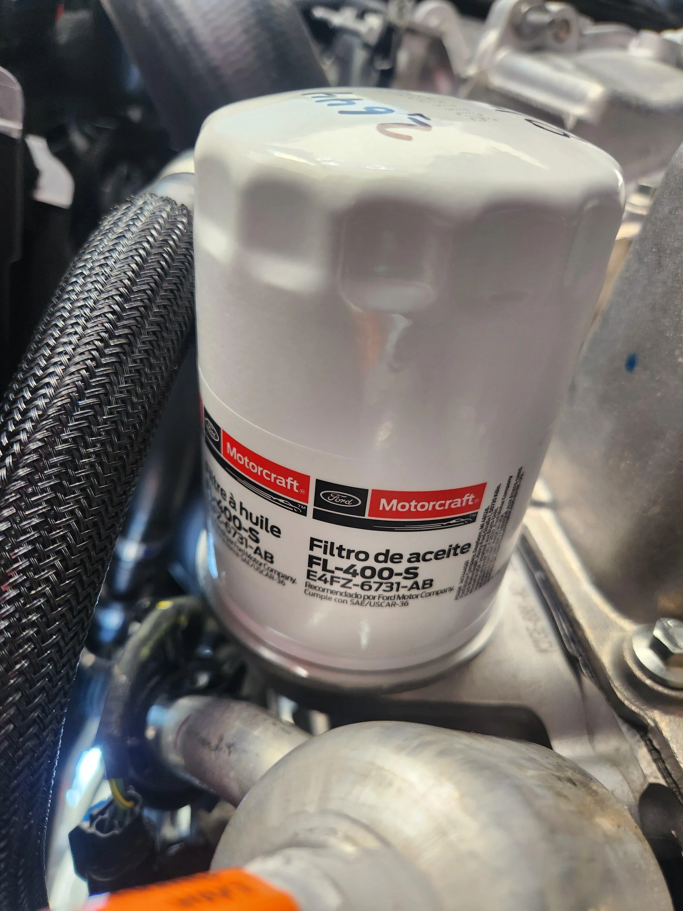

Fl-910S is the recommended size. bypass set at 14.5 psi, FL-400S is bigger and would have more filtering area. Bypass set at 20 psi.
I would recommend using the Recommended FL-910s. And over filling is worse that being under by 1/2 QT.
This
