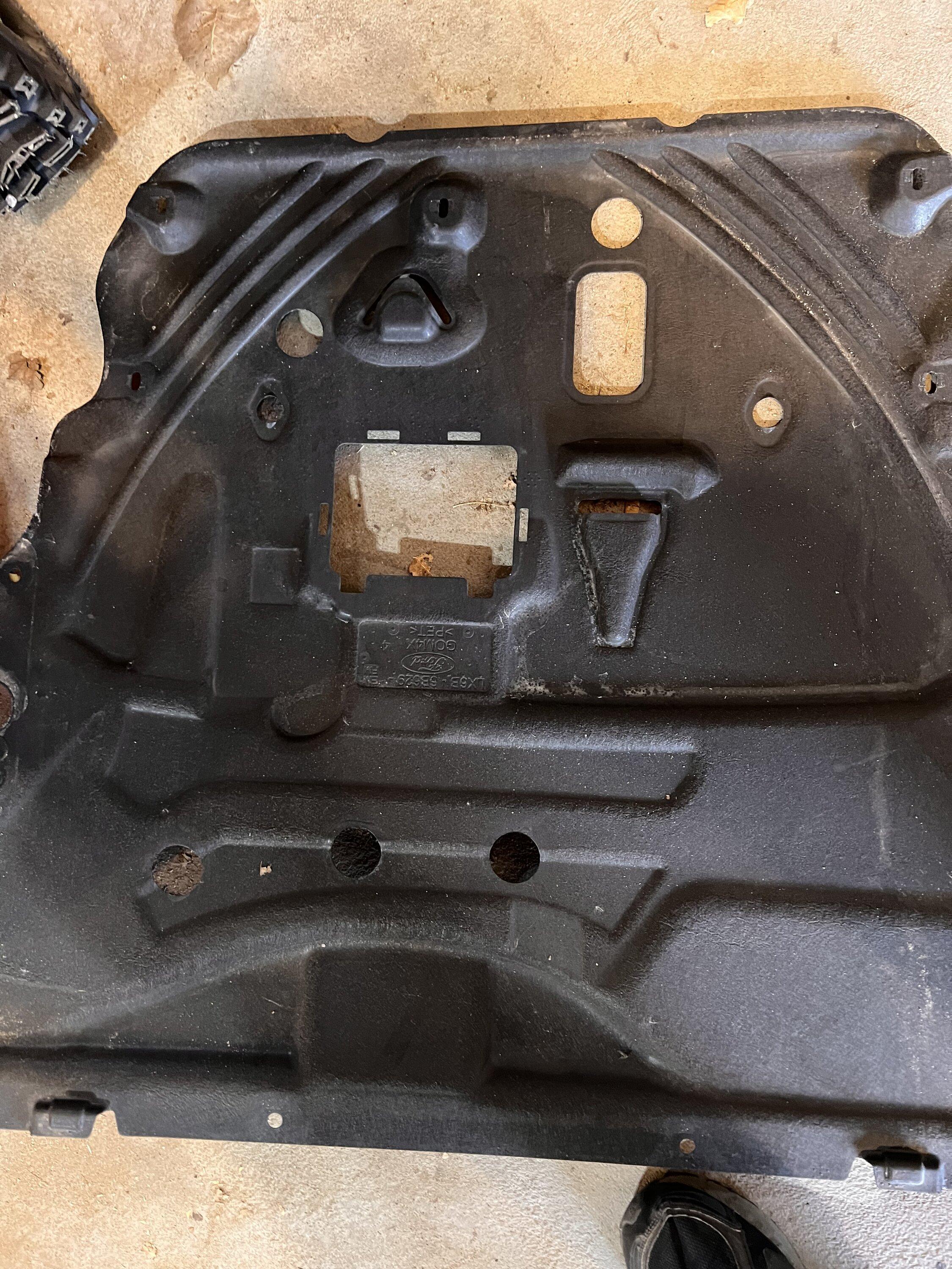

First hybrid oil change, does this shield look right??

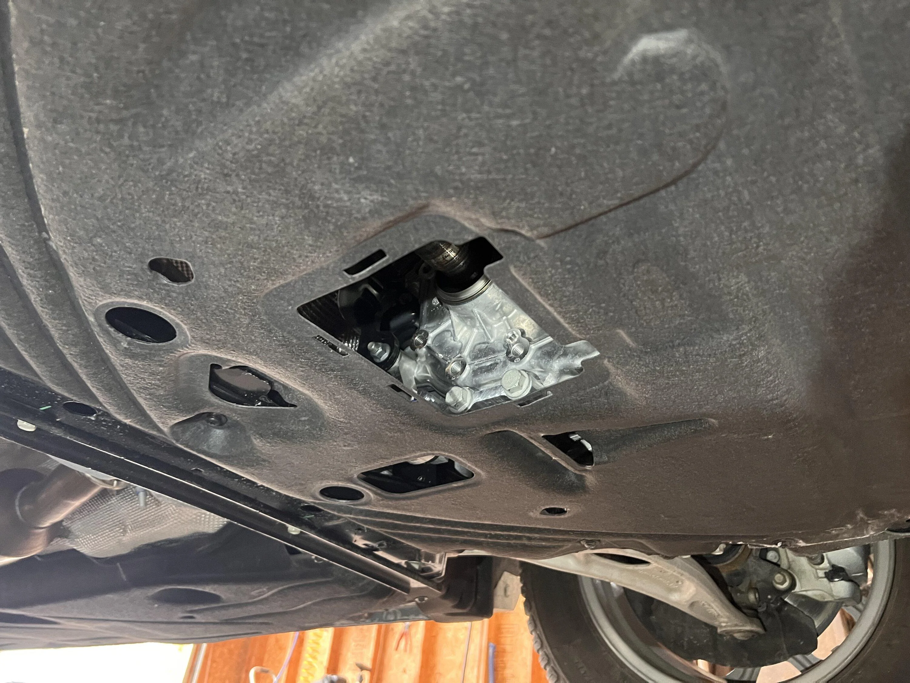

OP, what’s the build date on your truck? My Feb 2022 Hybrid does not have that (missing) panel.
On mine the outlines for such a cutout were embossed approximately there and as part of the fire mitigation recall is one of the areas removed. On Hybrids produced after the recall it appears they're just using a modified version of the EcoBoost panel which, as mentioned, has that cutout as part of a PTU cooling system.
