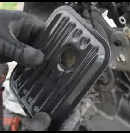

Here is a pic of the transmission fluid filter in the hybrid. It is bolted to the fluid pump inside the eCVT. Can’t replace without eCVT removal & disassembly. Meant to outlast the eCVT. With old dirty fluid, however, it may wear out a few weeks before the eCVT croaks:)
Ford Maverick Better performance after transmission oil change ? IMG_1211
Edit - picture from this YouTube tear down video:
