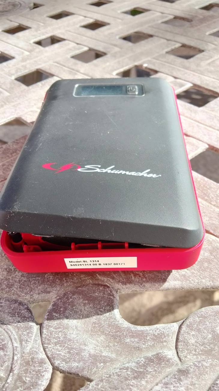

Maybe not. Be very careful
This is my second Schumacher charger.
This one is a replacement for my first one which did the same identical thing. Schumacher is supposed to be a reputable brand.
I kept it stored under the rear seat.
Never used it except for the flashlight and to charge a phone.

Damn I have has 2 of them no issues like that! The risk may be greater than what I thought.
