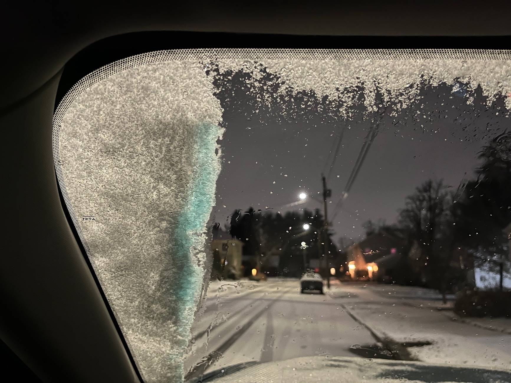

I recently had my windshield replaced, and during a snowstorm, I noticed that the area near the left A-pillar isn't being properly cleaned. There's a thick strip that the wiper misses, which obstructs visibility. This may have been an issue (by design?) since I first bought the truck, but it's not ideal.

Looks like they either didn't put the wiper back correctly when the windshield was replaced or that heavy wet stuff on it is preventing it from travelling further. I'd bet on the first one.

The snow was very soft, it did not prevent the movement of the wiper arm.
So they may have a install the windshield wiper incorrectly
If any owner can post the leftmost position of their wiper I would appreciate.

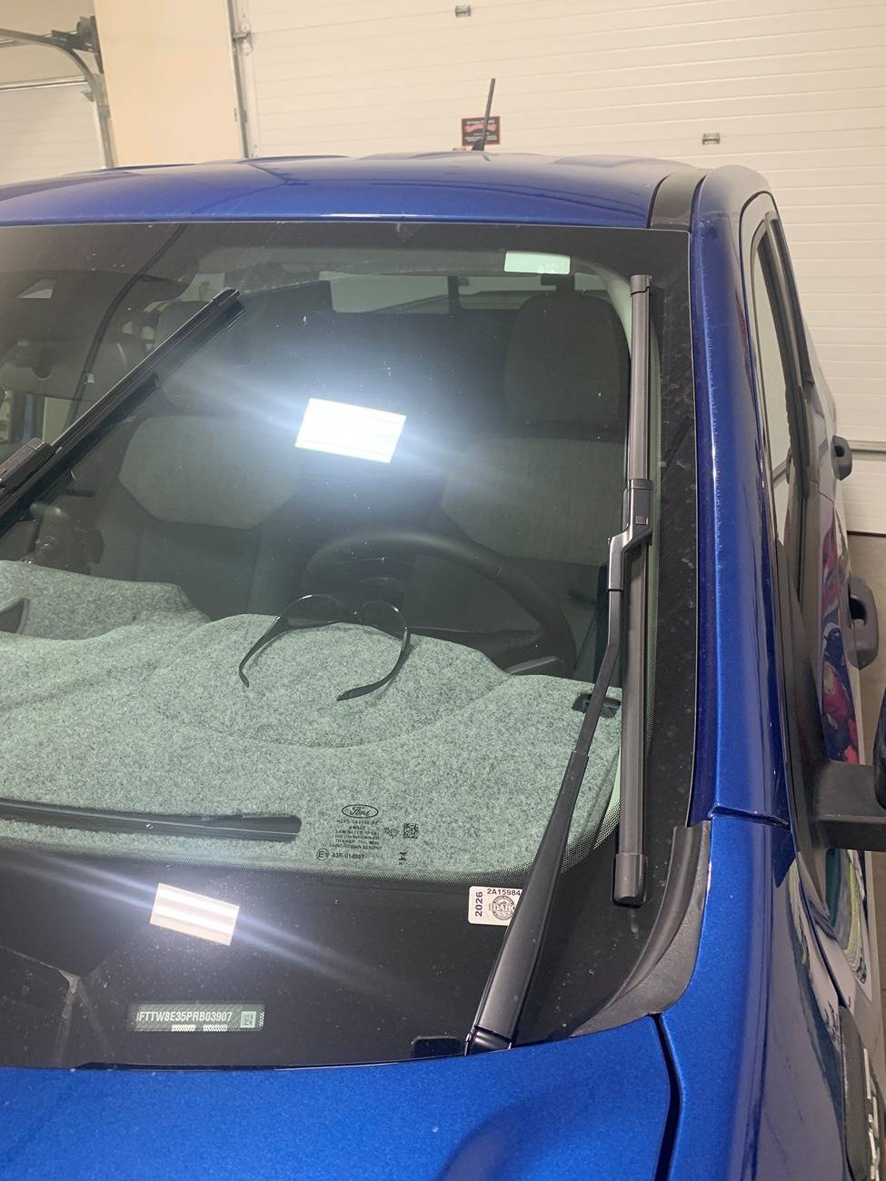

Here you go! Looks like you may be off a spline or two. Maybe try removing driver side wiper, then position passenger side up manually. Reconnect driver side in proper position on spline. Might work.
Ford Maverick Left Windshield wiper limited cleaning range Wiper
Ford Maverick Left Windshield wiper limited cleaning range Wiper2

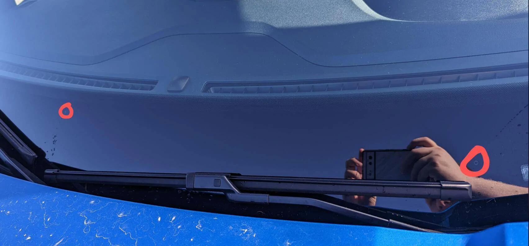

There are small circular marks on the Ford windshield (hopefully your replacement windshield also has them) to align the parked blades with. Here's a picture I found showing them circled in red.
Ford Maverick Left Windshield wiper limited cleaning range 1736724750139-x2

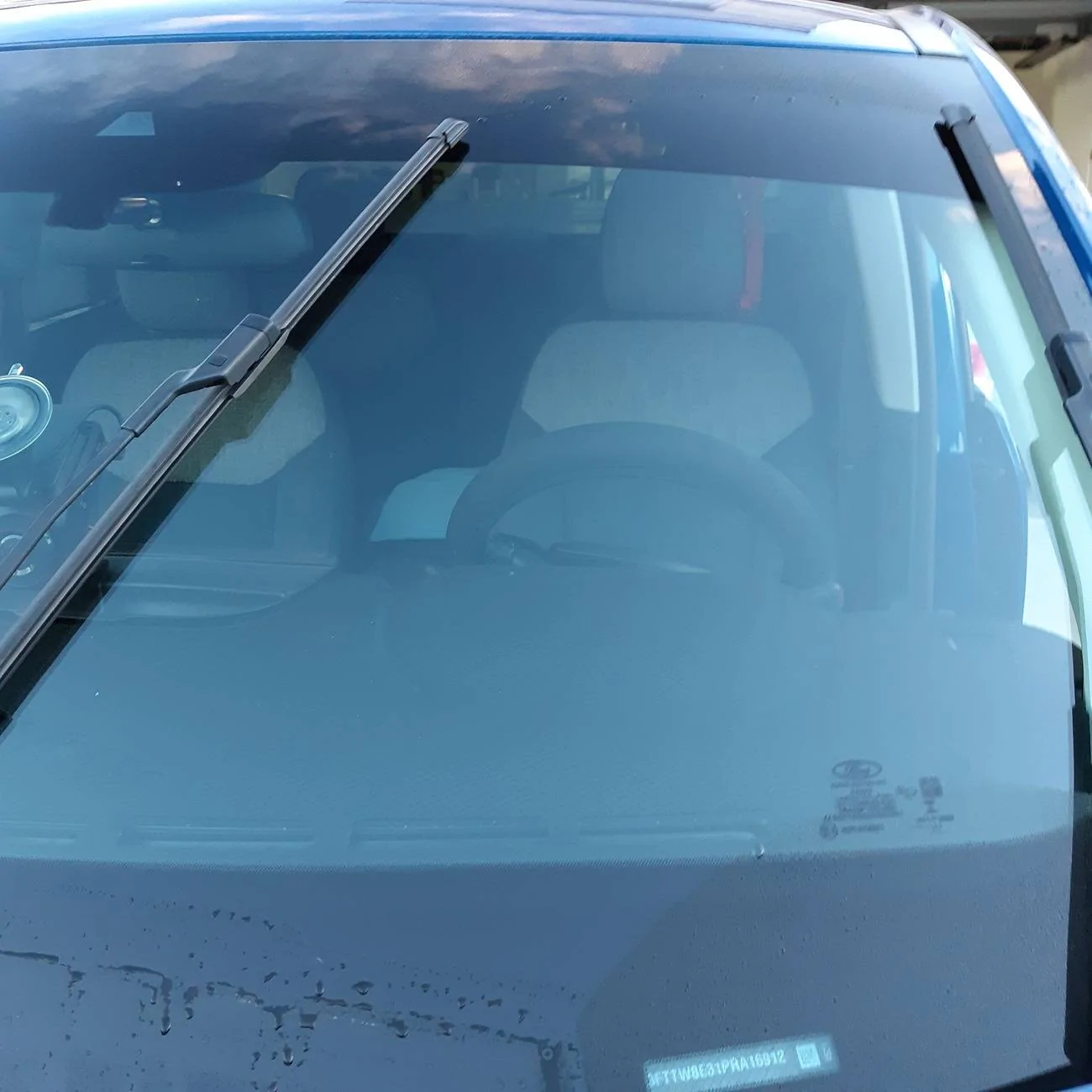

Sorry,
🤔 You can't see that I sprayed the windshield to show the pattern.
Ford Maverick Left Windshield wiper limited cleaning range 20250112_163643
