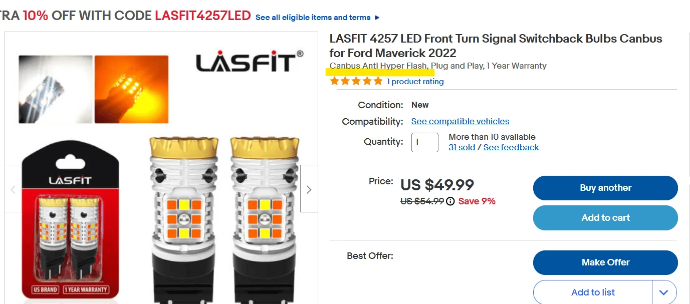

Awe man, I went with LasFit and changed out all the lights except for the tail/brake lights ( not available), because they were not supposed to hyperflash. Will keep an eye on mine, hope they can be a remady from LasFit for all the Maverick customers.

You’ll be fine as long as they aren’t on for a prolonged period of time
