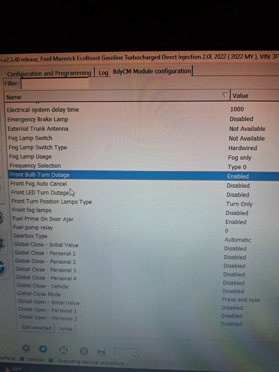

I wanted to share something that I just found when installing these LED lamps and using Forscan to designate the turn signals (yellow side of the LED) as DRLs.
Everything went fine with the install and programming. Afterwards though I noticed that with the DRLs lit, when I switch on the turn signals the hyperflash 3 times on the dash before the dash indicator turns to normal timing. I thought the hyperflashing was fixed with the new Lasfit bulbs?
Anyone else have experience with this? Just wondering if there's a work-around in Forscan or if it's someting I just have to live with. I didn't see anytning obvious in the Body Control Module settings to turn off bulb warnings for the turn signals.

I should have searched a little harder. I found an older thread that located the solution in the Body Control Module settings. It's in this thread and the solution was found by
90.eunos.cosm
https://www.mavericktruckclub.com/forum/threads/turn-signal-hyperflash-disable-found.22046/page-2
I changed the Front Bulb Turn Outage to "disabled", and all is well. Unless the bulb goes out anyway then I'll have to figure it out the old way. I may try to enable the Front LED Turn Outage to see if the hyperflash returns.

This has been a problem for the past couple years ever since Ford did a recall modification on the brake lights. Until then, the Lasfits worked fine. Lasfit said they came up with a new bulb that would work with the modification, but that never panned out. I don't know of any other vendor that has solved the problem with their LED bulbs unless you install a separate resistor. That being said, glad you found a work around. Frankly, I think the Maverick's OEM bulbs were plenty bright. Unless one routinely drives in inclement weather, I don't see the justification of spending $200 for LED brake/tai light bulbs.
