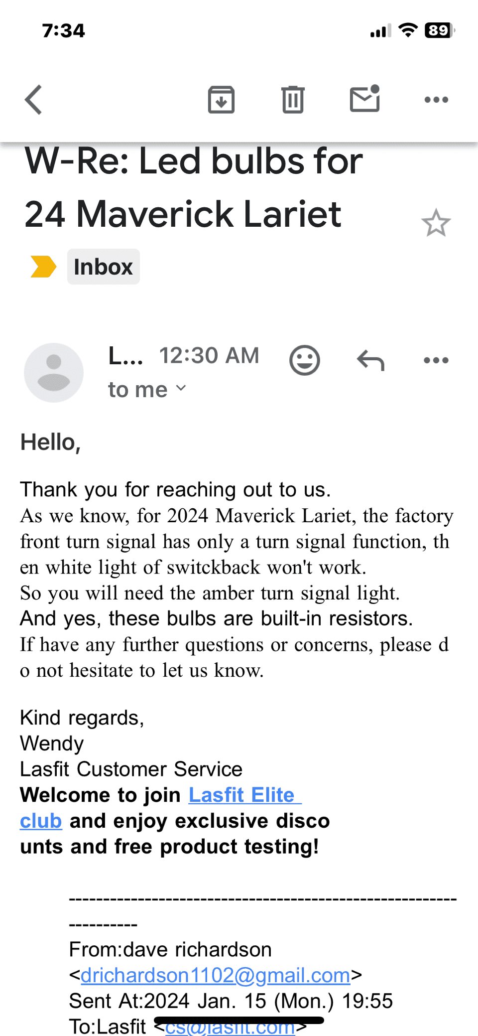

Got this from Lasfit .. any one install switchbacks ?? What experience did you have ?
Ford Maverick 2024 Lariat owners ….. no switchbacks? IMG_3642

Are you asking if you can install switchbacks in the Lariat FR turn signal? There would be no point, as it is just a turn signal, not a running light. Just buy an LED turn signal bulb for half the price.

Theoretically you could get the turn signal sockets from an XL/XLT that have the extra terminals and add the wires to the parking light circuit or, if you wanted them on all the time, a suitable key-on power source.
