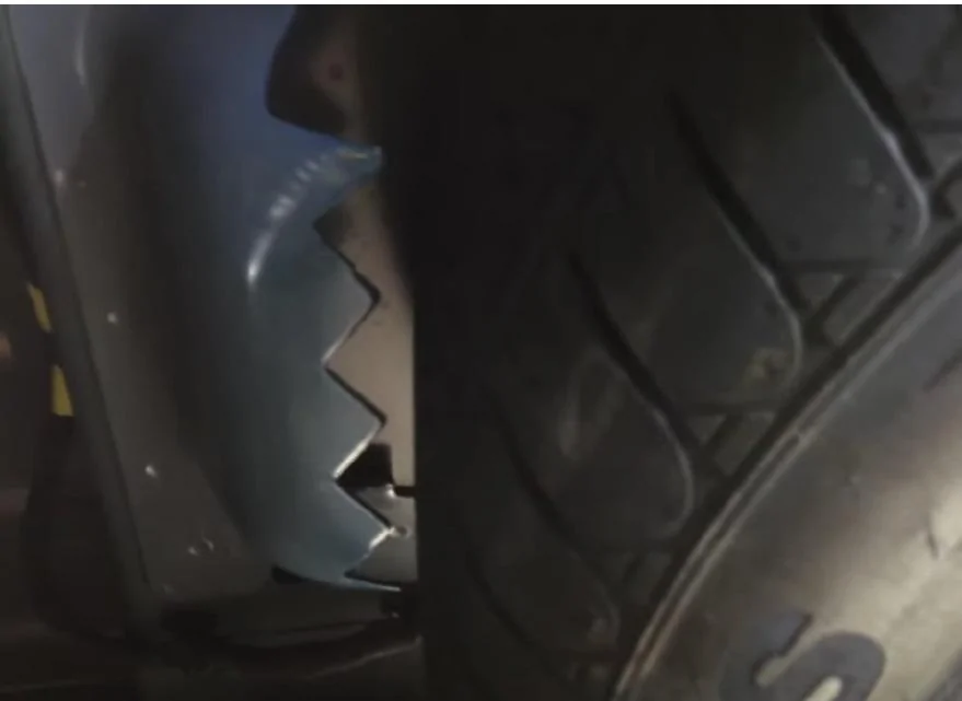

So this is what it looks like with the small 215/60R17 "Full size" spare that comes with the Maverick. As you can see there's minimal clearance between the spare and the serrated part so I don't think there's any way they kept the serrated part with the 245/70R17 tire and most likely trimmed it off like another member on these forums did, I can't find that thread unfortunately but do remember it.
Ummm... If you trim off those metal teeth, what would the spare tire do in a major rear end collision? Kill me in my Maverick or kill the one who rear ended my Maverick? My angle grinder and I are eagerly awaiting your answer. 😄
