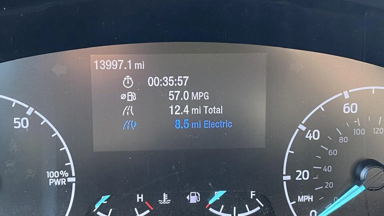

I disagree with your other point that it doesn't help boost MPG, because it does help boost MPG by keeping your battery topped up.
With that being said, your last sentence is absolutely true and the most important reason I didn't even bother trying L mode after learning of it. Already so many crazy drivers out there, without brake lights you're asking to be rear ended.
It really doesn't.
Maybe you got that impression via your particular driving.
I can get 57 MPG any day, any road, as long as you let me stay 45 mph or under.
I keep my battery as LOW charge as practical. Usually 30-40%.
Carrying around a full battery is carrying around POTENTIAL energy. Maybe you'll use it, maybe you won't.
In my case, I've realized / utilized that energy.
Also, batteries accept charge (regen or other wise) more efficiently the lower the charge.
Like SPAM, "try it before you knock it".
Honestly though, driving technique plays more of a role than mode.
Coasting, neither regenerating nor burning gas or electrons trumps all.
Photo from Today. I have 100 similar photos from 100 other days. Always slippery. Always gentle regen. Battery always low as practical.
Fuel Calculation set to -5%.
950/1000. Very close to actual at the pump. Not exaggerated. Level roads. Flow of traffic. Speed limits 35 & 45.
