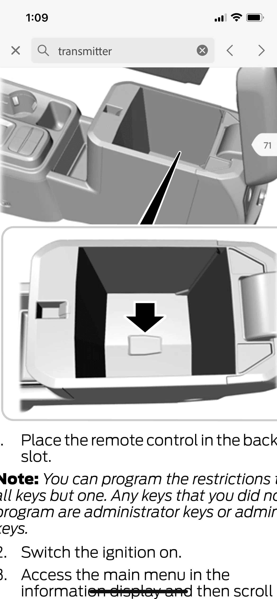

1. Grab both keys
2. Put one key in and turn it to the the on position, but not running.
3. Turn off and Remove the first key
4. Put the second key in and turn to the on position.
5. Master code displayed on dash.
edit add- might have to wait a 3-5 seconds while in the accessory mode with both keys

I stand corrected. Didn't follow instructions closely. After I turned the key to the ignition (second postion) it's working now. Thanks everyone for the info.

I tried and failed more than a year ago, and then when adding a 3rd fob and key, the master code displayed on the screen just after the key was added. I was surprised and had to think why the code displayed, finally realizing adding another recognized fob was the same procedure to access the master keypad code.

A 2022 model year will display the master code at the end if programming a new key. There is a documented(owners manual) procedure to make the master code display which I tried unsuccessfully. I think it is somewhat time sensitive as I had a failure with the new key, but tried a second time and it succeeded.
