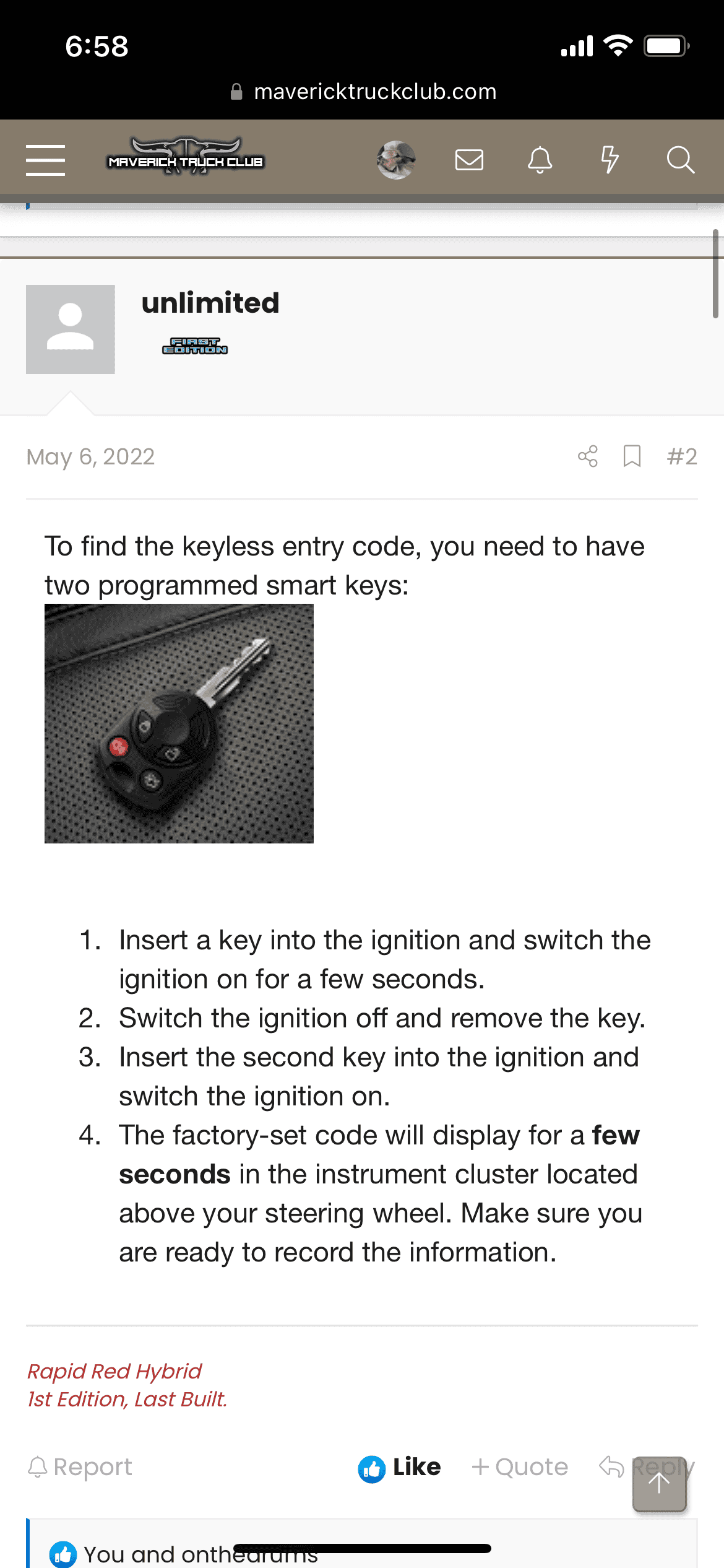

here is a post from @unlimited his directions are a little different
Ford Maverick KEYLESS ENTRY KEYPAD master code? BC648F7B-843F-4289-A3D4-A134473B3261

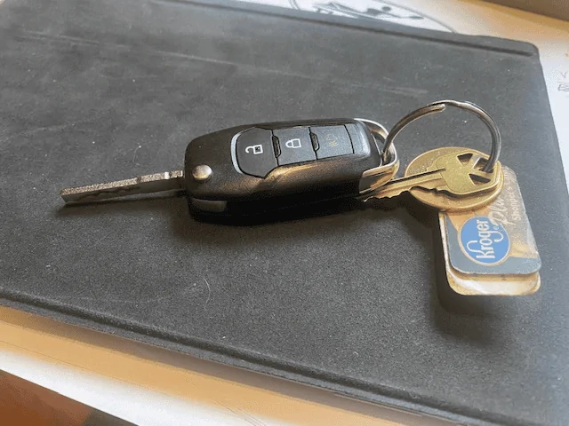

Maybe my key does not qualify as "smart?" My XLT has no push button ignition switch.
grumpyunk
tom
Jul 9, 2021
560
615
georgia
07 Mariner 85 Ranger 97 T-bird 87 Sable
Nor does any other XLT, or XL for that matter. I tried the steps indicated several times, without any indication of success. I also talked to customer support, and they repeated the same instructions. I did not pursue it because I found the plastic card with the 'master number'.

The easiest and most sure way of finding the keyless entry keypad code without the dealer and digging around your truck is to use forscan. When you're looking at the tab that you can select live data. The keypad numbers are one of the options you can look at. That will get you the numbers you need.
