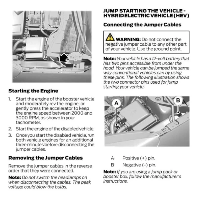

You might be a victim of the 12v battery drain issue if it keeps dying.
And yes, a lot of Hybrid owners can easily make the mistake of jumping using the black cap terminal and red cap terminal which blows a 100a ECM fuse.

I would also like detail on the system. I think the caps are isolated totally from the 12v system and function to smooth the current from the 3phase motor/gens when they are generating current for the inverter/converter. The positive jump post (should?) Possibly control a second relay to close contacts of hv battery. I am worried about using jump post if lights and radio and etc are on and if too much current is dumped onto the 12v bus?

The 12V battery that runs the hybrid truck is under the back seat, not under the hood. The connections for jump starting the this battery are under the hood. After sitting for 14 days the battery was not probably dead but the truck was in deep sleep mode. The truck does this to conserve the battery and jump starting is a method to wake it up.
