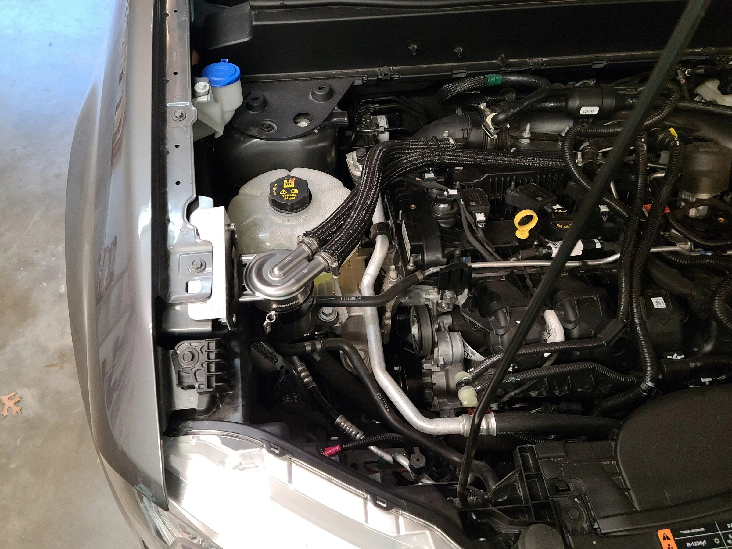

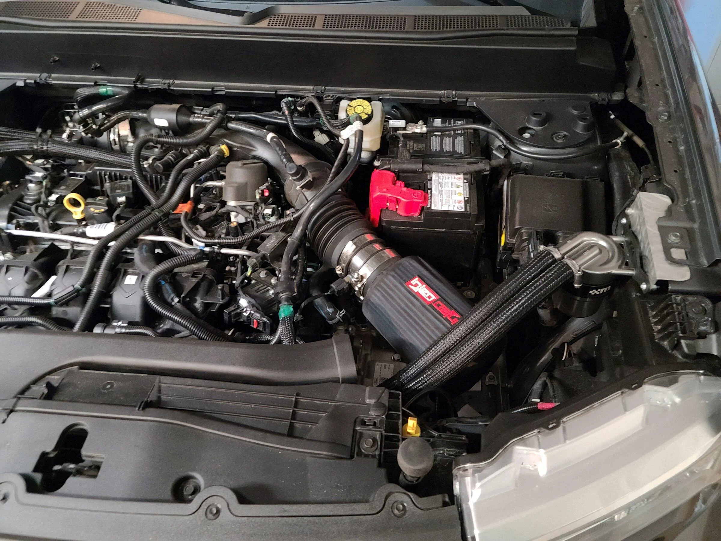

Pax side to the air inlet piping and valve cover vent, drivers goes to the crankcase vent and lower intake plenum. Base motor runs 2 systems, catching nasties in both cans.......
Gonna just stick w one for now prob. Idk. Have any pics of where the drivers side goes? Pm me is fine

Sure, I will hit ya with a pm on how I did mine, in respect to the OP here is a JLT video on a 2.0 ecoboost install where they bust the intake loose for access, (I did not).

Thanks! Yep I am getting about the same on both, maybe a touch more on drivers. I would have used what I had on the shelf too!! But the cupboard was bare....
I have a check valve on the way from UPR for the drivers side, intake pressure seems to be overwhelming the mountune seals a bit, no leaks just odors after I put her in the garage at days end.
