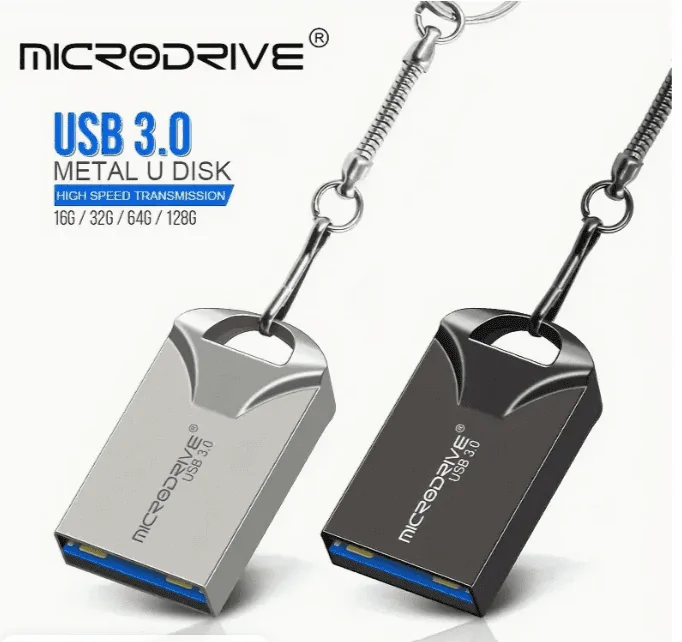

I had a similar experience until I Found a Mini USB. The larger USB bounces when you hit a bump and you lose the connection. Never had an issue with the mini.

I do agree with the micro drive post. less bounce plus you are less apt to hit it when putting things in the caddy.
