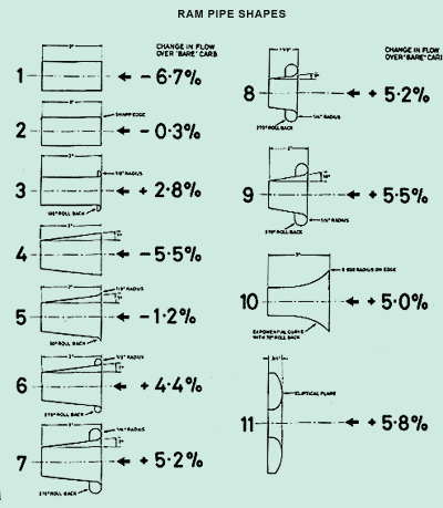

Not directly connected to a Maverick, but the only way to know for sure what the flow potential of any system is, is to test it. I have had a homebuilt flowbench for many years, capacity of ~600cfm at 28"wc. In most cases, the factory stuff is highly developed, and what looks right to the casual eye is completely wrong. Bare round sharp edged holes flow poorly. Contrary to how it looks, air falls into an opening from the sides, almost zero air comes straight in. You can actually test that by simply holding a flat stiff plate in front of an opening drawing air in. You will have to get surprisingly close before it will impact the flow into the opening. There is lots of stuff on the net about the best shapes for flow into an opening, it costs nothing, and perhaps a discovery will be made. Flow benches aren't only for testing heads.

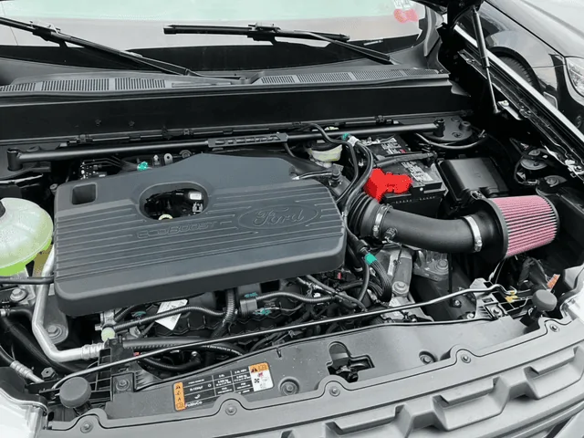

This part of the intake is very narrow. IT seems like it would be a restriction to airflow. It is possible to remove it and just leave to hole into the airbox. Or is there an aftermarket replacement that is a wider pipe? Or is it not worth it for a stock engine.
I know there will be 100 different opinions and thoughts on this. I don't want to get made fun of or demeaned. I have heard that fresh air outside is possibly better than engine bay air, but with an open airbox it might get much more air with this piece missing. The best option seems to be an aftermarket piece that allows for much more air, but I couldn't find if there is one.
There seems to be a shortage of filters in my area. Nobody has them. My dealer is stocking aftermarket cabin air filters. All the local parts stores could not even order me a filter. K&N what the only thing available. I found a green filter and installed it. Their claim is they are a middle ground between airflow and K&N letting everything in. They claim to filter to 5 microns. I hope it is true, but with the extra airflow they say they allow this funnel seems to be a choke point.
Maybe I am just bore today and over thinking it, maybe I can get an extra 3-5 HP. I don't know and am asking for honest, non-insulting advice or help.

Keep the stock tube but flip it around and heat it and bend it to fit into a nice slot on top of the hood. Ram Air Grabber hood baby!
There are sponsors here that sells items you want and throughout the forum are several posts of homemade ones that look great as well as just the replacement filter k&n part#’s, etc. and yes I see you asked for help without being beat up 😉 that’s the joys of social media.
