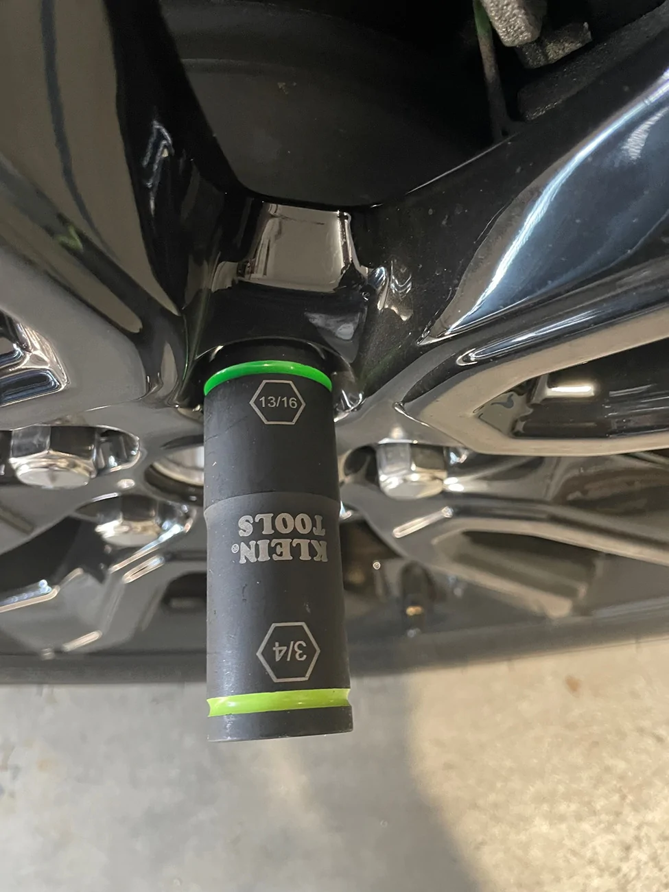

The stud may be metric, but the hex is 13/16". Measure one for yourself.
HRG
Crap I used a 21mm as all my 1/2 inch sockets are metric and 21mm felt best. Just ordered a 13/16 - thank you!
You're welcome. Obviously, a 21mm socket will work, but with it's looser fit the thin aluminum overcap of the Ford 2-piece lugnut will get beat-up that much sooner.

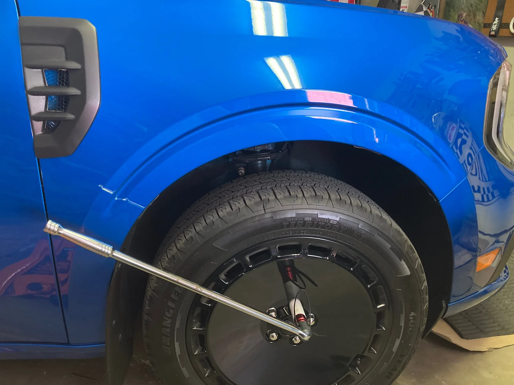

I used that 2ft breaker bar to loosen. To retighten, I started with the breaker bar and used my beefy torque wrench to get to spec.
I should store that breaker bar & 13/16 socket in my truck instead of storing in garage? Not sure what the OEM lug wrench looks like…but if it is “short” it would be painful to use!

Get a good 13/16" socket and at least a 24" long breaker bar, those lugnuts at 150# of torque need some grunt,,,,,
HRG
just have a 2' piece of 1.25" pipe. It can be used for more than a socket wrench extension.

I've learned to ditch the factory wheel wrench in favor of a breaker bar or socket wrench with extension pipe. The factory bar always seems to fit and operate poorly.
