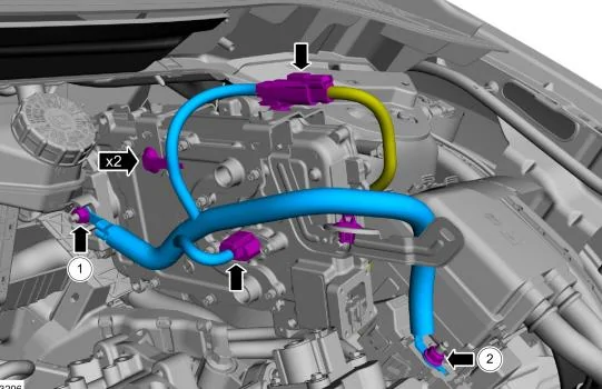

The factory manual shows this image for one of the hybrid battery cables ("Battery Cables - 2.5L Duratec – Hybrid (121kW/164PS) (S3)" :
Ford Maverick Intermittent no power isuue Maverick_Battery_Cabl
Anyone have any idea if this is the cable with the bad solder connection? It does not appear to match the LX6Z14290PA cable.

I believe this is the bad cable
I wonder if that one runs from the battery to the engine compartment? The image I posted has the end terminal (#2 in my FSM photo) that someone mentioned was the one with the bad solder ("position B" in their photo showing "A", "B", "C").
