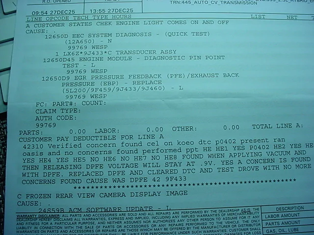

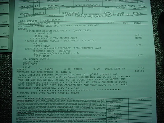

2022 hybrid lariat 46k miles
Jan 9 2026 got p0402 replaced under extended warranty LX6Z*9D475*A EGR VALVE $100 DED
Feb 4 2026 got p0402 replaced under (5yr/60 or 80k warranty?) LX6Z*9J433*C TRANSDUCER ASSY WITH TECH COMMENT = "When tapping on DPFE sensor pid goes ERRATIC"!!!! This covered no charge.
ETA: apparently vehicle movement can cause pid bad readings???
