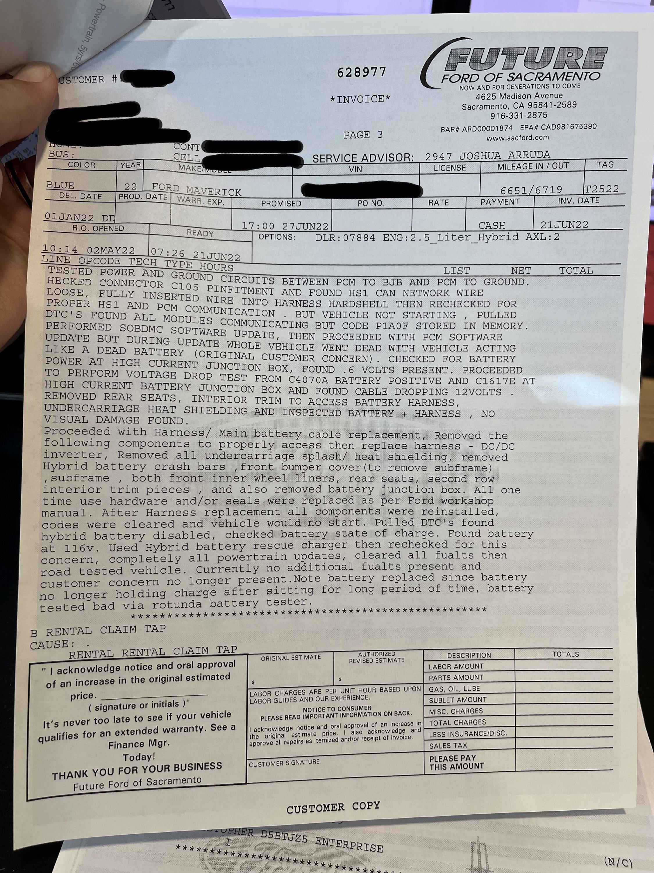

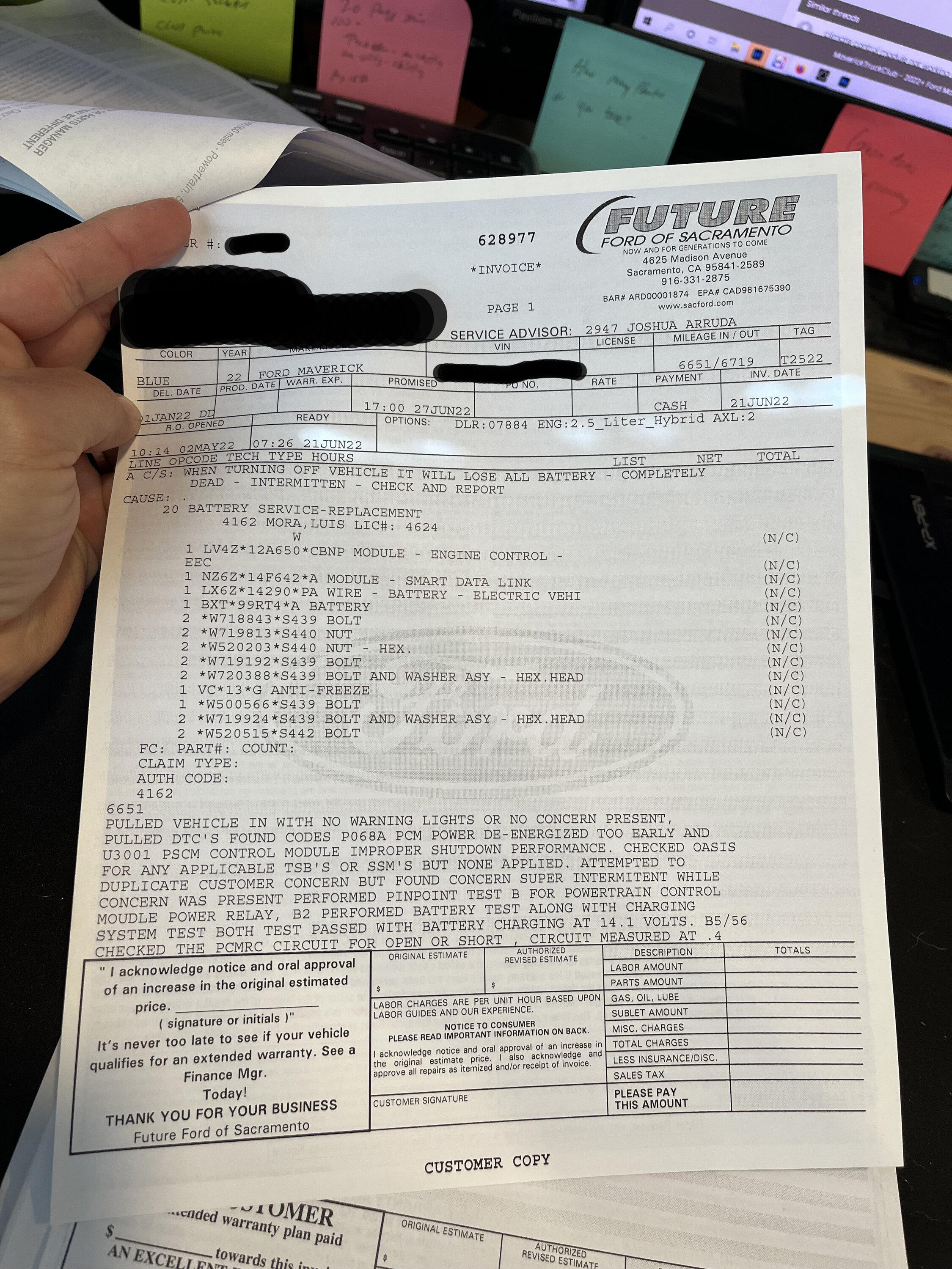

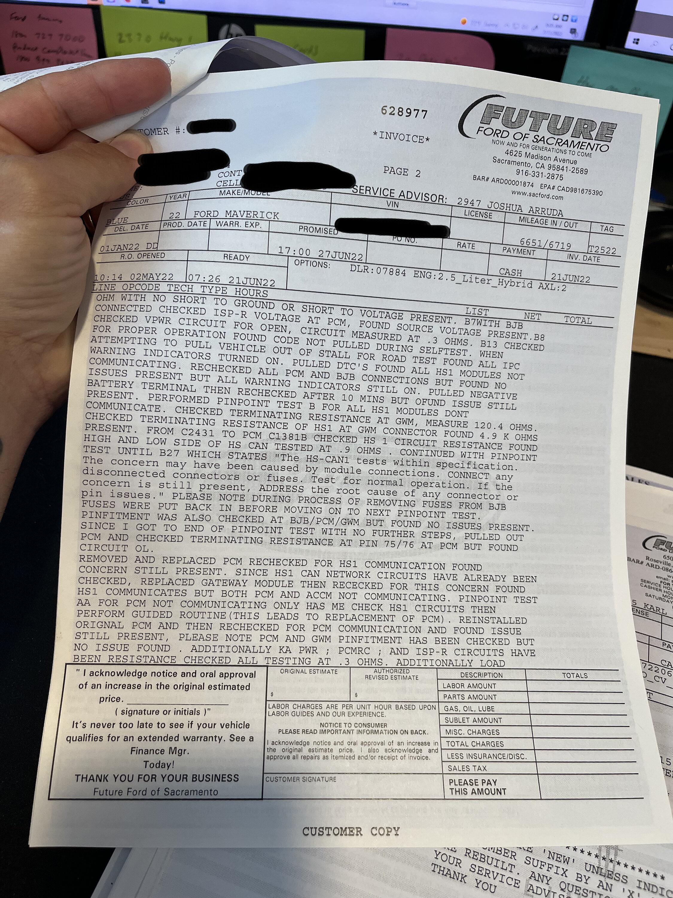

After only 50 days in the shop the saga is finally over.
Ford shipped the part faster than expected, service put it all back together, tested it and gave me a call to let me know it was ready. I took it out yesterday and the truck performed exactly as it should. I hope all the other hybrid owners that run into this issue get a quick fix since this now seems to be a known issue.
Could you share the repair paperwork from the dealer (a.k.a. technician report)? ... thanks.

Same thing happened to me. Hybrid XL. Shop said it was the Body Control Module
Its been in the shop for 5 days now.
