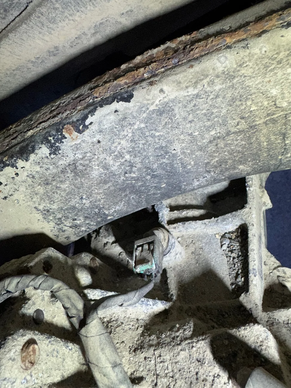

Hey guys my truck was doing this a little over a month ago and eventually it completely shut off. Ford dealership said my rdu speed sensor/ also called rear wheel speed sensor was no good and its not covered by the normal powertrain warranty. Dealership wanted $700 because they planned to drop the rear in order to change it out. Tried to change the sensor out myself because the sensor only cost me bout 60 dollars from ford. Spent 3 days messing with the old sensor before taking it to a local shop for $150 and had it fixed in two days. The sensor sits on top of the rear axel and gets covered by dirt and rust where i live. I attached a pic of the sensor before i started breaking the sensor housing before giving up. Might be doable for people who do not have rust issues its just a plug and play replacement sensor. Hope this helps and good luck. In the picture that plug that is centralized is the top of the sensor and will have to unplug as first step
