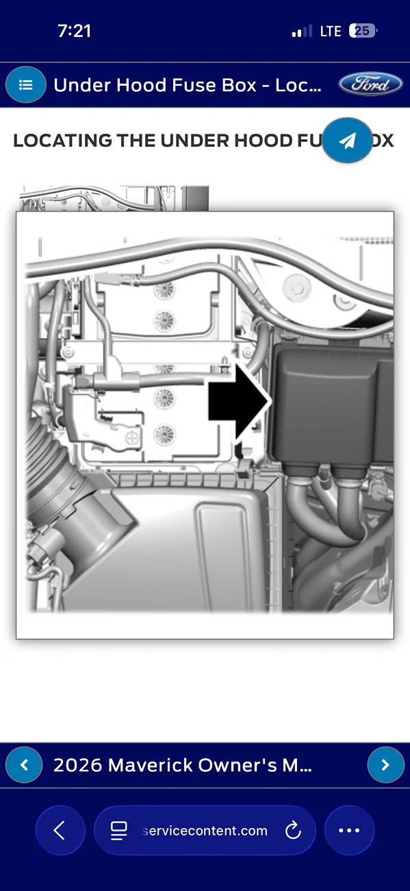

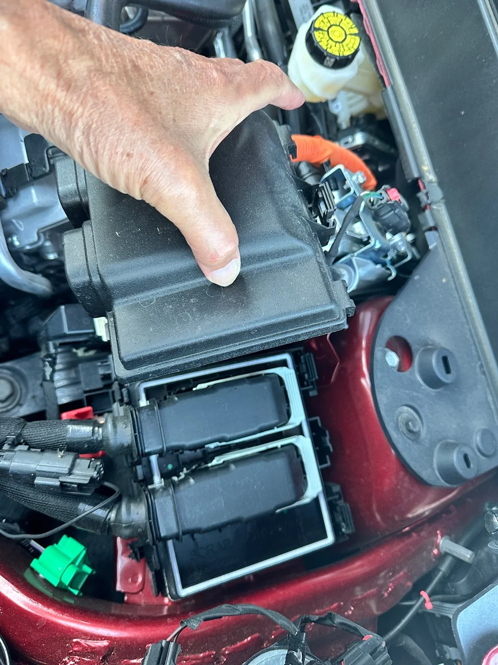

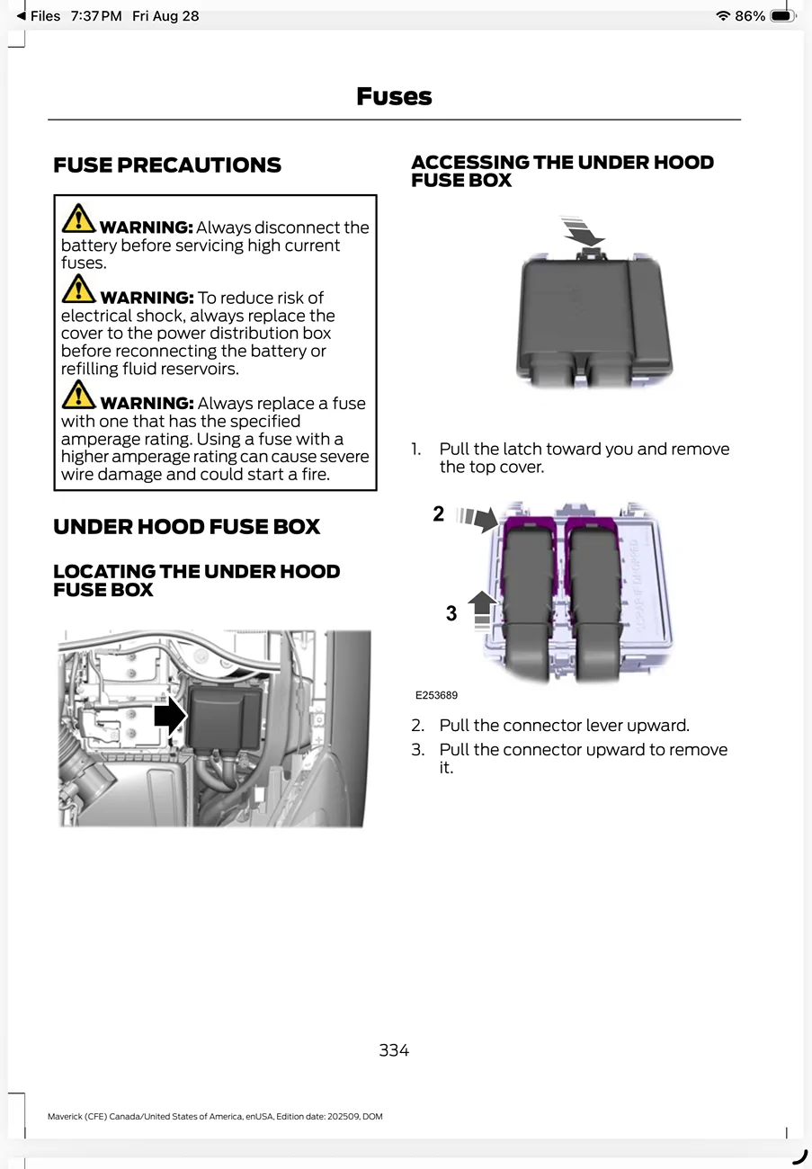

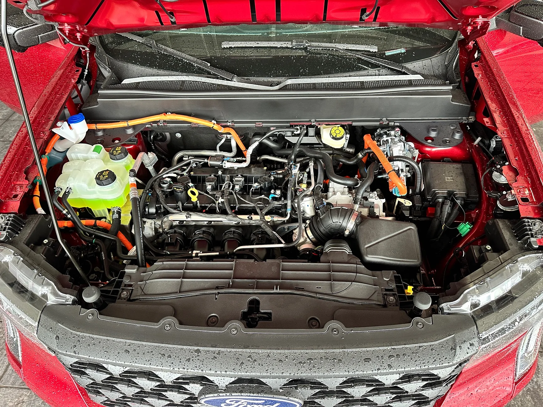

Does anyone have an actual photo of the underhood fuse box location For the 2026 HYBRID?? I’ve done the Google and other searchs and the AI BS all tell you to look under the hood by the battery. There’s no fricken battery under the hood of a hybrid!
On the Hybrid, the 12V battery has always been under the rear seat on the passenger side, and I would assume is still there on the '26. Pull the little nylon tab near the front edge of the seat, may have to hunt for it if it got tucked underneath the seat (it likes to do that)
The fuse box can be seen there on the driver side, just in front of the strut tower. Remove the plastic top piece. And now for the real kick in the teeth, most of the fuses are on the underside. Going on memory here, but after removing the cover I think you unclip the two large clips at the top and lever nearly the whole box out. The truck doesn't like this when the battery is hooked up, BTW, the headlights and taillights will come on and stay on because half the modules just lost power. 🤣

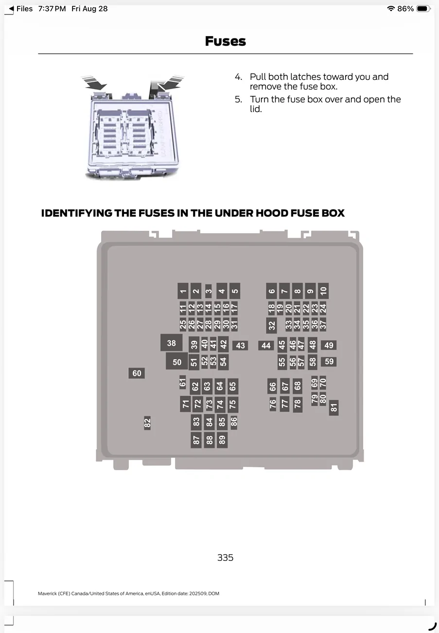

Oh - and here’s where Ford‘s Owners Manual tells you where it is and the second pic is what you find there on a Hybrid…
yeah - I knew the 12v battery was under the seat. I just downloaded Ford’s PDF manual (which is different from their HTML web based version).
You’re right about the location.
Someone at Ford needs to have their PeePee slapped hard with a wooden ruler for this EFF-up!
Probably the same moron that said we don’t need printed owner’s manuals!
I am pretty p!$$ed off at Ford right now. I‘ll be taking a harder look at that new Hybrid Honda Ridgeline when it comes out…
Maybe these pictures will help out someone else down the road..
