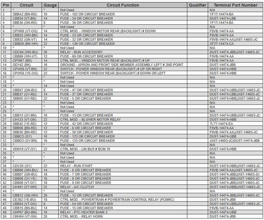

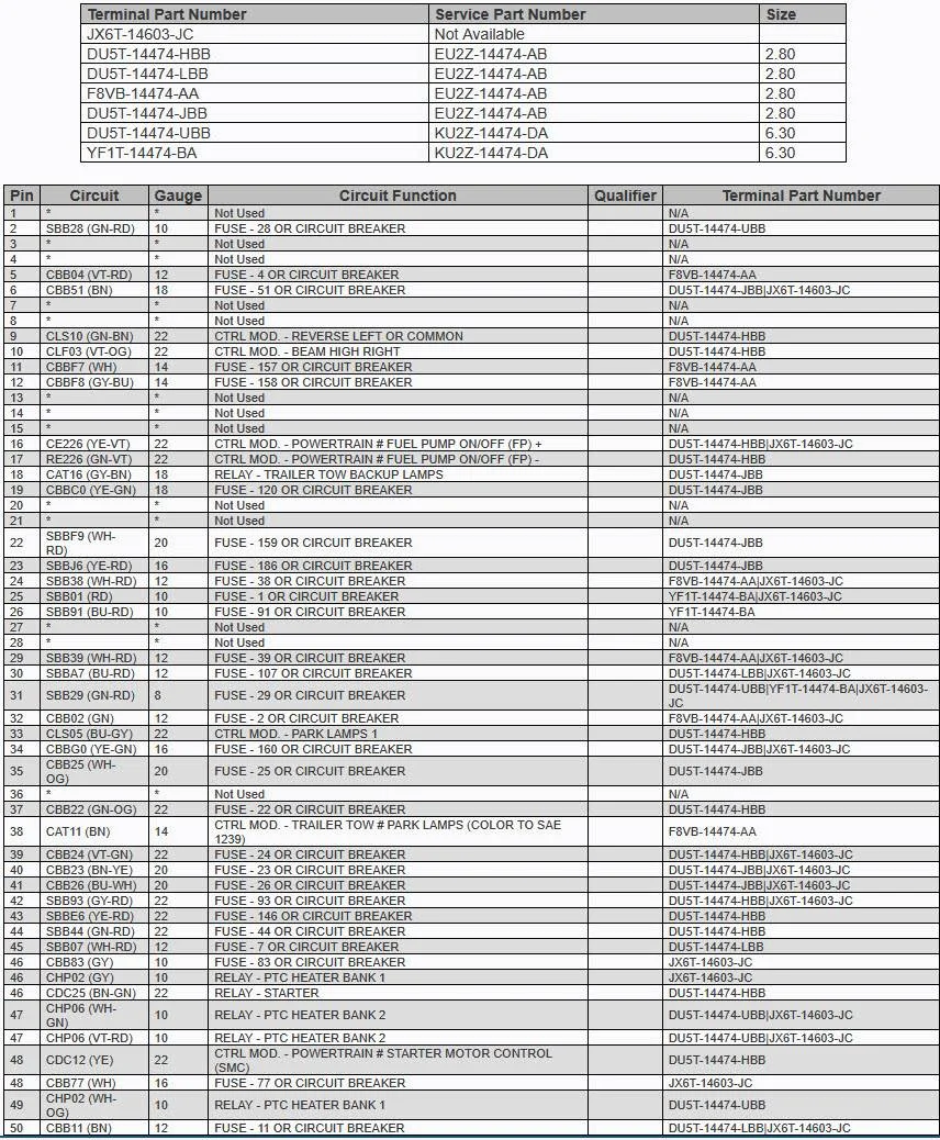

The 2 harness connectors C1035A, C1035B use TE Connectivity MCON 2.8mm and 6.3mm female terminals.
These bare terminals don't seem to be stocked.
So the Ford terminals with wire are what to buy looks like.
The Ford terminals would be:
EU2Z-14474-AB = Size 2.80
KU2Z-14474-DA = Size 6.30

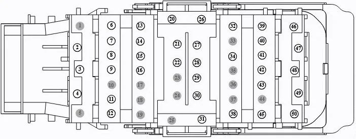

C1035A <-> C1 BJB
Ford Maverick Installing factory trailer brake system (2024 Tremor XLT) C1035A Pins

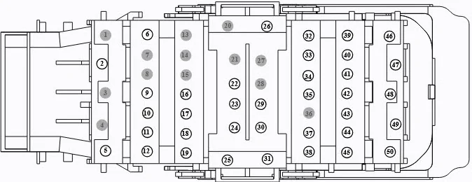

C1035B <-> C2 BJB
Ford Maverick Installing factory trailer brake system (2024 Tremor XLT) C1035B Pins

C1 - C1035A - 50 Pin Female
F91 40A (20A AsFound) -- C1035A p26 <-BU/RD-> C4397A Pin 14--TRM Power--||--(LH Turn/Stop, RR Turn/Stop)
F107 30A -- C1035A p30 <-BU/RD-> C222 <-BN/RD->--<--> C4397B, Pin 11<--TRM Battery Charge--||--C4397B p12<-OR-> C404 p48 <-OR->C401 p6<-->C4099 p5 = TT Charge
F55 20A -- C1035A p38 <-BN-> C222 p38 <-BN-> <--> C404 p44 <--> C401 p3 <--> 7/4 Connector = TT Park/Running Lights
F58 10A -- C1035A p18 <-GY/BN-> C404 p33 <-GY/BN-> C401 p2 <-GY/BN-> C404 p44 <--> TT p7 = TT Reverse Lights
C2 - C1035B - 50 Pin Female
F42 25A -- C1035B p28 <-YL/RD-> C219 p6 <--> C4397B Pin 13 <---TRM--||->C4397B p14<-BU-> C404 p50 <-BU->C401 p1<-->C4099 p3 = TT Electric Brake

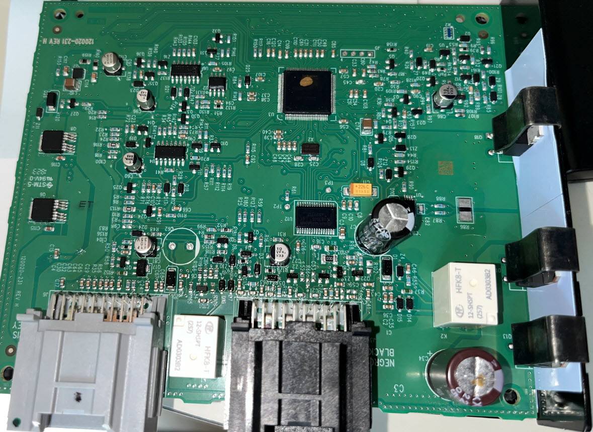

My 2023 2.5L TRM labeled NZ6T-19J294-BA
Ford Maverick Installing factory trailer brake system (2024 Tremor XLT) NZ6T-19J294-BA - PCB Components

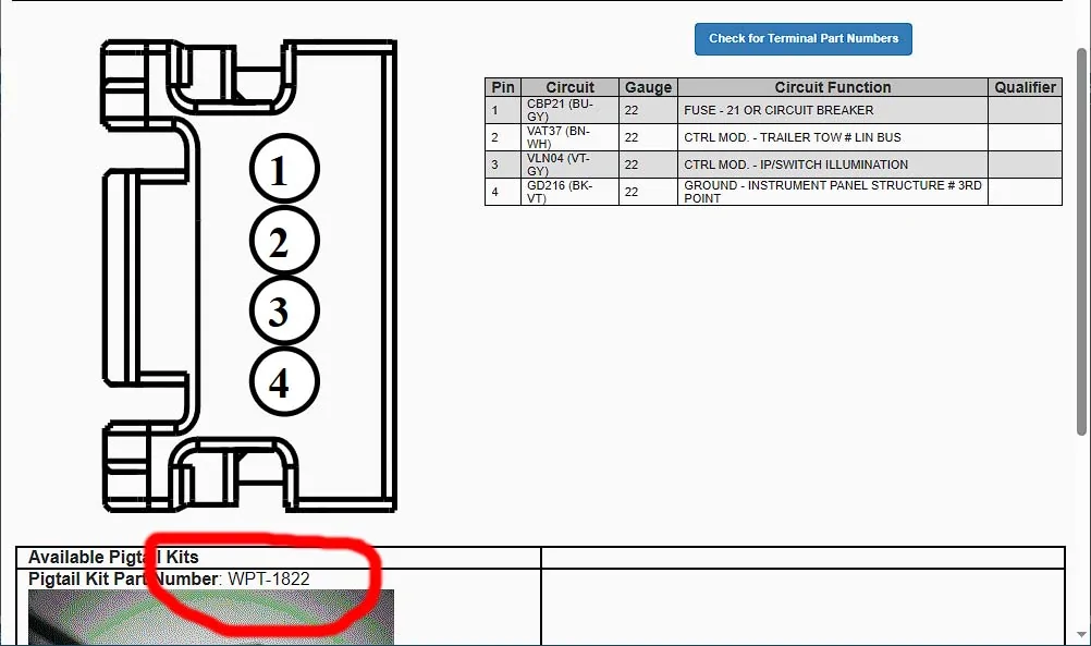

The controller connector is the same as an F150, WPT 1822
Ford Maverick Installing factory trailer brake system (2024 Tremor XLT) Connector
