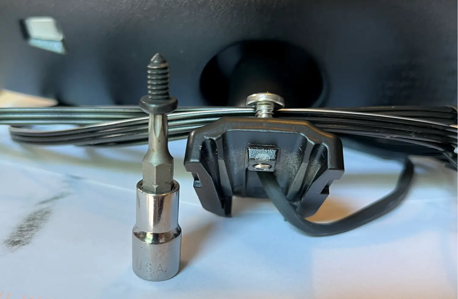

Bob,

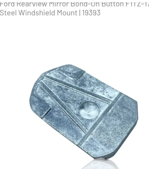

Did you happen to notice if the screw had a point? The one I had on my Chevy Volt, had a point that fit into a little divot on the metal mounting plate that was cemented to the windshield.
**Obligatory disclaimer
Example only not sure this is what the Maverick has
Ford Maverick Installing Dimming mirror - lost my darn mirror mount screw 20260524_083838

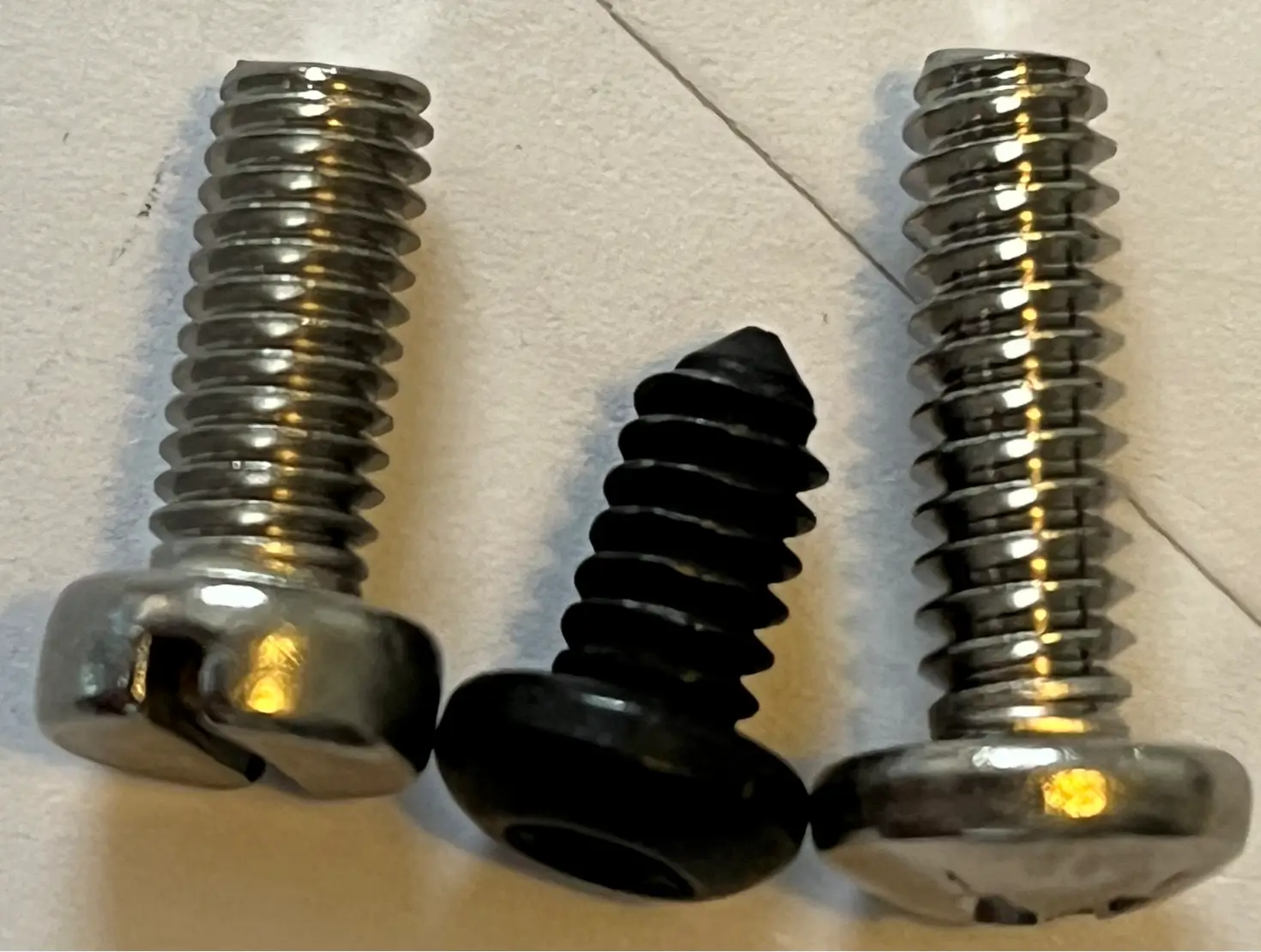

On a Kia KA7062ADUP1 dimming rearview mirror it has a 10-24 x 3/8" pointed tip torx screw.
Checked a 10-24 to see if it fit, it did.
The screw it came with feels a bit tighter the further it goes in than the regular 10-24.
Ford Maverick Installing Dimming mirror - lost my darn mirror mount screw 1779646859507-5t
Looks similar to GM's 19207911 10-24 x 3/8 Inside Rearview Mirror Bolt.
5mm, mirror screw, 10-24
Ford Maverick Installing Dimming mirror - lost my darn mirror mount screw 1779647320055-zt
