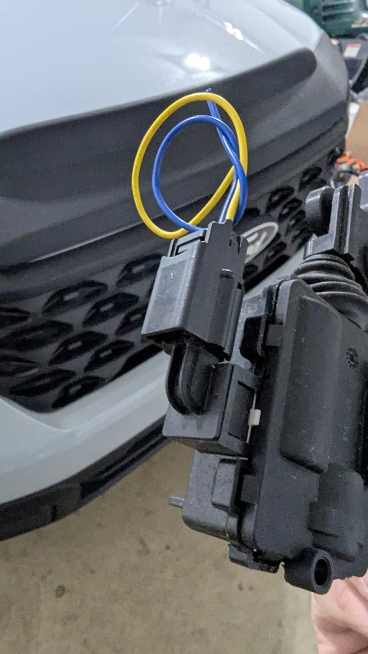

For those who chose this route, it is actually fairly easy.
New instructions are below. Some pictures are below but not sure of their order shown.
1. You do not need to take off the door trim. That work was required to identify the necessary wires.
2. Take off the interior cover on the B pillar.
3. Cut and remove the black cloth tape and find the white/brown and green/brown wires. Chose your preferred wire splicer and splice in both wires. VERY IMPORTANT. Test your power lock actuator before you route the wires.
4. Once testing is successful, then route the wires back to the tailgate.

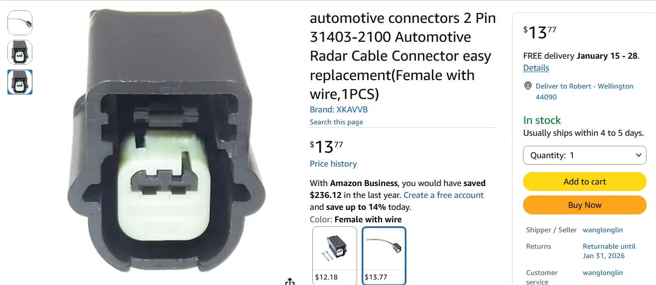

5. Buy a generic Ford 2 wire connector as parts to connect to the power lock actuator. I built a connector from scratch. See picture.
I have ordered one of these connectors suspecting it will fit the power lock actuator. It had an extended delivery date but will confirm fitment once received.
Ford Maverick Installed Power Locks on Tailgate of 2025 Maverick XL 1766761806270-7
CONFIRMED. 31403-2100 plug does fit the power lock assembly.

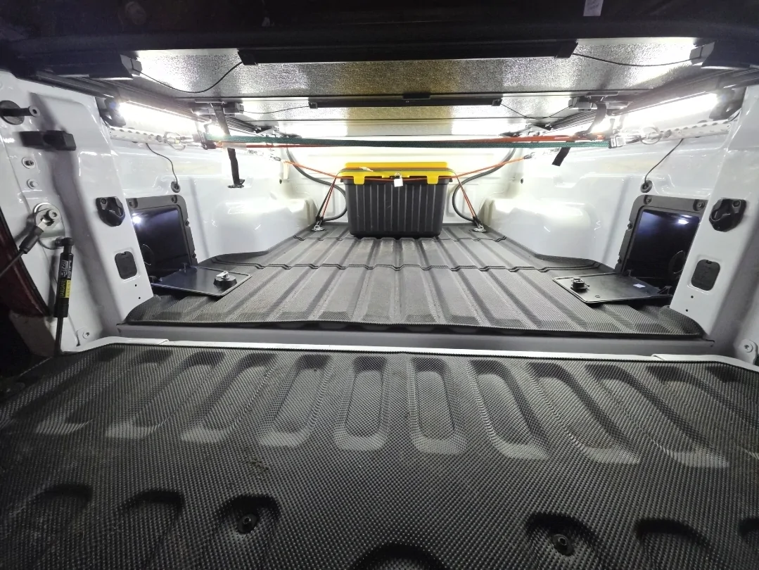

I wanted to thank everyone for the great information here. I did the lock actuator and wiring on my brand new XL that I just bought. I removed the trim panels from the door post all the way back to the rear of the truck and found a little rubber grommet that allowed me to run the wires straight back through the passenger side fender, under the tail ight and over to the tailgate. While I had the trim panels removed, I also tapped into the factory cargo lights located up top with the brake light. Ran those wires through the same spot as the tail gate wiring so I can install some led lights for the bed that'll work with the factory ones. I wanted them to turn on when I click unlock on the key fob or press the button by the headlight switch. I found a great price on the lock actuator at Walmart of all places. Was cheap and works perfect! The web page at Walmart doesn't say it works with 2025 and up Mavericks but it's a perfect fit on my 2025 Maverick. https://www.walmart.com/ip/Unique-B...24-JB3Z-9943170-A-2-Pin-Rear-Unit/17944722899
Do you have any information on the cargo light wires that you tapped into for bed lights? Location and colors?
I don't remember their colors. I tapped into the wires going to the cargo bed lights above the rear window. Ran my wires inside the headliner, down behind the back seat and out the same spot as the tail gate lock wires. Ran inside the right rear fender to the right rear tail light area then into the bed for my bed lights.
