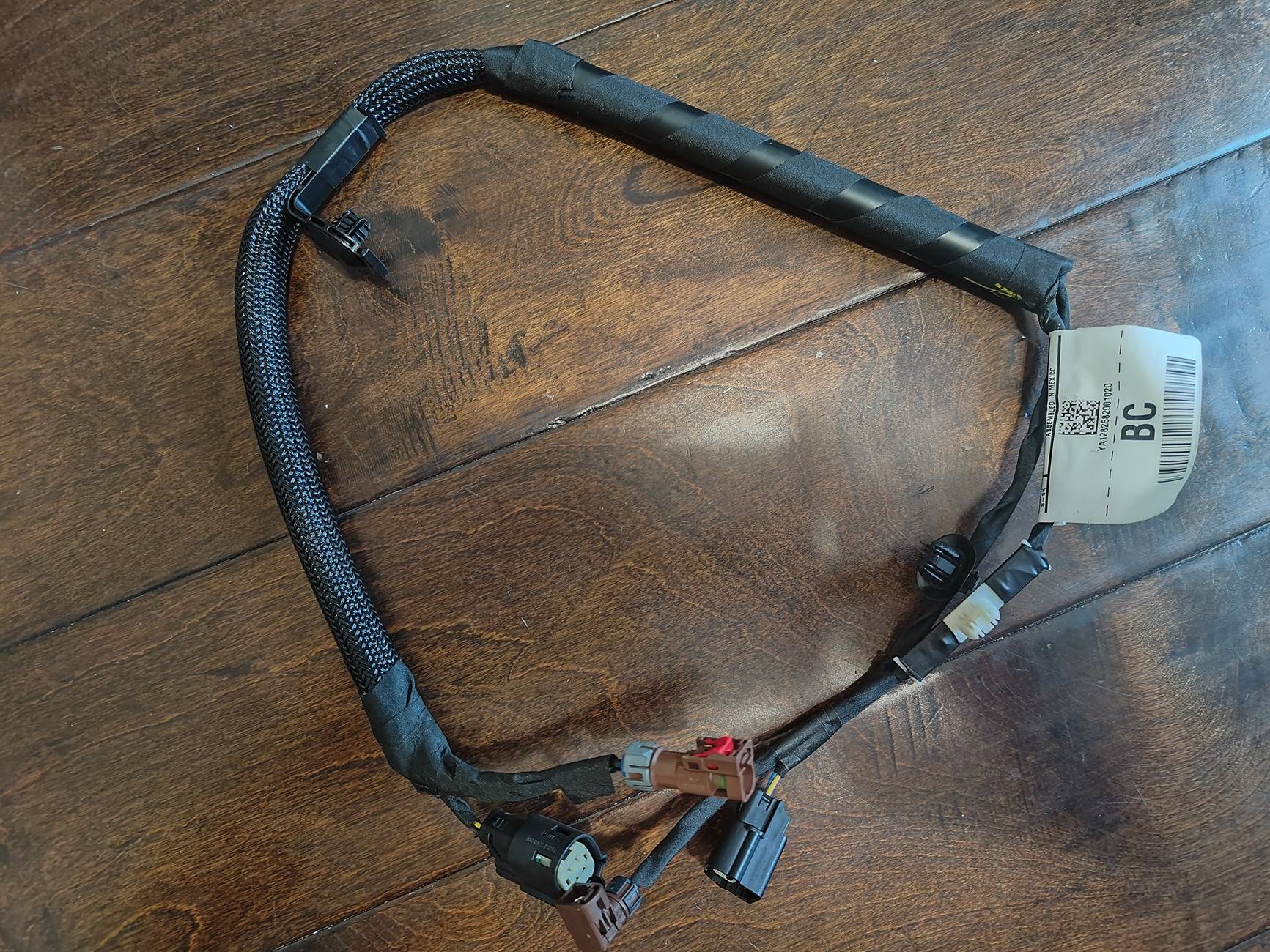

I spent half of the day under 2025 Xl and 2024 XL. Was trying to find right wire that I can connect to. Interesting finding that wire colour's remained the same for 22-25 that are responsible for tailgate power lock. They are Yellow/ purple line and Blue/ red line. Cord that I bought for XLT 2025 got the same colour marking as previous models. It's insane...... But....main large cable under the vehicle that running from inside of the vehicle need to be replaced entirely. And completely not with it. Just by it self it cost 1400$ chepest that I can find and probably will take half of the day to replace. Tapping into and splicing side door panel is kinda a better option. I will try to look an easier option to run wires. Just wanted a honest OP opinion before I start removing some panels.

Don't really need cable harness regardless, since there no place to connect. Bought all parts. Only actuator might work. Actuator not worth since you still have to connect other cables from the back

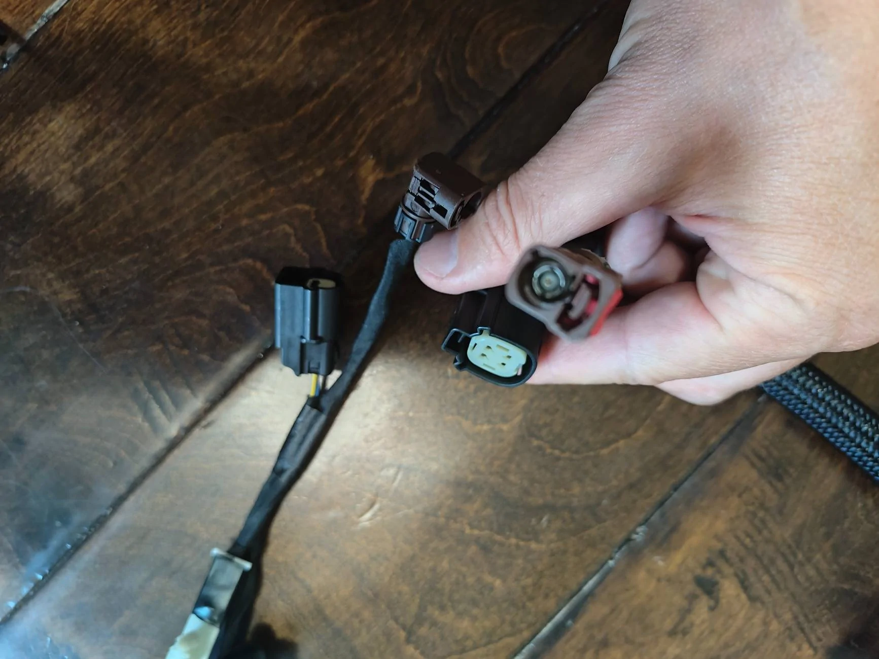

I did this to my truck yesterday. The only deviation was that I cut the connector off the 22-24 wire set and connected it to the two wires I jumped into the signal wires in the cab. That prevented me from having to use the glue method. I had the parts laying around since I ordered my truck about this time last year (originally ordered a 24, then switched to a green 25!). It only took me about an hour total.

I didn’t take any pictures as I was following the previous directions. The only very small issue I had was the wire colors are duplicated on my truck. I chose the larger gauge ones and that just happened to be the correct ones.

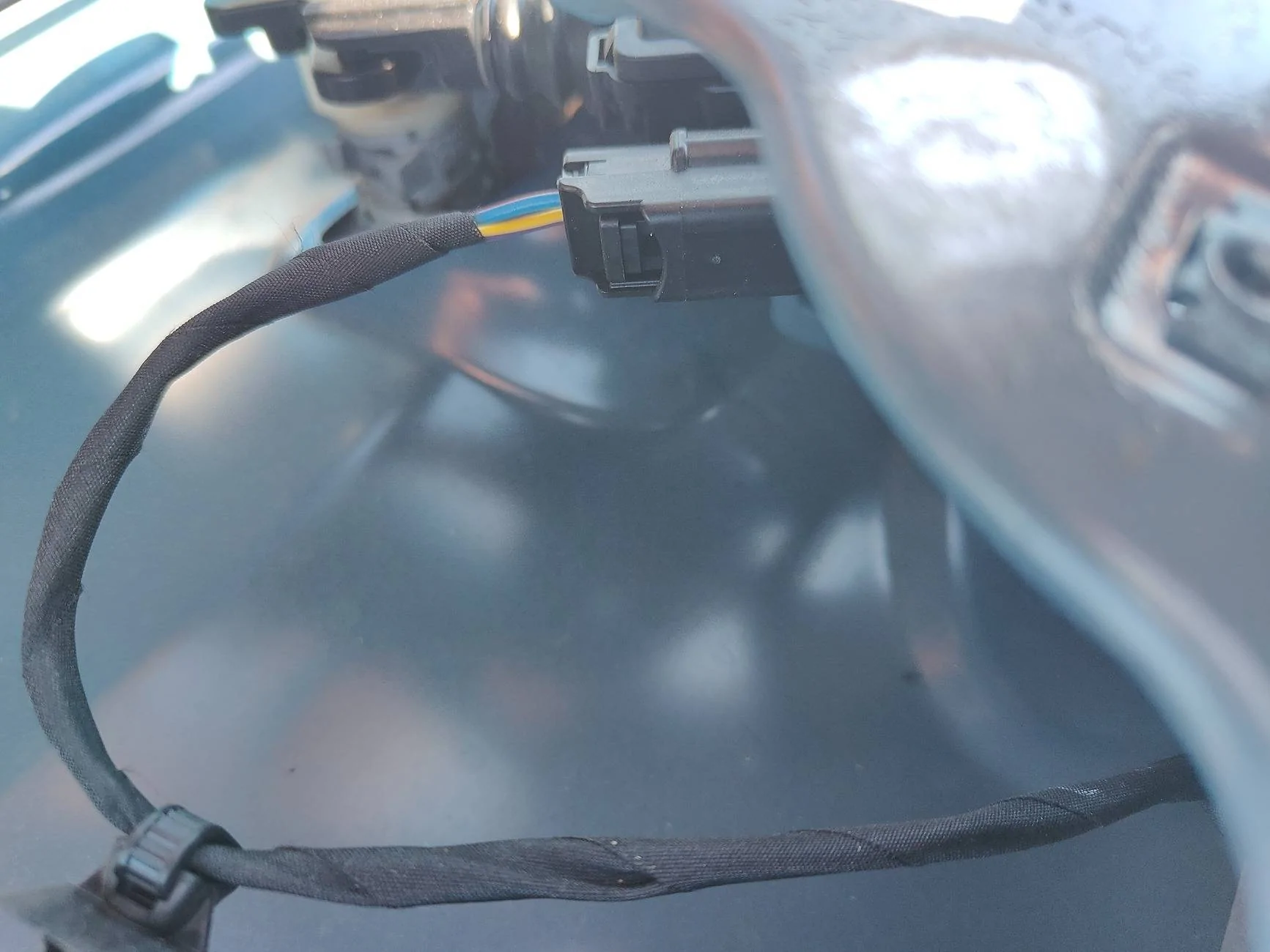

MAV248. Thanks so much. I finally installed and hooked up the tailgate electronic lock. I found a powerlock on Ali Express for $30. I made a pair of wires for the harness, which I ran from drivers side center column down to the underside of bed and up into the tailgate. I made a connection to remove tailgate if possible. Installed the actuator easily and made my own connection using small connectors and sealed with clear silicone. Everything went smoothly thanks for the pics of the wire colors.
