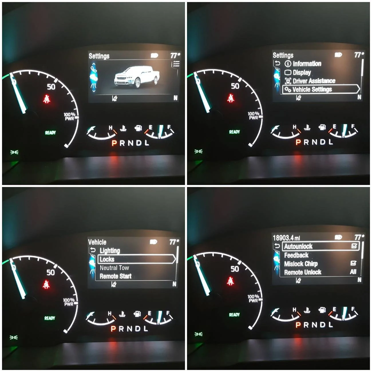

I tired of how the locks work altogether. When I come home and turn off the engine my wife gets out the passenger door and the next thing she does is knock on the backdoor window to get her newly purchased items off the back seats because the door is locked. What a hassle. Surely there must be a work around other than manually having to unlock the doors. This not user friendly.
"elmeng"
Leslie,
🤔 Do you have the Auto Unlock turned on??

No I don't, Thanks so much. I've gone to setting before but must have overlooked it. When you look at the setting Autounlock it's easy to miss the un in the Autounlock.
I'm glad I could help. 👍
