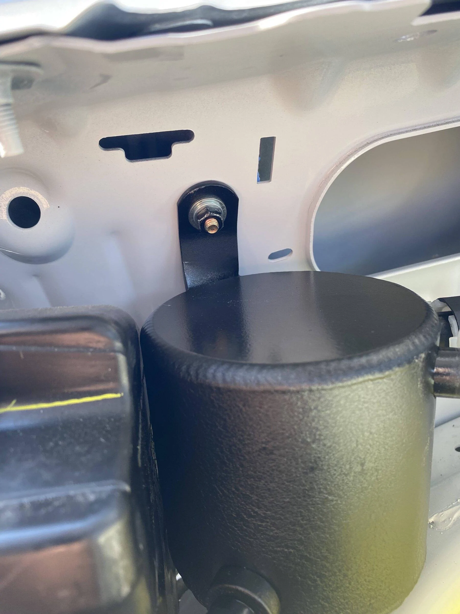

I received my catch can from Buschur's and installed it today. Install took about 30 minuted and 20 of that was making sure I did everything right.
I didn't get install instructions in the box so I had to work it out myself. It was a problem, I was just nervous about making a mistake that could have caused the truck to be undrivable for a while. This led me to double check my triple checks to make sure I did it right. If I were to install another I could be done in 10-15 minutes.
The catch can came with a bolt to fasten it to the truck but no nut. There was nowhere to screw the bolt, it was just a hole. I had to use my own washers and nut to fasten it down. Again not an issue if you have the parts laying around.

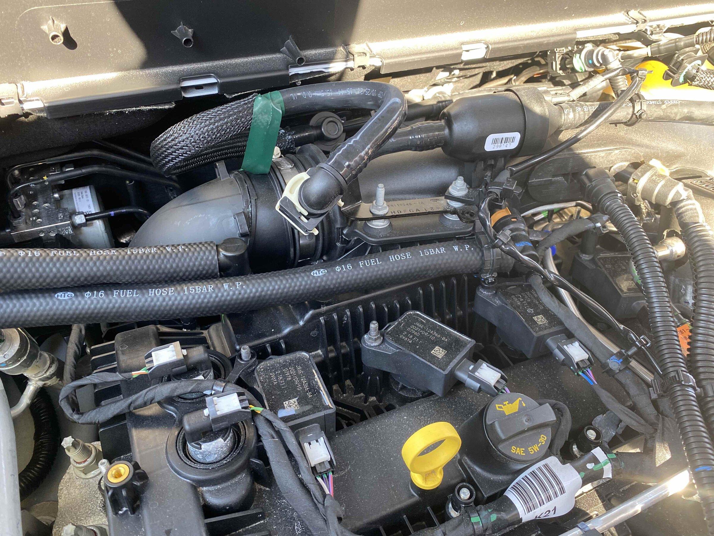

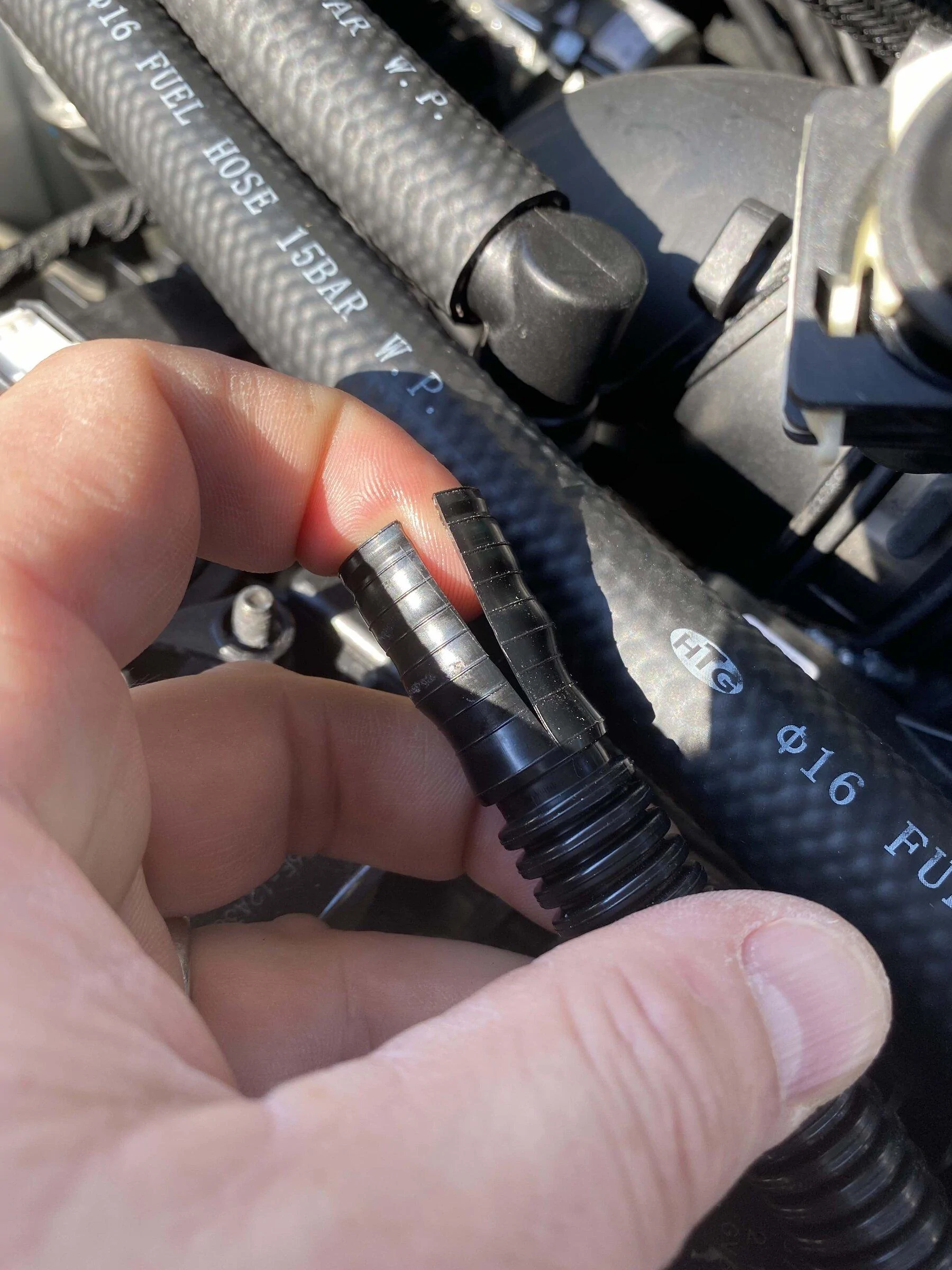

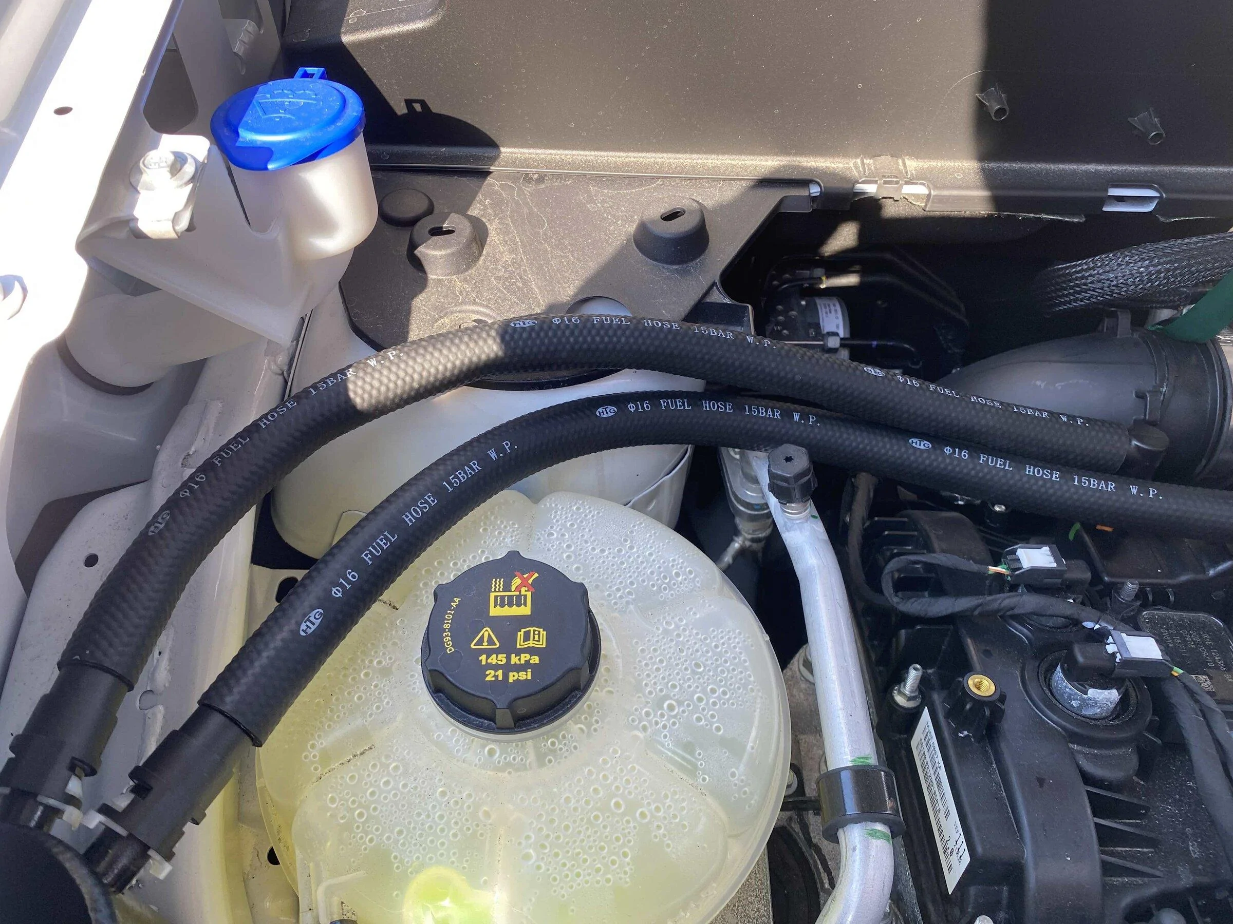

I was most nervous about cutting the existing hose as it is a Saturday and I didn't want to make a mistake that would have the truck down a long time. A razor blade right at the end got them to pop off. Be careful not to cut the o-ring underneath. The hoses that came with the catch can were the right length and didn't need trimming.

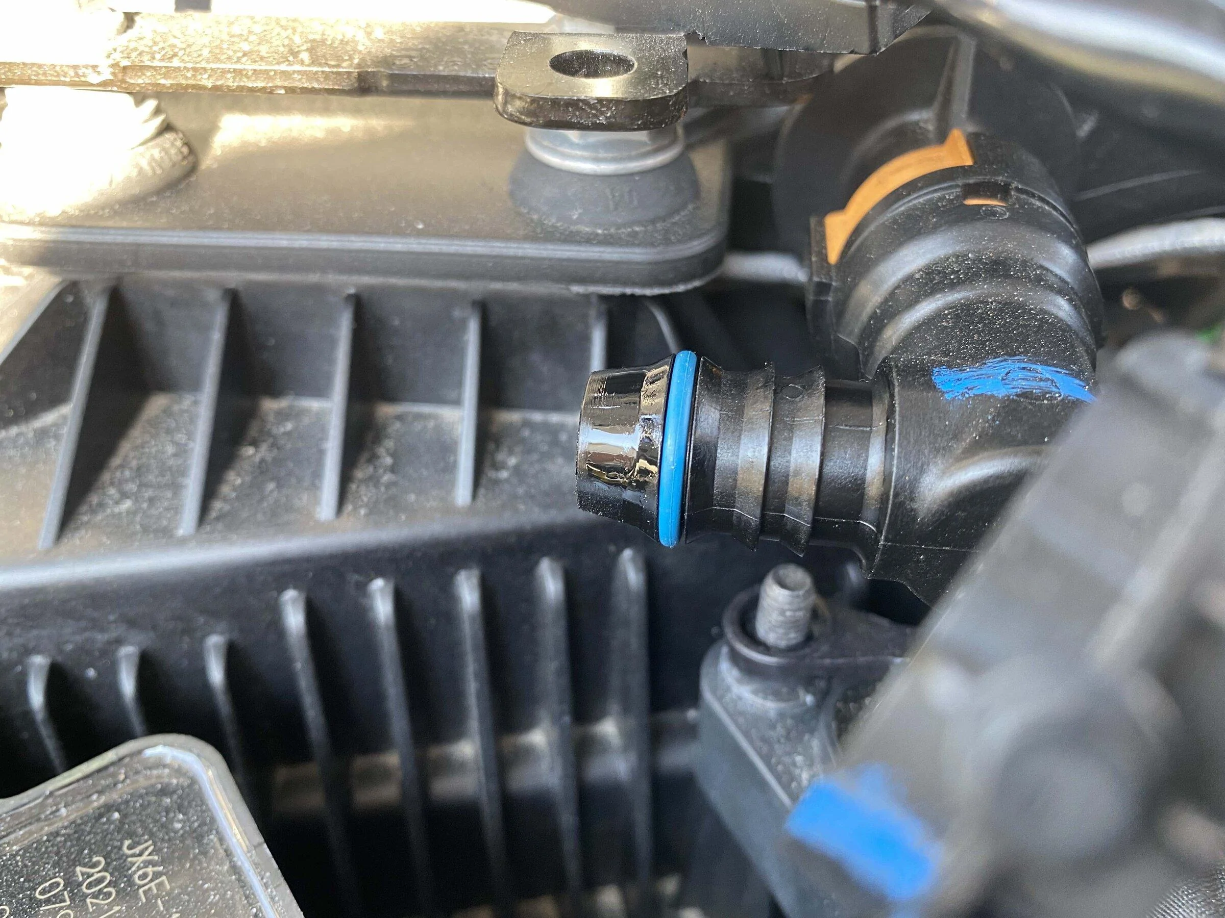

What I did notice is the existing fitting were soaking wet inside. Oily feel and a strong gas smell. One can argue whether or not it will hurt the engine, but I don't see how you could argue against it being there at all and I don't see how that is good for anything in the long run. You can see the oil and gas on it.

No. I cut mine off. I heard there is a way to get them off but it will show you did something to them. If you are worried it might be worth it to buy that part and have it to put back on if you need to go for engine work.
