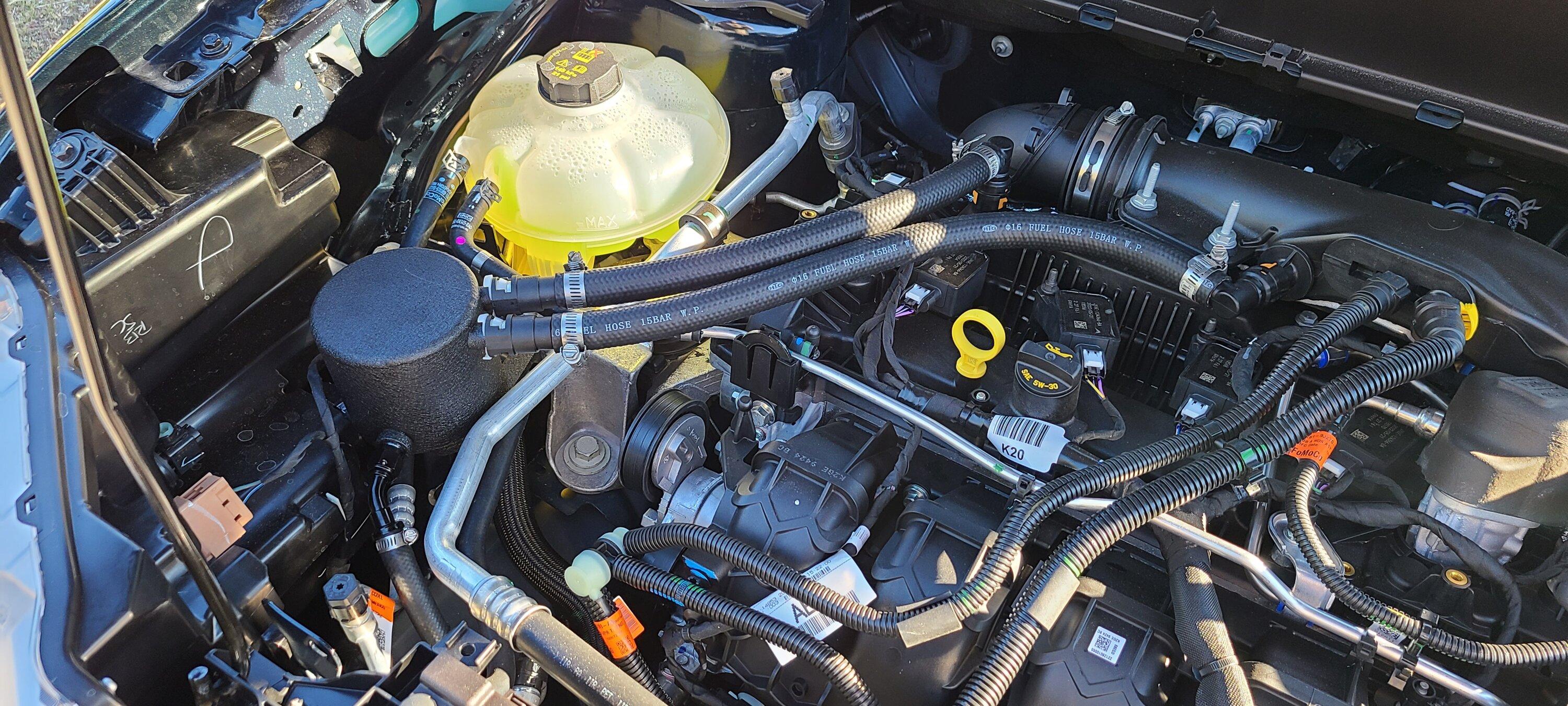

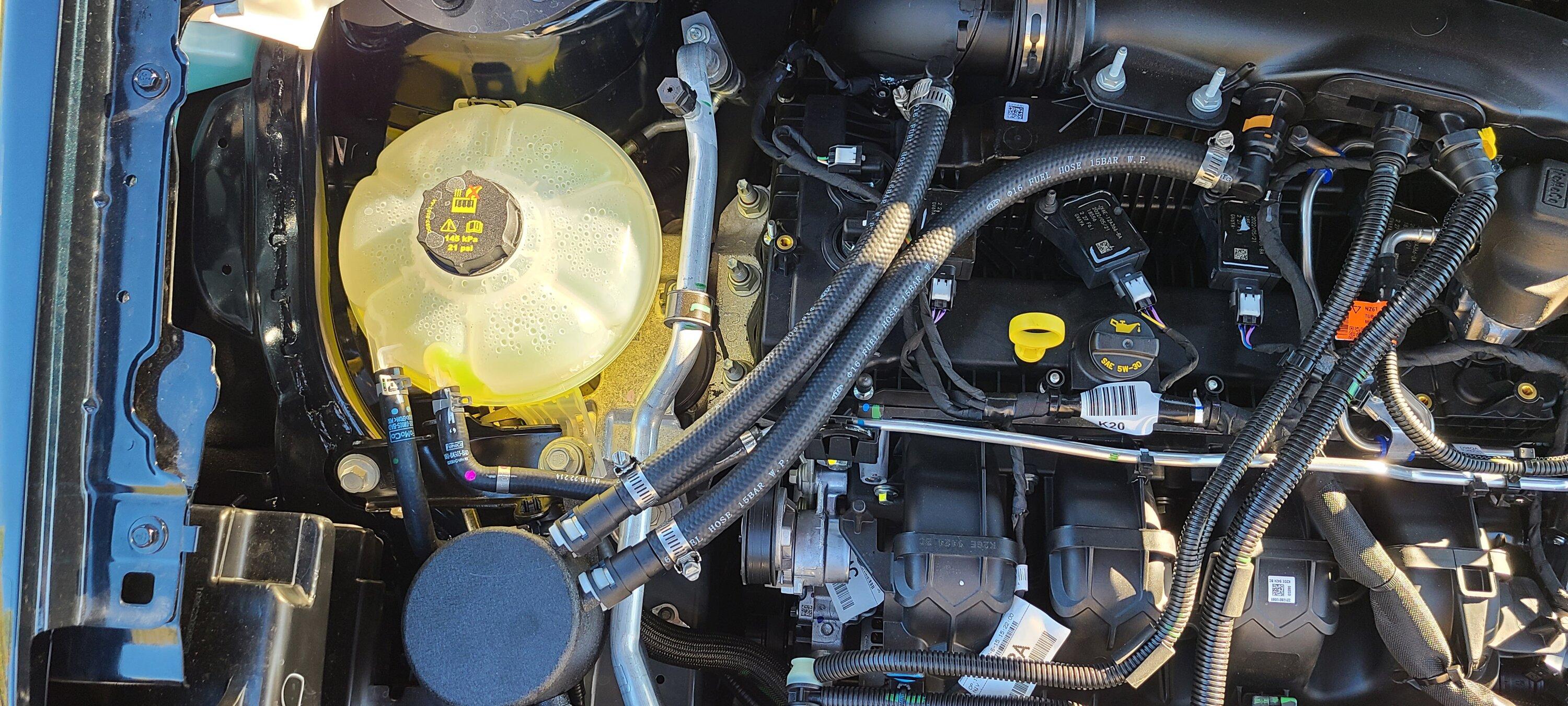

I installed the 2.0EB catch can made by Buschur on my Maverick over the weekend. Build quality of the can looks pretty good. I peeked in the fitting and verified some stainless-looking medium inside. I do like the mounting location. I ended up using standard hose clamps as a temporary solution, and am waiting on spring clamps to come in. Buschur ships with pinch clamps but I want to be able to remove the hoses easily. It was nerve wracking using a razor blade on the stock fittings, but seemed to go OK. I also put some foam padding between the can and other hoses/features to prevent rub through (no pics of that).
I'm not sure how draining it will go, as the drain hose hangs pretty low into the engine bay. I might shorten it eventually, or even remove it.
One thing I don't like is that the kit came with no pictures, no instructions, nothing. The website has a brief description of how to install it but it's pretty sparse. Even a pic on the website of the installed can would make it much easier and give us shade tree guys a little more confidence in the install.
