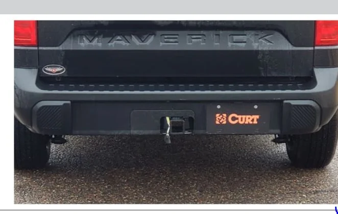

There are advantaged to both the OEM and the Curt. I found the curt easy to install and as the other poster stated the receiver comes out exactly where the OEM one does.
The Curt wiring harness is "Plug & Play". I cant speak to how easy it is to install as I used a Ford OEM wiring harness.
