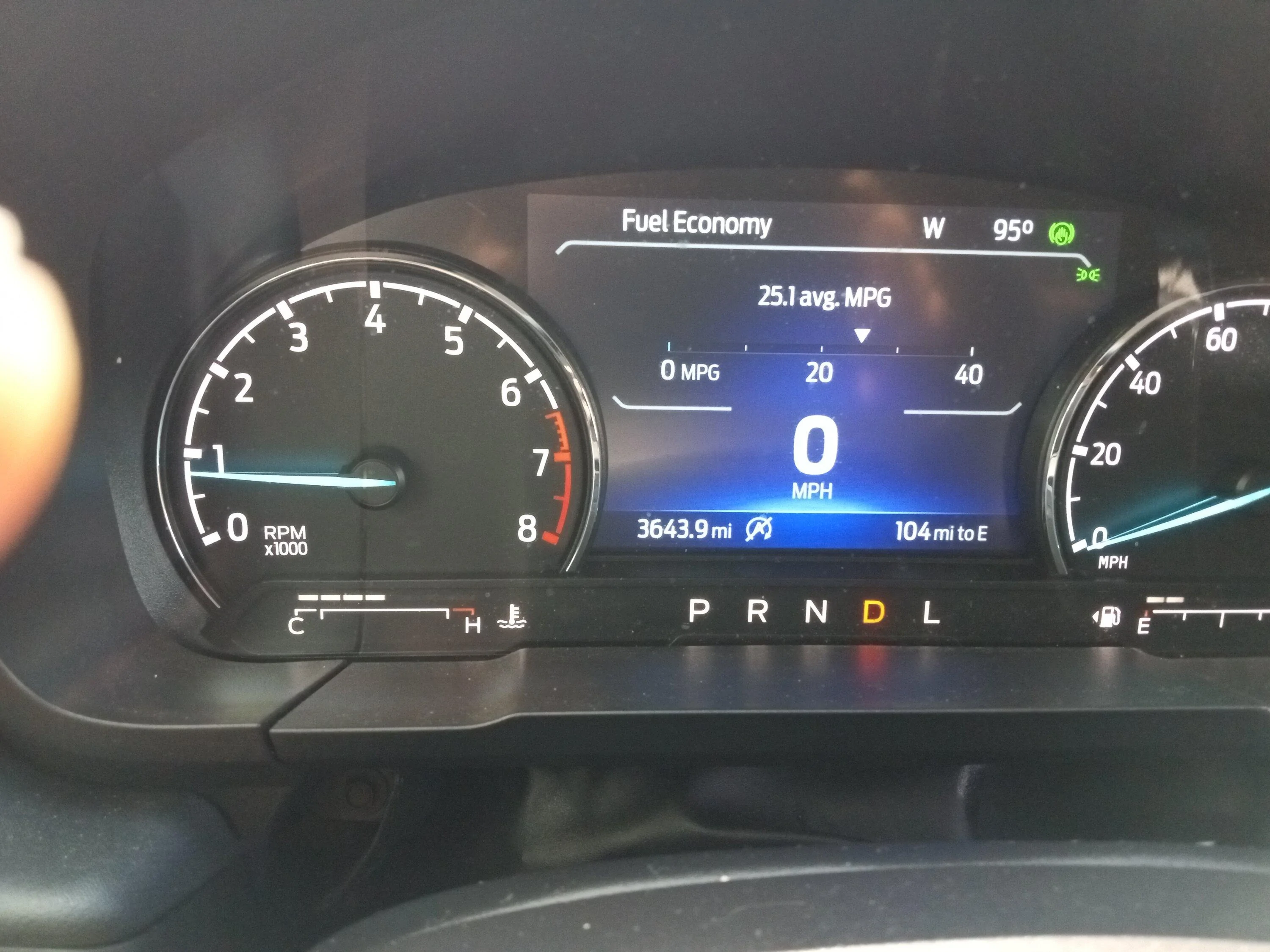

When I put Falken 235s on my Bronco Sport I lost about 1 MPG. Liked them so much I had them moved them to my 2.0 Maverick when I picked it up.
