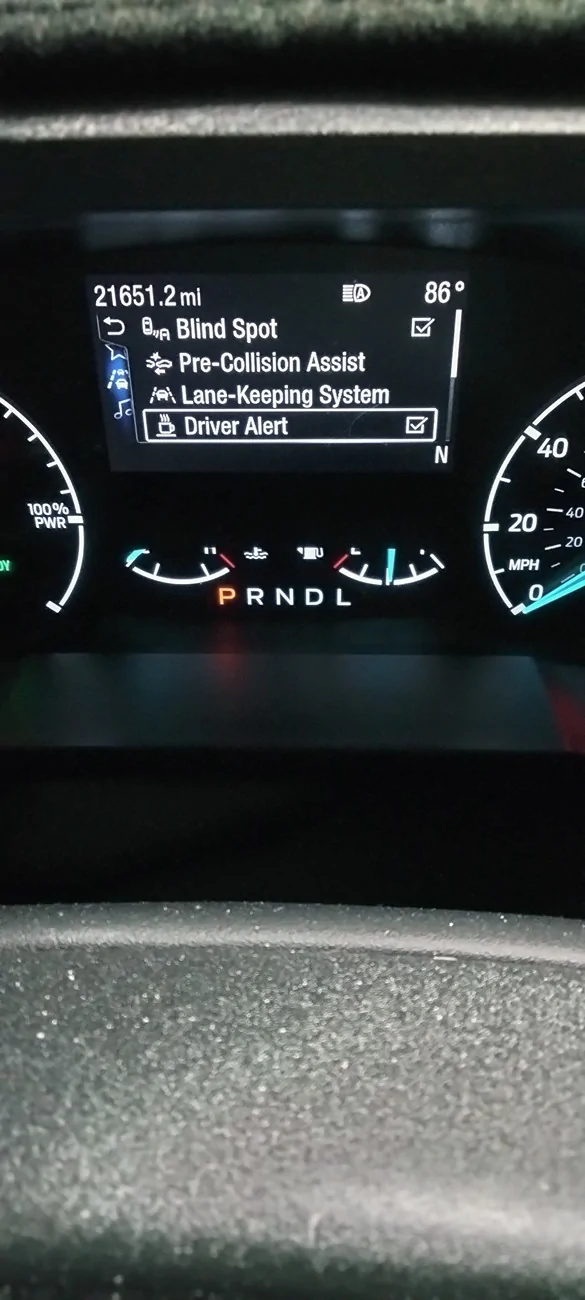

How do I keep the cruise control from kicking off when there is a vehicle in front of me, also is there a way to stop the driver needs to rest alerts that pop up?
Drive without getting too close to the lane lines. I have, I think got the message without drifting by just looking for the fan speed or other button without eyes on road. Also if in ACC cruise use the blinkers to change lanes particularly if just slowly approaching the lane line. I haven't tested the driver needs a nap warning by just closing my eyes for a few seconds, but maybe Uncle Ford is watching?
