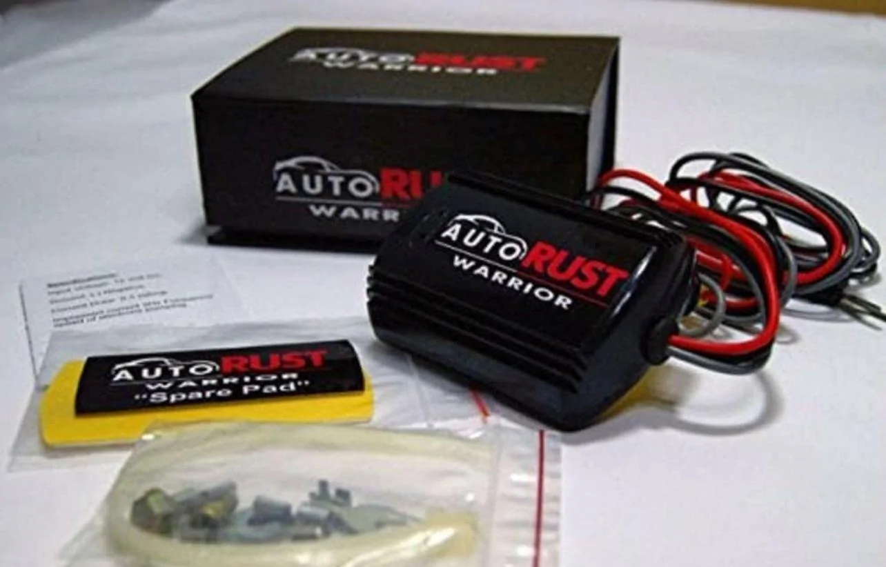

This thread convinced me to look into those electronic rust modules that I see so many people in Canada using.
Glad I read up on it before buying. There is zero proof that these do anything.
Just looked at one on Amazon. Funny that there are no reviews.
