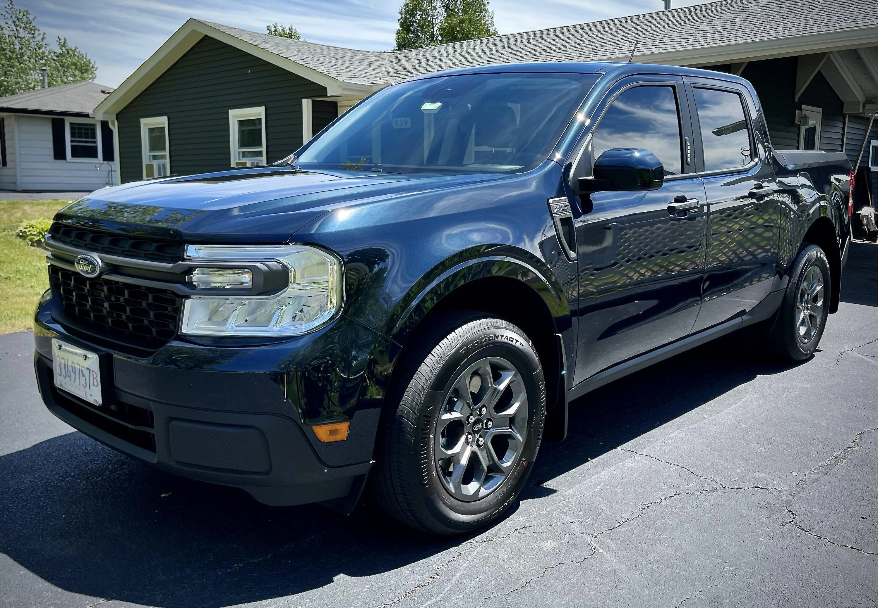

My baby just got ceramic coating; the mirror shot says it all! They took tons of photos throughout the process. The Alto Blue color changing properties are so much more obvious. Taylor does awesome work. Thank you Fine Touch Detailing! I'm not sure if it is appropriate to share, but they did such a fantastic job. Professional Auto Detailing Services at Fine Touch Detailing: Clean and Protect Your Vehicle

Booyah 👊🏽 😁 👍🏽 🇺🇸
Looking to do mine

what brand of ceramic coating did you get ?
