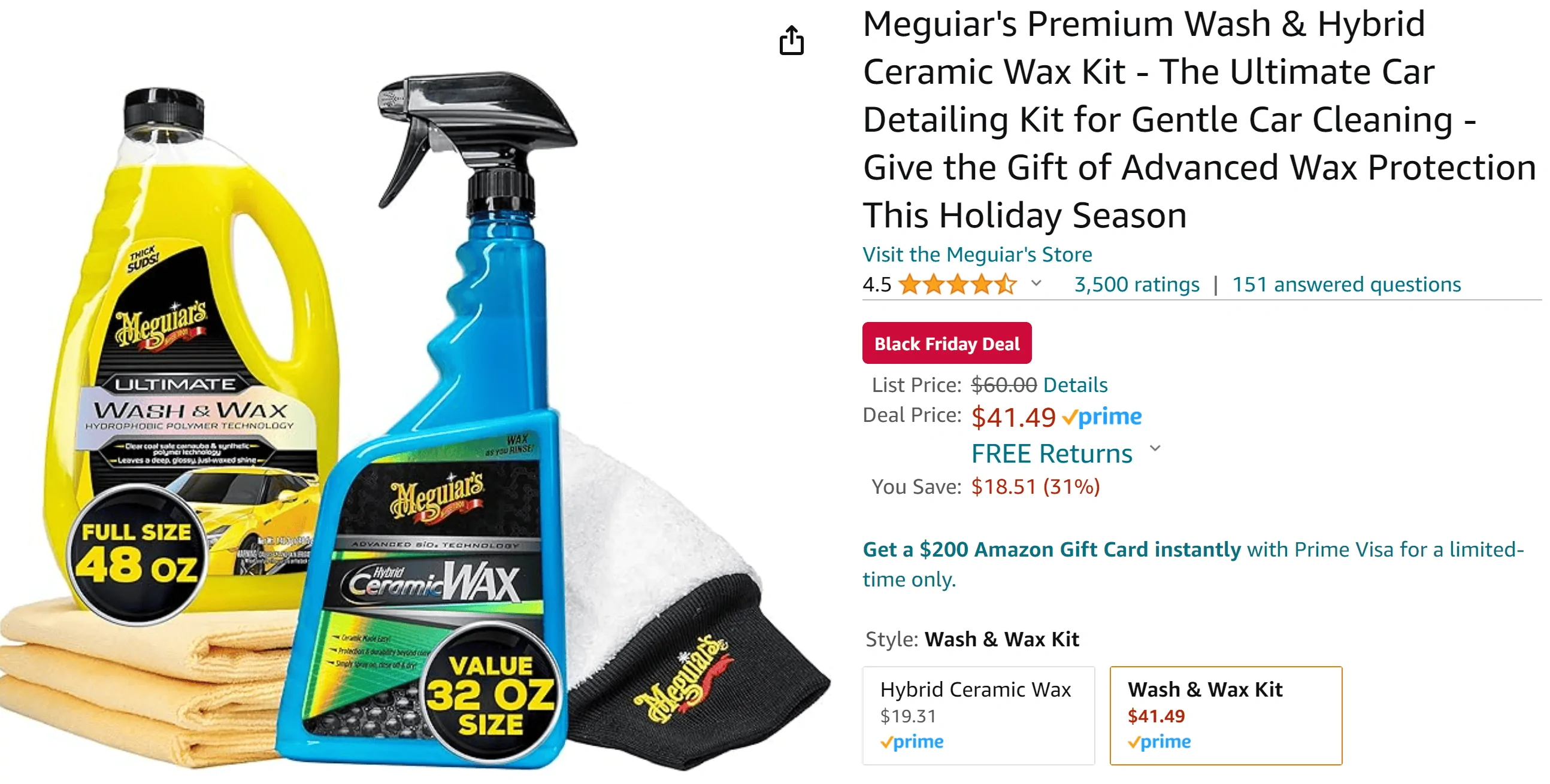

I have been using this product since I got my Mav. I use it once every 2 month. Just spray it on and rinse it of !! First time you have to do it twice. You also must use the yellow stuff to wash the car. Both products work together. Only for hand wash.
Ford Maverick What a mess I made of my truck using Adams Graphene Ceramic Coating 1700837334059
Ford Maverick What a mess I made of my truck using Adams Graphene Ceramic Coating 1700837457586
Hope this helps !!

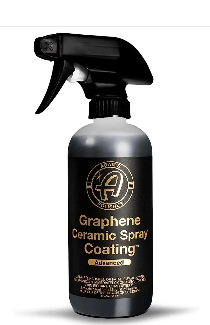

If you use what OP used (or Cerakote or similar - not a commercial product applied in a shop), you do a small area at a time and wipe it off right after applying it. Then buff it immediately. The wiping/buffing requires much less effort and IMO, faster than old-school wax. But the real advantage of Cerakote, etc. is, the shine and dirt/water repellent properties last so much longer than wax. It's like coating your truck with Teflon or similar non-stick coating.
If you previously used another product on the paint, you should first strip that, like others have mentioned.
The adam's spray ceramic is in a completely different class than the cerakote stuff. The cerakote is nowhere near as good. Adam's spray is a step below a real ceramic coating and a step above the cerakote type stuff. I've tried both, threw out the cerakote and kept using the Adam's - it was that much better. It works so well precisely because it's hard to remove - it's durable. But you do need to take great care in prep and application. And it will periodically have to be stripped and re-done.

Haven't had any issues with the exact same Adams Graphene Advanced on mine. It did the rainbow effect, buffed off super easy, and still looks great months later. I waterless wash with their CS3 to touch it up, as it also leaves some graphene/ceramic behind.
That said, I had a HORRIBLE experience with Turtle Wax Hybrid Solutions Graphene. It left streaks, all over the truck that would not buff out with microfiber cloths. I finally grabbed a non-abrasive cleaner wax, an old can of Liquid Glass, which took the streaks right off.
With Ceramic coatings, and their Graphene is a ceramic coating, the paint needs to be truly clean. I think many of the issues are the dealers don't properly prop the vehicles off the hauler, and there is invisible residue left behind from the protective sheets on the hood. My streaking was 95% on the hood and roof, right where that stuff is usually applied, along with rain spots, visible when wet or at the right angle.
If using a product like that, use the prep spray, or a water spot remover, to thoroughly pre-clean the vehicle, then wipe with alcohol mix or something to remove any remnants of the cleaner.
