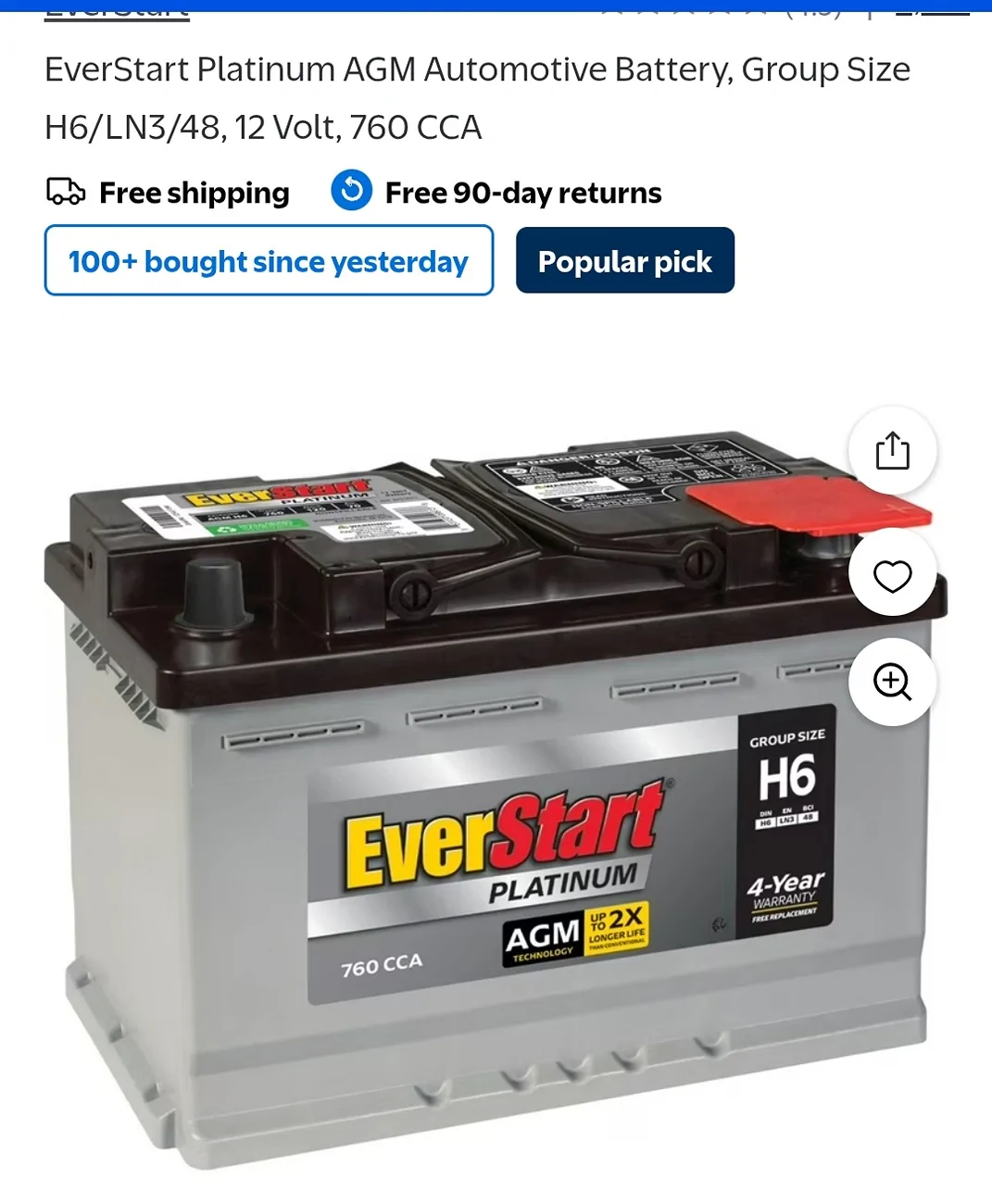

Why an AGM over a Lead Acid battery ?
An AGM battery actually is a lead acid battery.
Its electrolyte is in a gel form contained in an Absorbed Glass Mat, thus the (AGM) moniker. .
That differentiates it from the more frequently encountered flooded lead acid (FLA) battery you were likely referring to.
I agree they are a better choice for the reasons you noted, but AGMs also don't need to have water added and they don't cause terminal corrosion and are not prone to acid leakage like the FLAs.
Yeah I saw that in the third paragraph, I copied only the second one.
AGM’s are IMO worth the extra cost.
No outgassing like the flooded that used to make a mess in your battery tray.
