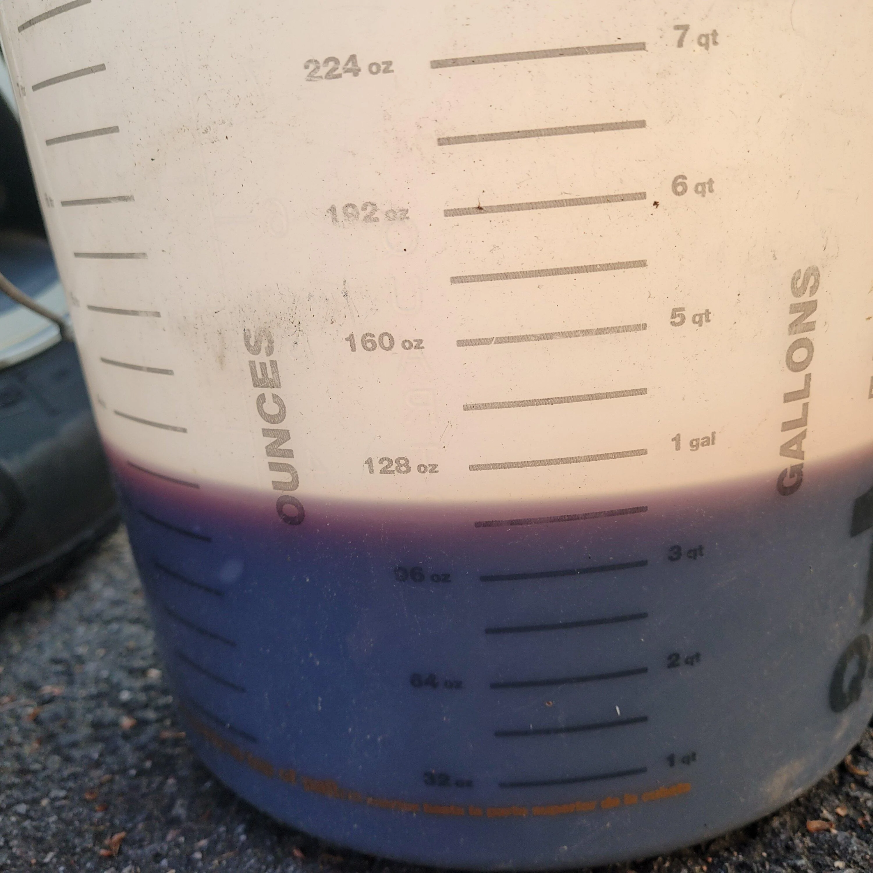

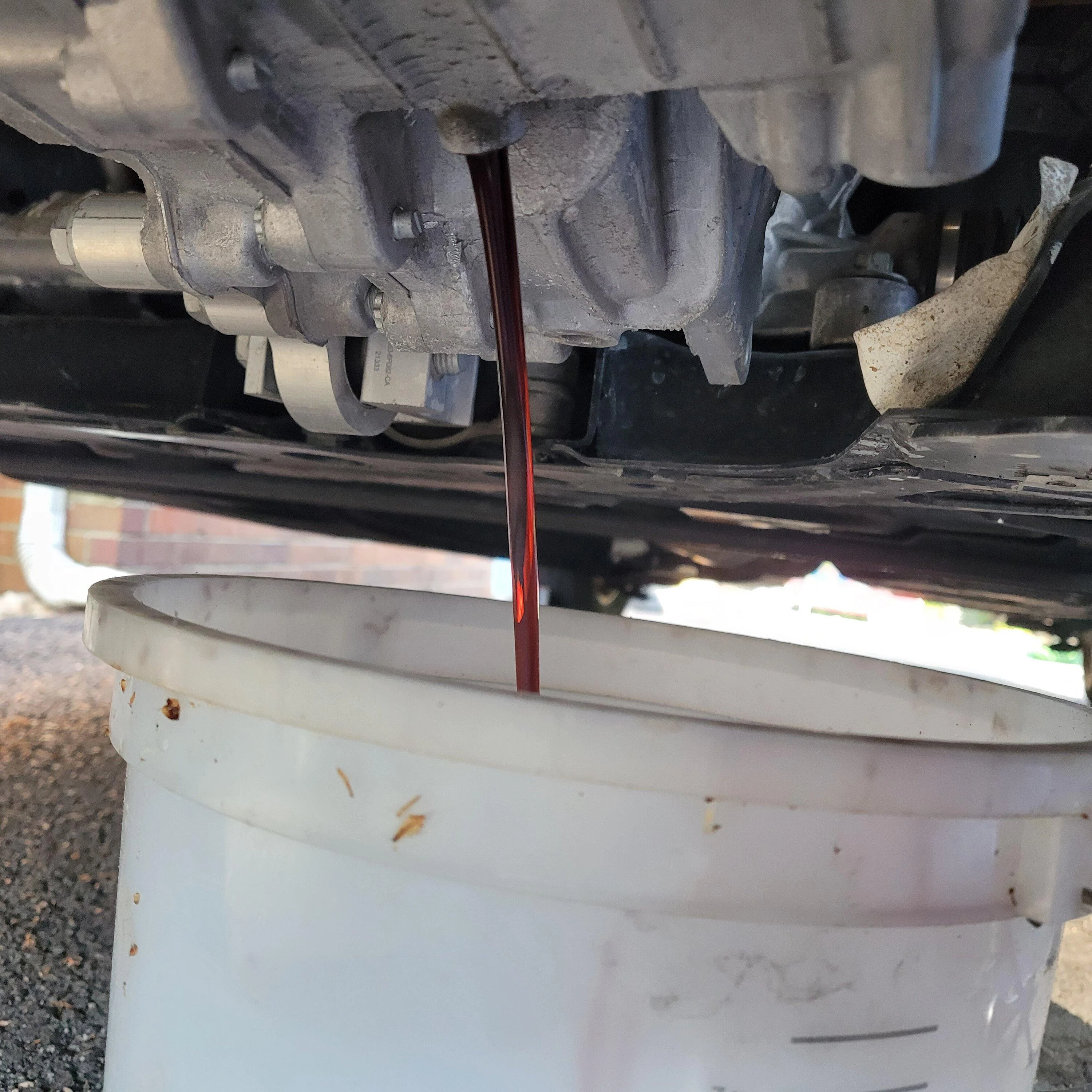

At 61K miles I decided to do a drain and fill. I watched this video.
Guy in the video said he drained about 7 quarts out so I went and got 7 quarts of QULV at the dealer but only used 3 quarts and 24 oz before fluid started dripping out of the fill hole. So, does the eCVT have nooks and crannies like the traditional trannies where fluid hides?
Anyway, here are some pics.
Old and new fluid.

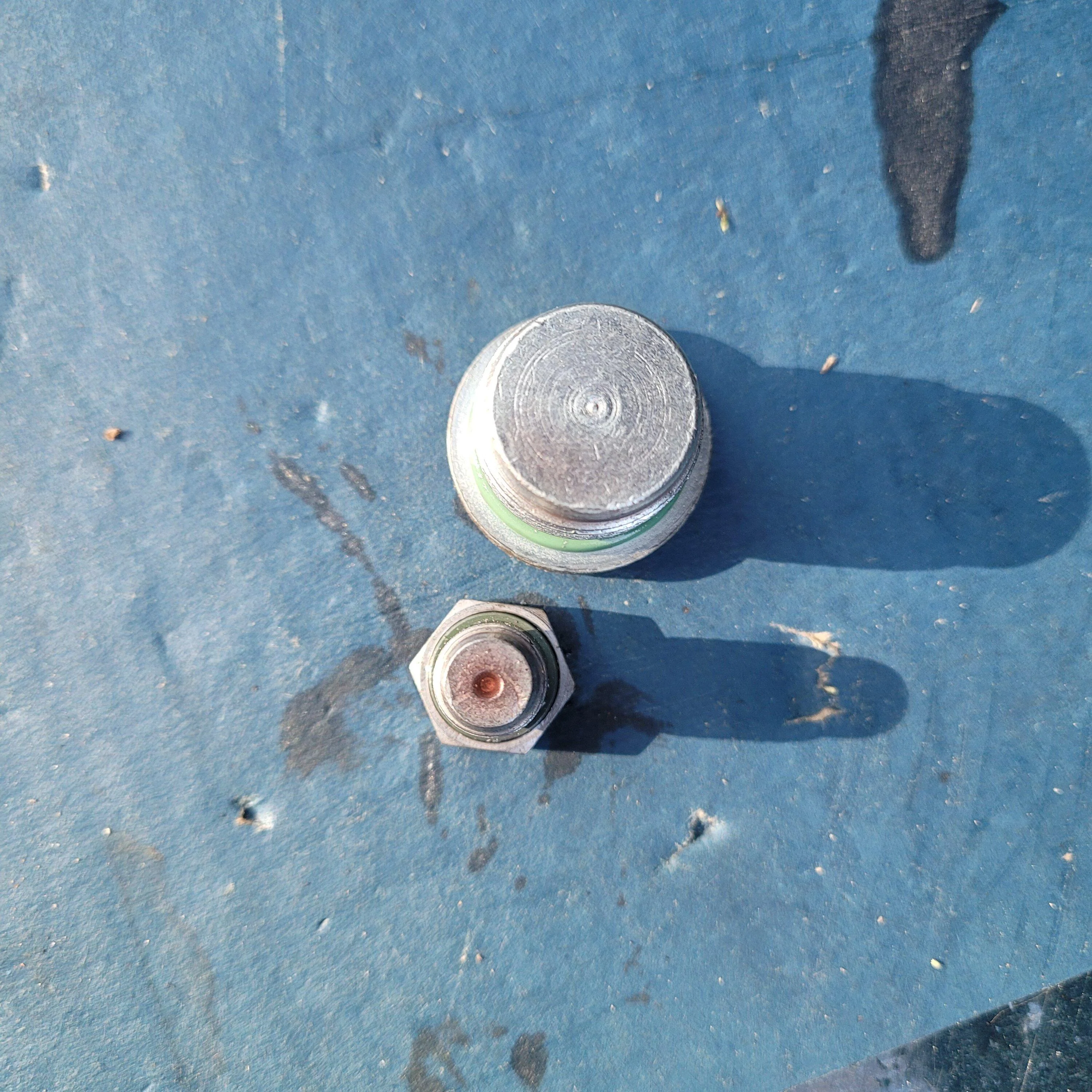

Drain and fill plugs. No particles on the drain plug.

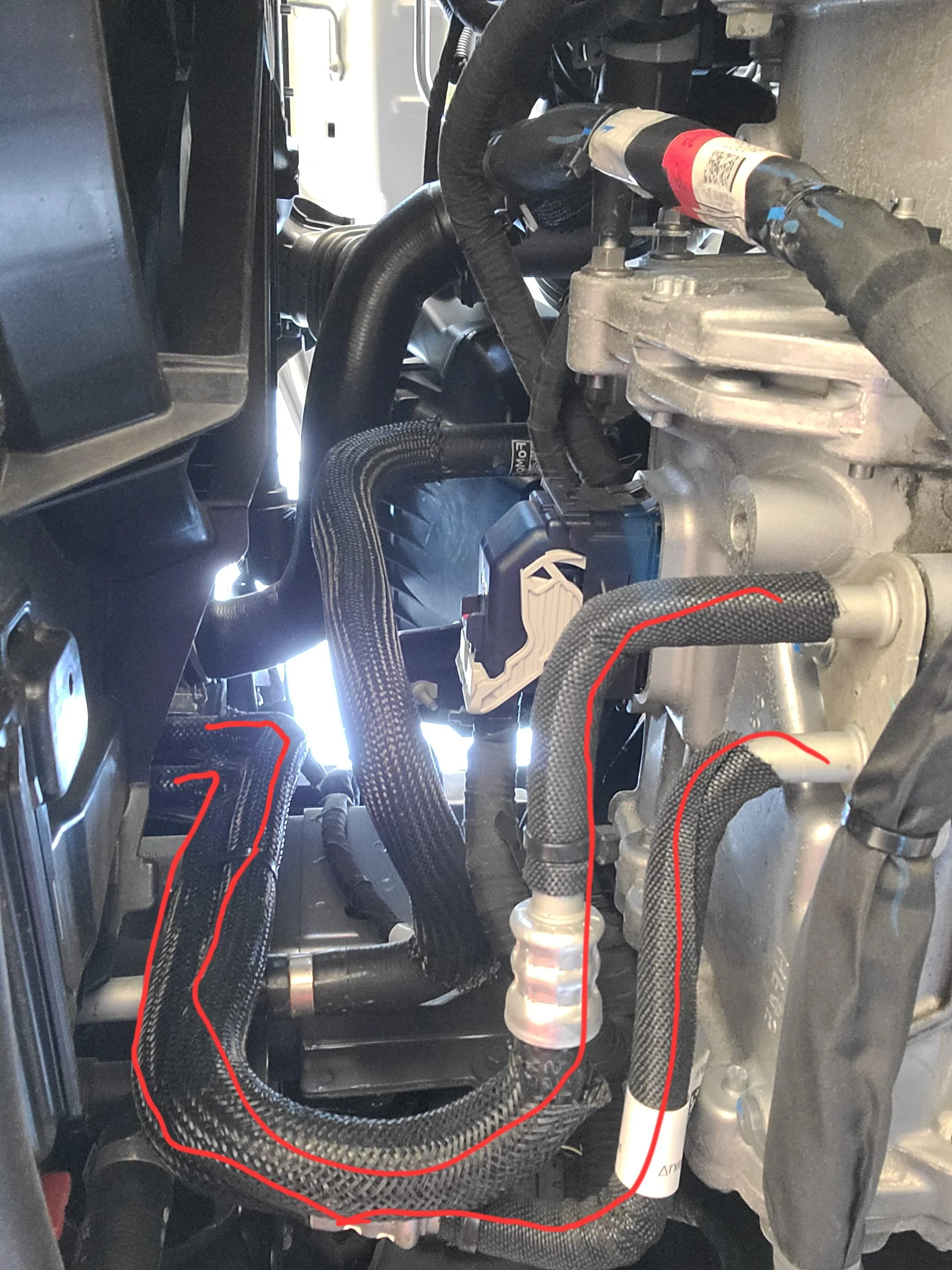

Also it appears the fluid is cooled in the radiator.
Old fluid
Hey there bobboy. I see the fluid drain in pic. Did you use the same hole to fill the tranny fluid with once the old leaves? Or is that a bad idea? If not where did you fill the tranny fluid at?
Did you use a hand pump to fill the tranny with the new fluid?
Fill plug and drain plug are here.
https://www.mavericktruckclub.com/f...-when-received-new-maverick.24064/post-464626
The fill plug is accessible in the driver's side wheel well
I used this pump.
https://a.co/d/cho0nBi
