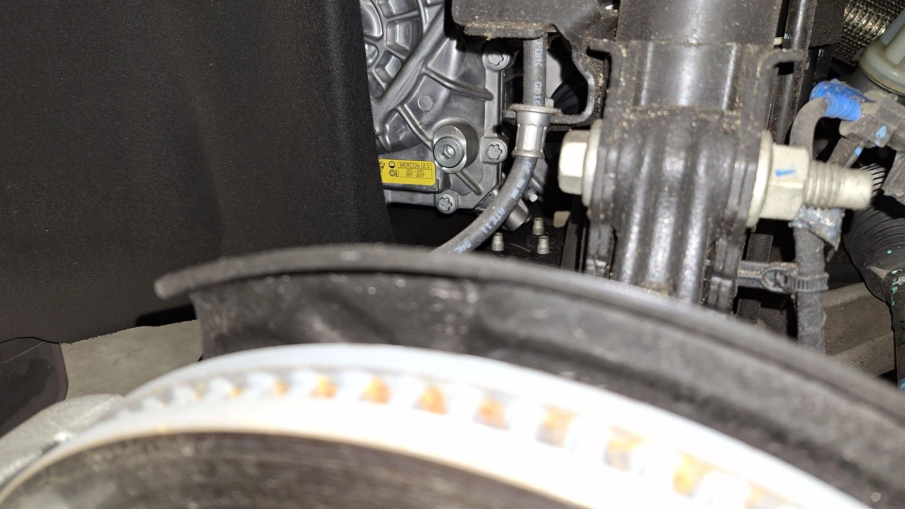

Thanks for the pictures @BoboysTruck - I was wondering where the fill plug came from. Turns out it's in the drivers (left) wheel well. Found it while swapping out to winter tires.
Any idea what the temperature range listed on the sticker is for? Shows 20C to 93C. Seems like what the temperatures should be for a level check after refill - aka not in the middle of winter but a summer job.
