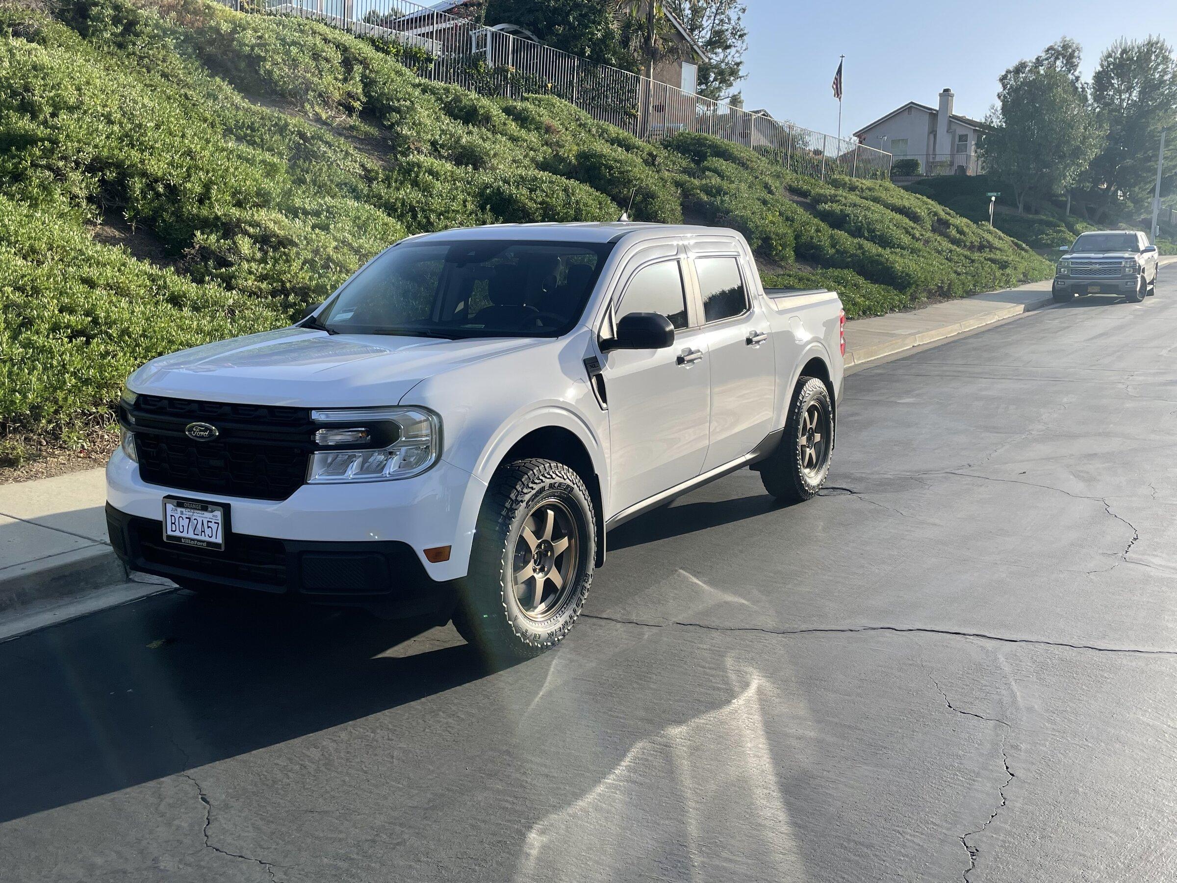

245/70/17 falken wild peak at3w, cant break past 30mpg in the city...i was willing to take a 1-2 mpg hit but 12? whaaaaaat
Highway driving is about right, im getting 31 mpg when cruising along at 65-75mph.
That's a pretty heavy /wide'ish tire - Just saying. No rubbing ?

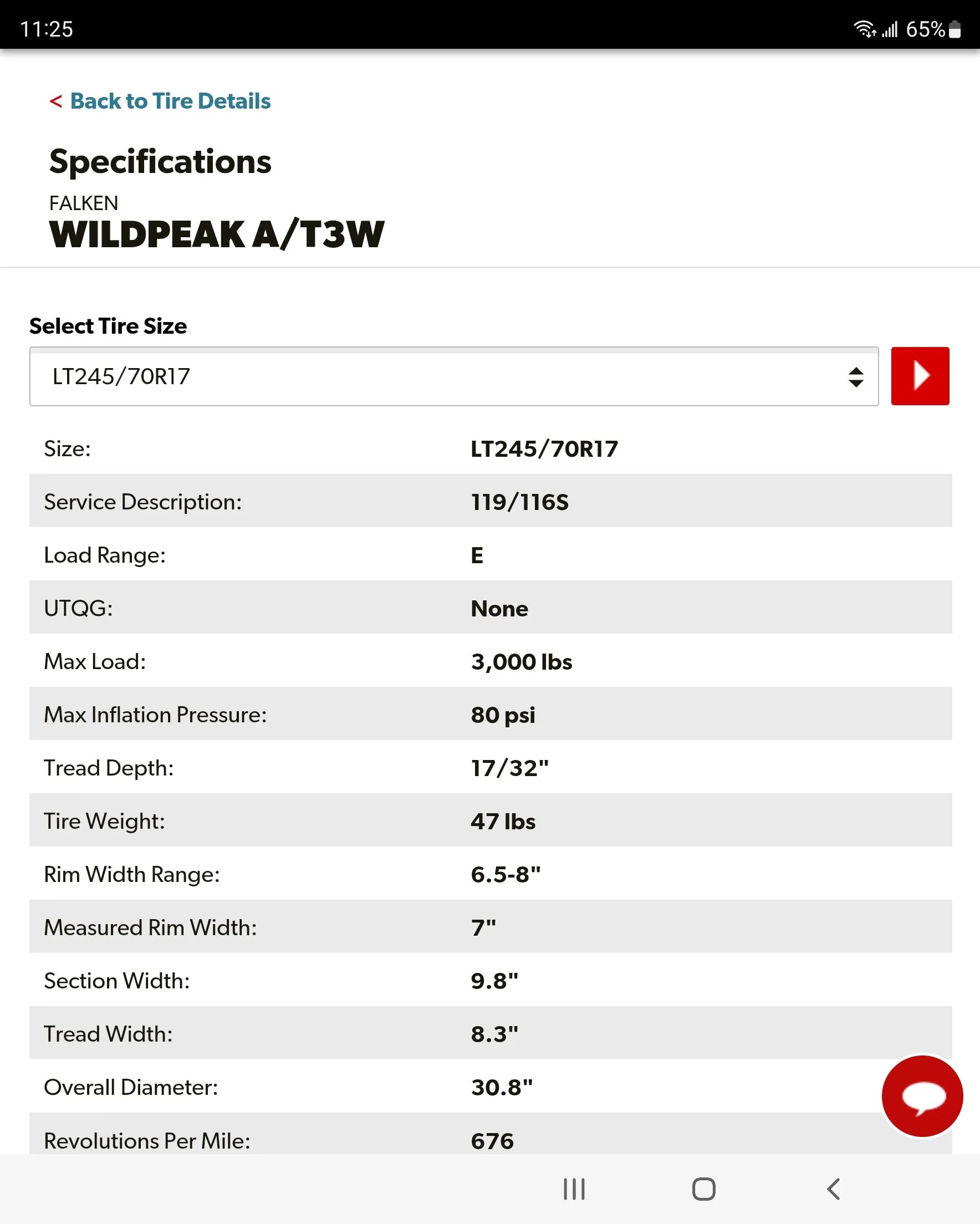

I think your tire is actually 47 LBS -
No. You showed a 245, the tire I am getting is a 225 which is OEM size. I have no such need for such a larger tire on a 2 wheel drive vehicle. Cheers.

Another member said they got 245/70 and that tire is 47 lbs - I would not do that but ok -)

Yes, it is my understanding the 245 is 47 pounds. That is what the other member stated and it sounds like a great fit for (s)he. I think for me, the 31 pound 225 is a great fit for me. Cheers.

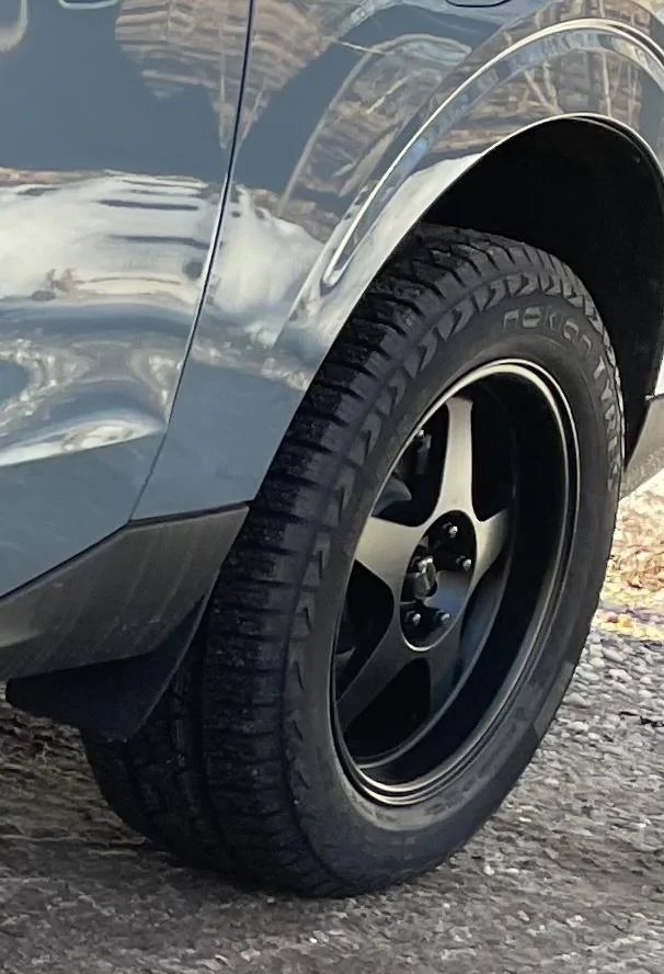

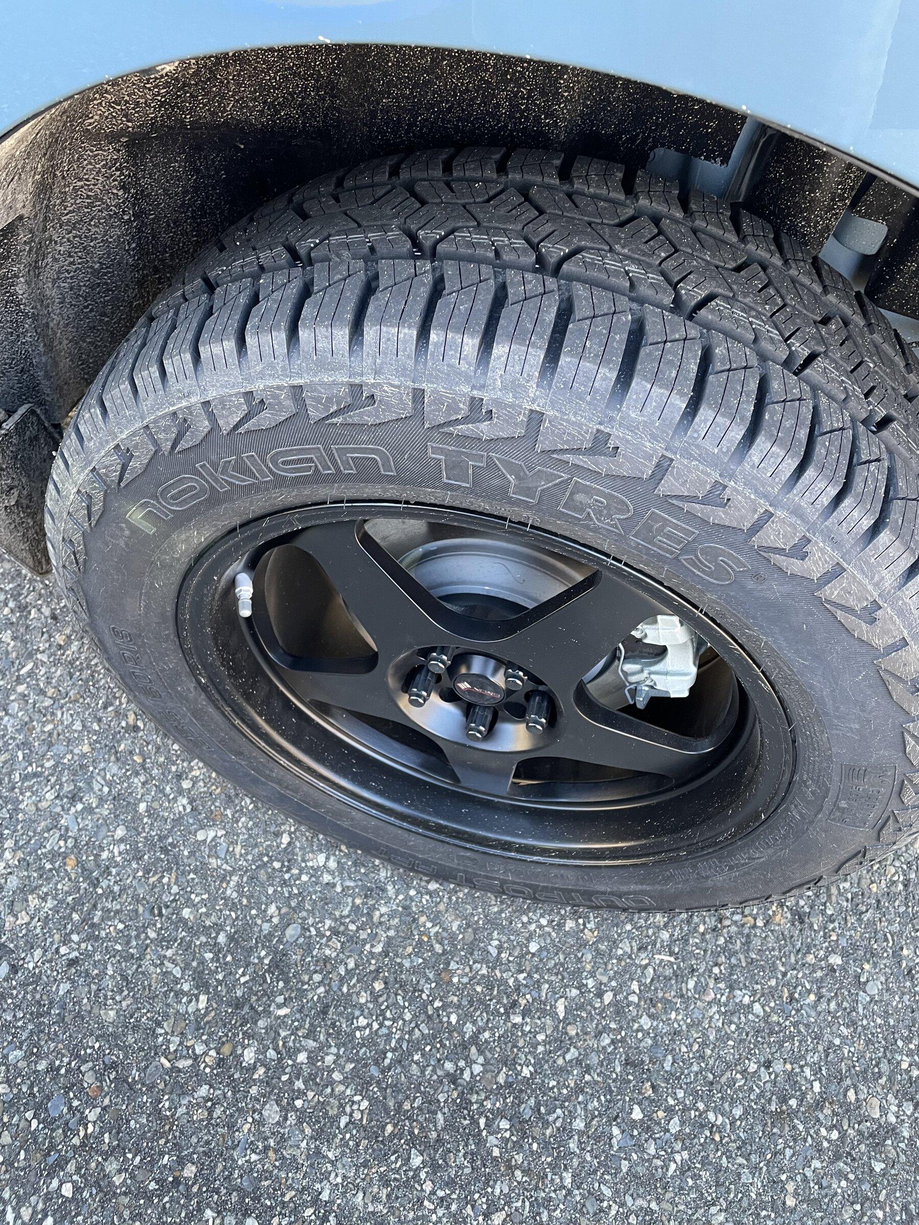

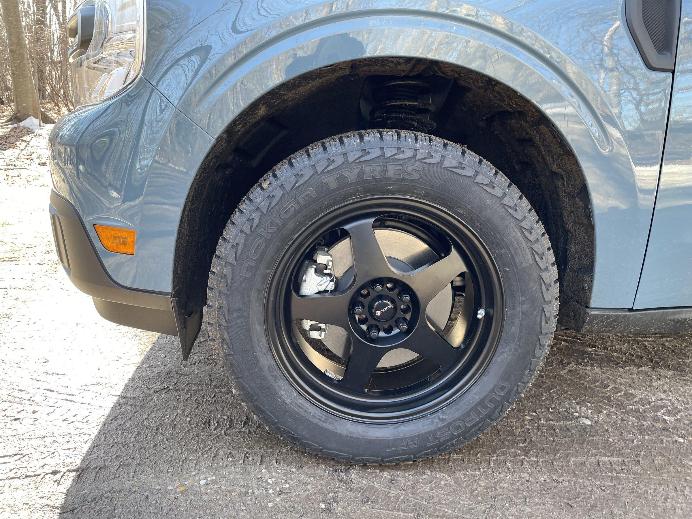

I drove 1/2 a tank in eco mode and was able to get 47mpg over those 2 weeks.
235/60/18 Nokian Outpost ATP. They’re all weather and low rolling resistance rated.
I’ve since gone back to driving in sport mode and am still averaging 35-40mpg.
