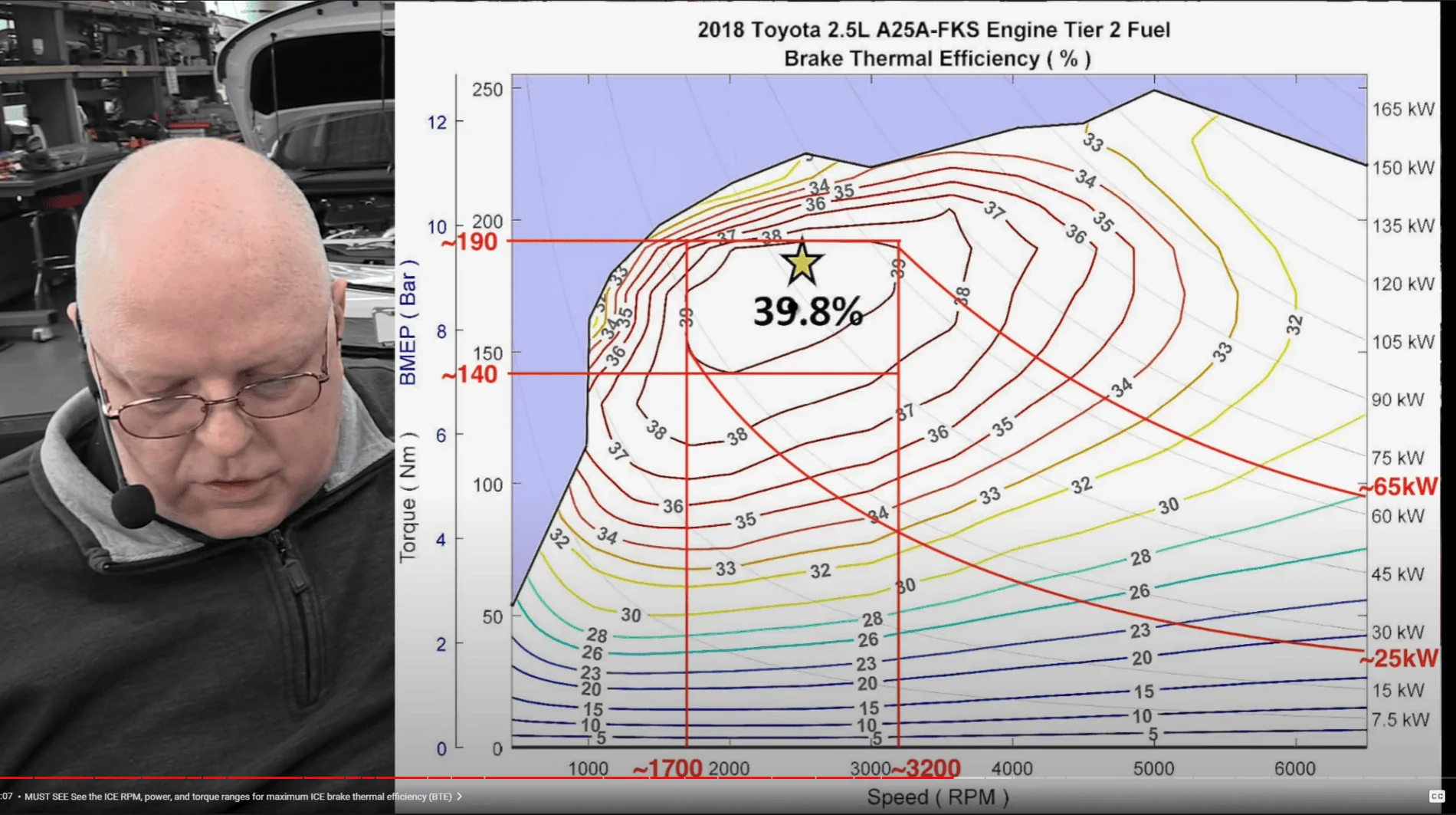

The 155 lb-ft of torque is just for the ICE. I think I have heard it's at least around 177 with the electric motor.
Here's something I hadn't thought about. ICEs get their peak torque and horsepower at a particular RPM. The peaks can be broad, and with lots of gears and smooth shifts, you can stay near there. But can the hybrid, with the eCVT, theoretically, be at peak torque or horsepower any time you want?
For example, an electric motor can supply smooth torque at zero RPM. An ICE can only do that by slipping the clutch.
If someone knows, please jump in.
The way Ford has made the ECVT, is that the engine is usually running at either optimal MPG range (~1200-1800RPM), optimal torque (2k RPM best fuel figures), optimal engine HP (with best fuel economy figures ~4-4.4k RPM), or peak HP (7k RPM, worst fuel figures).
The CVT of my Subaru is tied to the throttle, allowing the engine RPM to rise or fall depending on throttle position.
The eCVT of the Ford Fusion usually keeps the engine at those above mentioned RPM ranges, usually making the engine near to quiet, and using the generator to adjust the gear ratio (there are infinite amount of gear ratios).
So the engine RPM remains constant, the generator is recapturing some of that engine power, and storing it into battery, or sending it out to the asynchronous motor to aid in acceleration.
Thus the only 2 variables are the wheel output, and the generator speed.
On most gasoline engines, peak torque is a little earlier than peak HP;
Giving a generic example here:
Eg: peak torque is at 2400-3800RPM, vs 6500RPM for peak HP.
Shifting the engine past it's 6,5k RPM, will allow it to run at lower HP figures (too much internal resistance), but usually the redline isn't until 7,5k RPM; this due to the fact that while the engine makes less power at 7,5k RPM than at 6,5k RPM, but running a lower gear ratio allows the car to run more torque at that 7,5k RPM than at 6,5k RPM.
As far as shifting between peak torque and HP, on my subaru, it's just knowing where to hold the throttle at. As far as the Ford Fusion, it's similar. Holding the throttle at a specific place, while the electronics basically do half of the work.
If you need more than optimal TQ/HP, the electric motor will give a boost.
If you need less, the generator will tap off some of that power, or the engine will fall into a lower RPM category, using the motor to aid it's lower output.
As far as a FFH with eCVT from a stand still, the engine does need to rev up to the right RPM range, before it can give you optimal TQ or HP.
Initially the generator will either tap power from the engine, charging the battery, allowing the wheels to stand still while the engine is running, using the electric motor to do the start from stop (powered by the generator, which is powered by the engine).
Or, at higher speeds, the clutch closes, and the engine output will be more directly linked to the output shaft (with just the generator/motor adjusting the gear ratios).
Two things that may be relevant
1. You seem like you probably can interpret this better than I can and it seems like it backs up what you're saying: the optimal combustion efficiency range might be similar in the Ford eCVT. If we look at the Rav4 hybrid video from John Kelly it shows this diagram, showing an EPA study of the 2.5L engine used in some Toyota models, which I can only guess is going to be pretty similar to the 2.5L Duratech atkinson engine in the Maverick:
Ford Maverick Hybrid engine performance question 1636327707523
2. I'm not sure what you mean by "the clutch closes" at higher speeds. There is a torque-limiting clutch and vibration dampener but it *always* connected, unless it's slips due to some error in too much torque?
