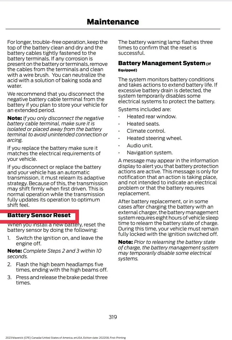

Let it optimize if you can, it helps keep the battery healthy, it just takes a while. If you connected the NOCO clamps to the battery terminals then you might need to do the manual BMS reset. As @icegradner said you can connect the negative clamp to the body or outside of the block sensor on the negative terminal and the BMS should detect the charge. Wouldn't hurt to reset it.

I put a Noco G3500 (3.5A charger, now replaced by the Genius5) on the underhood terminal when I expect my Mav hybrid to be sitting more than a few days. It charges up and enters maintenance mode like yours, but any activity that consumes power will kick it back into charging mode. All you have to do is open a door, even if the dome light is off. I believe that the EPA-mandated self-testing done periodically while parked (clicking noises) will restart the charger too. So... if you check the status of your charger, it's a crap shoot whether you will see the end-stage or still-charging state since you don't know what's been happening recently on the load side. No action is needed by you; the BMS is aware of the charger. You only need to reset the BMS when you replace the battery.

Maybe on the better charge. But be sure to NOT connect the charger negative to the battery post. It has to have the BMS between the negative battery terminal and the charger negative so that the BMS can keep track of the charging current.
