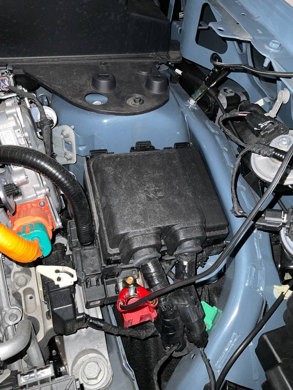

I have just connected my 2A trickle charger via the posts under the hood. Pic below. My question is why does this method require resetting the BMS? Are these points not “before“ the sensor attached on the battery post that’s under the rear seat?

Honestly I think a lot of people are too fussy about the BMS, especially on the charging side. If anything the BMS would think the battery is undercharged and just try to charge it more.
