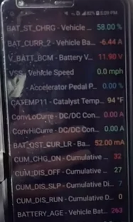

Start of drive - 58% SOC, 11.9 V (day before was 65% SOC after 4 hr drive)
I noticed I must have had a drain event prior night, charge 32 Ah, discharge 34 Ah, even with some rounding errors - usually closer than that - that causes willingness to do high charging Amps.

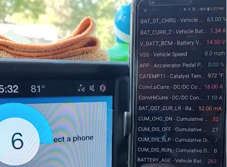

20 min drive home, higher than normal float charge 1.34A at this point - 63% SOC.
Fan speed 6, no headlights, no brake pedal with those lights (which is 8-9A draw too).
Note DCDC Converter Low Current - 16A, or 17A actually.

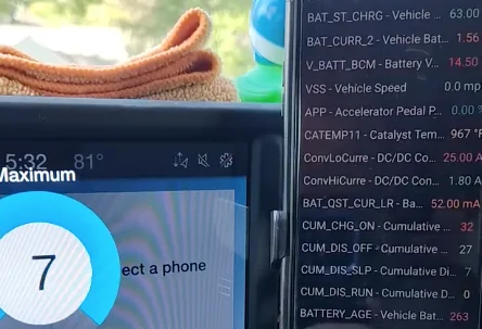

Fan @ 7 really Amps it up - 25A. Normal battery current fluctuations up/down.

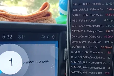

Back to fan speed 1. No improvement to battery current during that test.

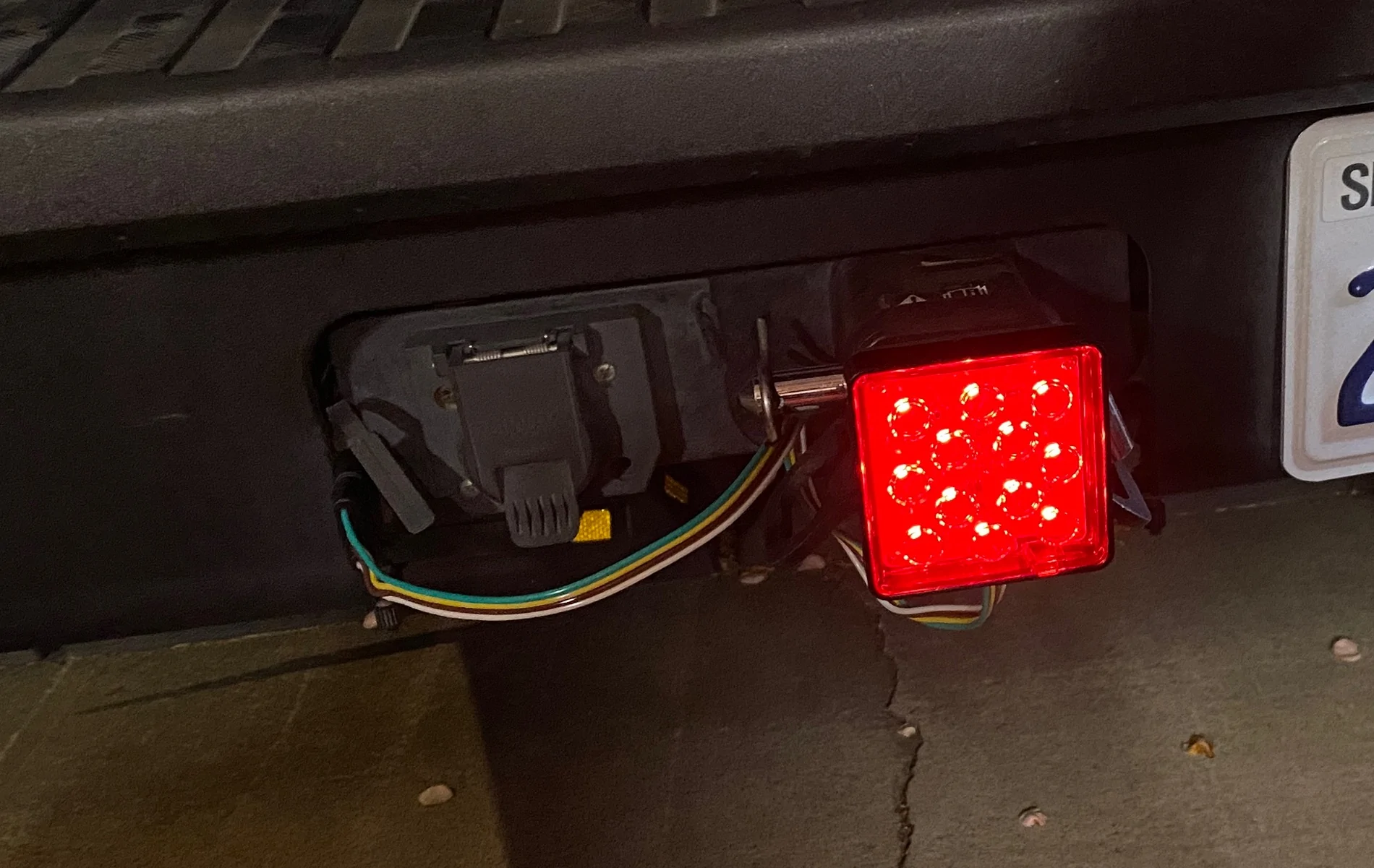

I tested this last part. From Amazon I ordered a $10 LED brake light for the 2" hitch receiver with 4-pin connector.
Wow! The LED brake light pulling no power when not braking, and only 4 or 5 watts when braking DOES TRIGGER 12 volt battery recharging to 100%.
It's not the electrical demand that triggers recharging. It is simply thinking a trailer is there that triggers recharging.
