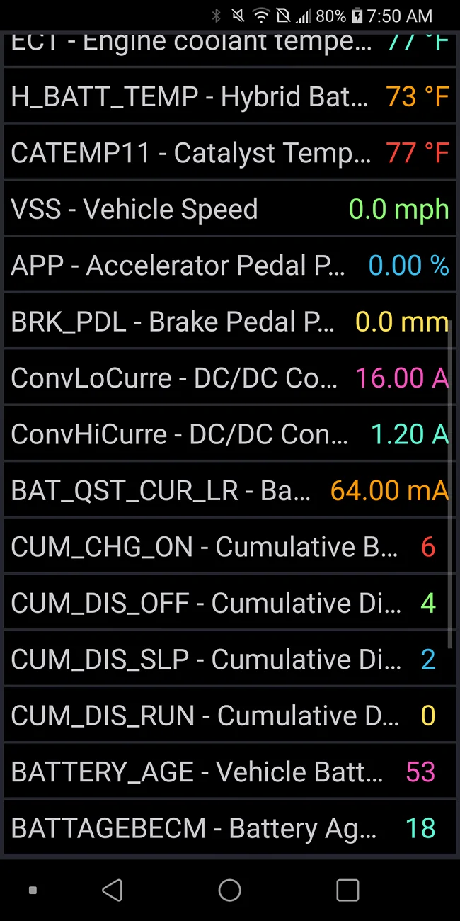

53 day old battery for me.
Started at normal full charge 12.75 V after a rest, and the matching Ford max SOC 85%.
Currently at 70% and 12.0 V in the mornings.
After a 20 min drive up to 75%.
But the BMS system thinks the cumulative charge Ah matches the discharge. Charge figure actually increases before the combined discharge figures do. (ok, due to rounding it does to whole number, that could be reversed in reality, but still not that fast of drain)
If that was true the battery would not be worse by now.
(yes - that sleeping mA current of 64 is higher than expected max 50, but it really doesn't matter)
